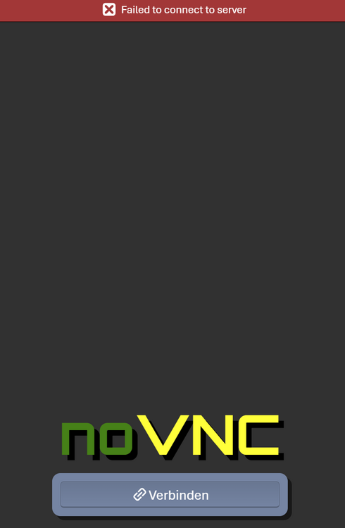

7 minutes ago, PinkCarlos said:
I want to use krusader with https. Which port should be entered in NPM and/or added to CA template?
By default the container doesn't provide a https port but if you are proxying it through NPM you should be able to use port 8080 internally and externally you have to configure NPM to fit your needs.
A word of caution, please note that if you set a password for noVNC that this is not enough and could be easily bruteforced, please make sure to put it behind some additional authentication like HTTP Basic Auth or even better some kind of authentication/authorization application like Authentik, Authelia,...
If I use IP and port 8080 in NPM the noVNC this screen is displayed.
