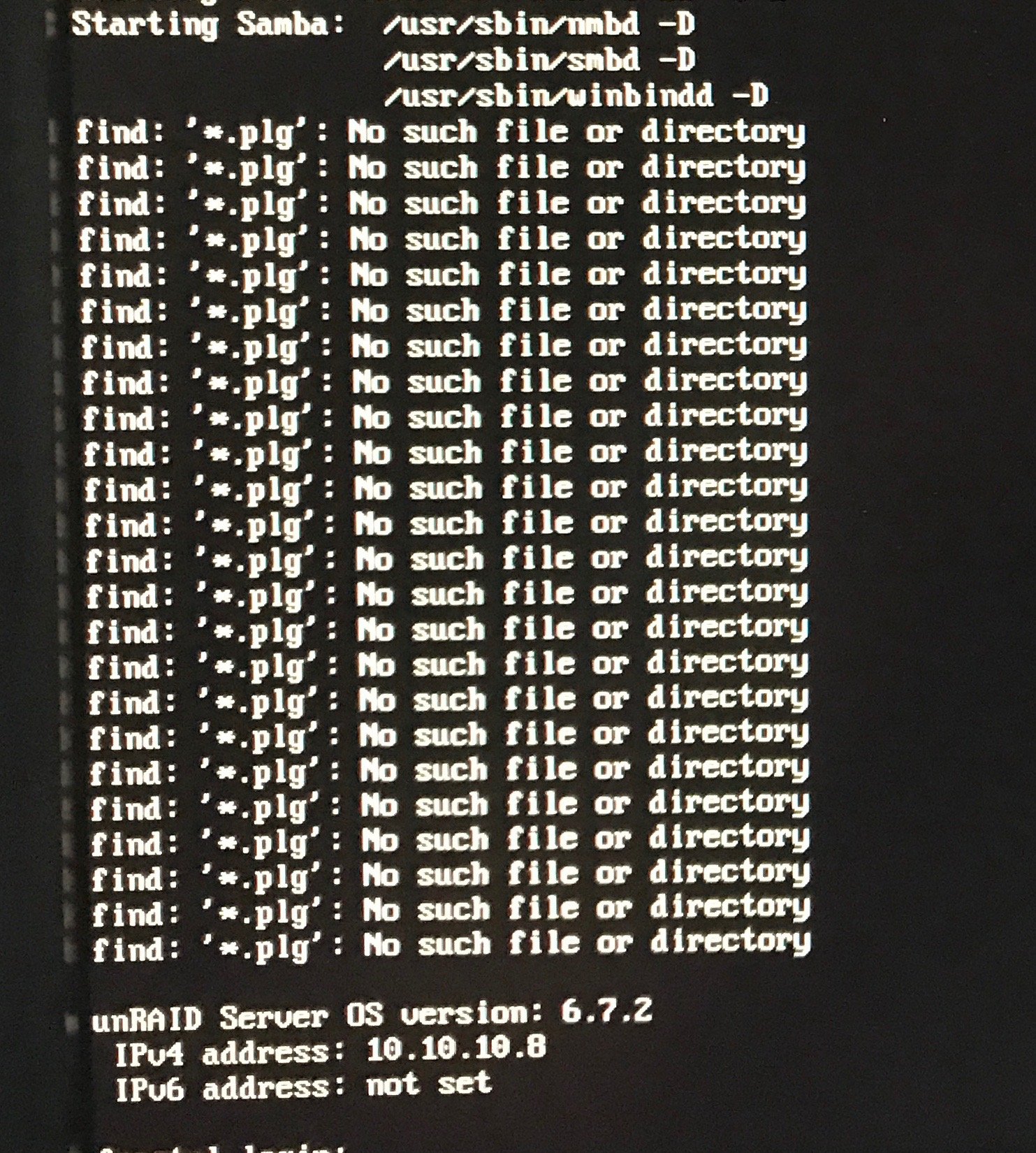

On the first reboot after testing the drive, I got the following errors:
Logged in and my config directory was empty. Yet, back in the Mac it had files!
So I copied the config directory back over from a backup and was able to boot - after assigning data drives.
