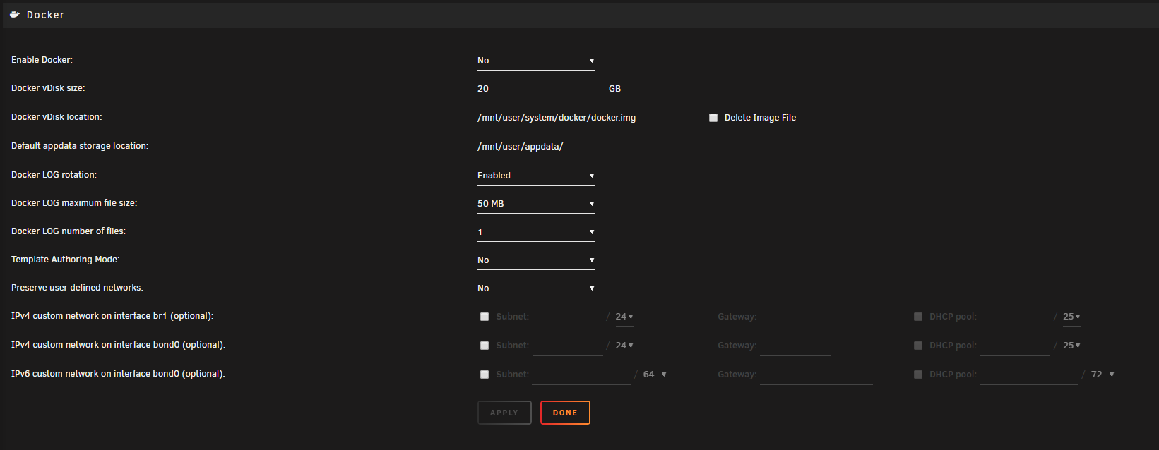

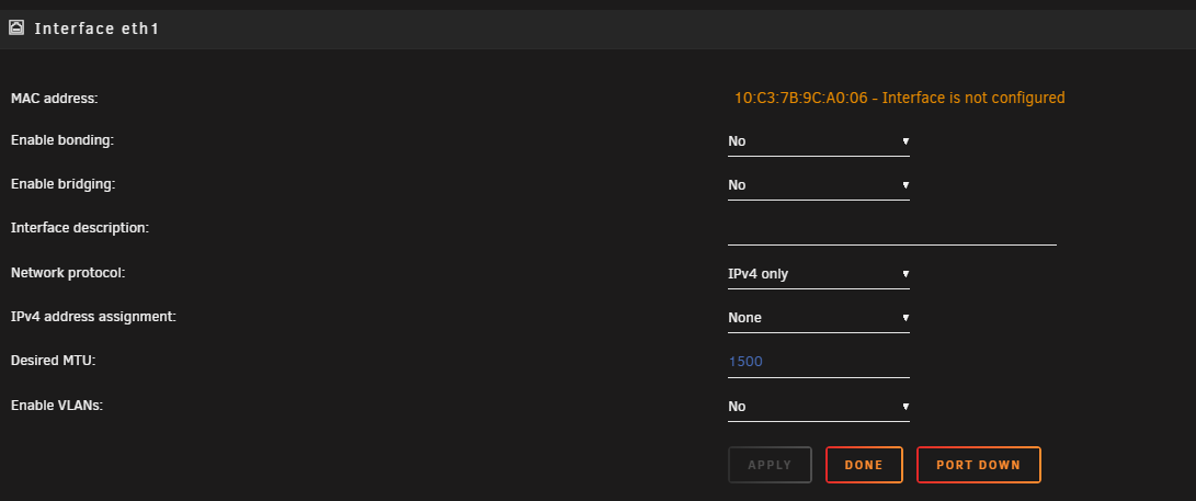

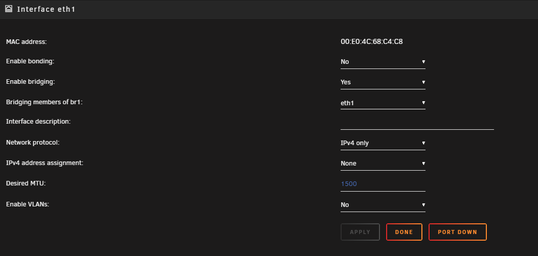

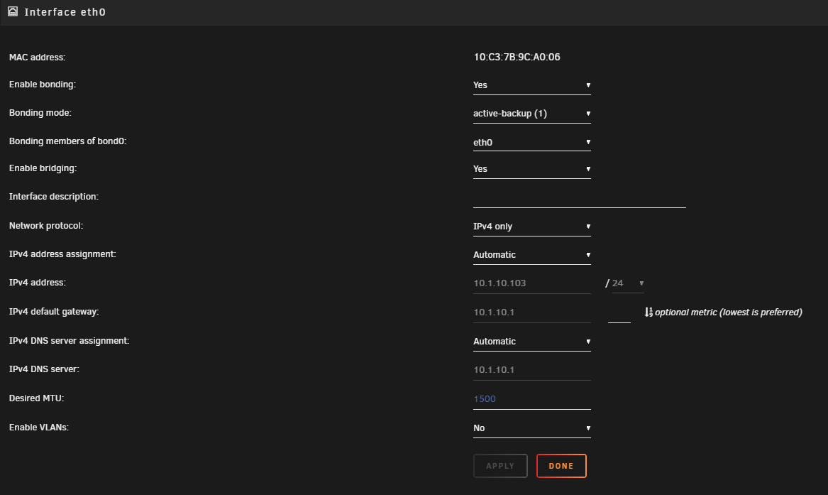

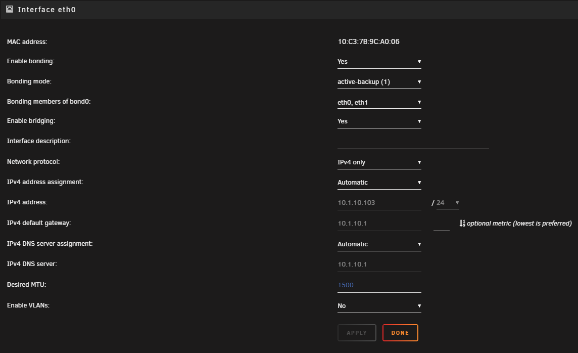

Post a screenshot of your network settings and docker settings (with docker service stopped)

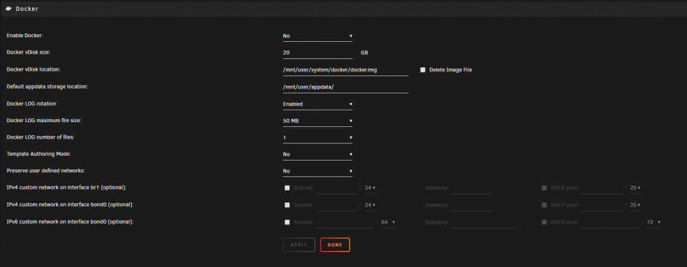

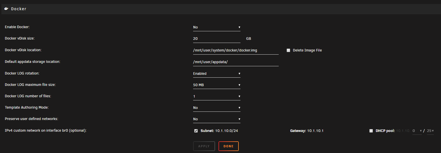

ok I did a reboot and now it shows up. Here are screenshots for you. I have removed the settings in Docker settings since it does not work, I am sure it has to do with the subnet.
Again thanks so much for your help.
I am a little confused...
When no IP assignments are set for interface br1 under docker settings, then this network is not available in Docker.
You should have something like this:
subnet = 10.1.10.0 /24
gateway = 10.1.10.233
dhcp pool = 10.1.10.128 /25 (this assumes the IP range .128 to .254 is not used by your router for DHCP assignments)

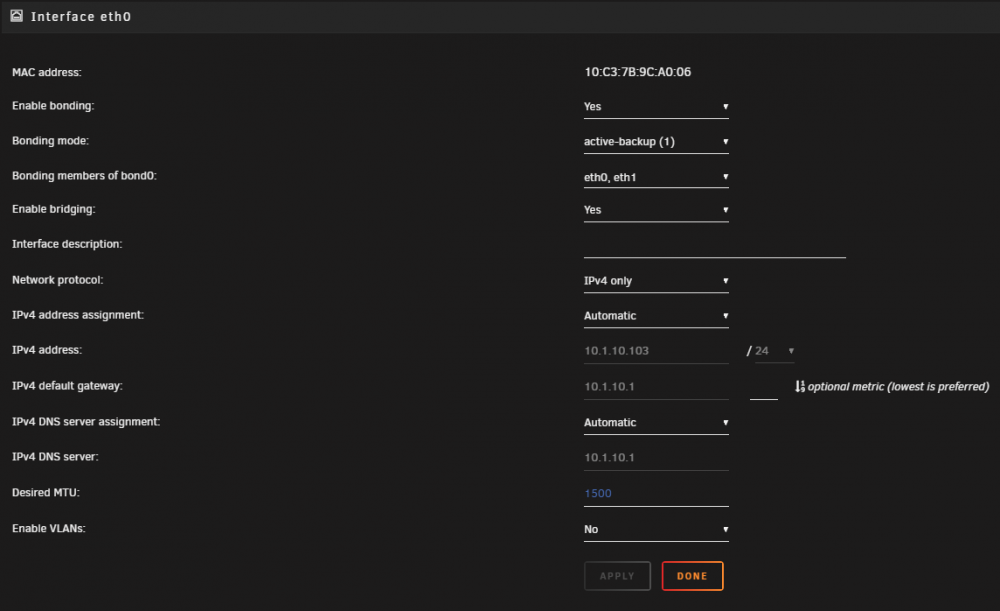

OK, I am now at a complete loss, nothing seems to be working correctly, I have even wiped everything and started over. Can someone help me out.
I am running a test environment so messing it up right now is not an issue.
My goal is to setup a vpn server so only particular containers use the VPN while the others bypass it. I followed a youtube video on how to set up a vpn using ubuntu server via vm, and I did get that working, but it seems like I need another nic to get the docker containers to work, so I added one, that's when everything broke. vpc no longer worked, ip addresses were all messed up and could no longer connect to the vpn server.
I figure to start from scratch and see if I could get the vpn setup again, but I cant get it to assign it an ip address from my router. (10.1.10.1) it keeps giving me a (192.168.1.xxx) address, so I cant access it from my network.
Sorry I have always been a windows guy and been using a qnap for years, but have out grown it.
how should I setup my first nic and vm so the vm gets ip address from router, then once I get my vm setup how do I configure my second nic to point it at my vm for the vpn service, and then how do I setup docker contains so some use the nic0 and other use nic1 all while getting ip from router so they are all on the same network. (Also plan on installing pi-hole later)
