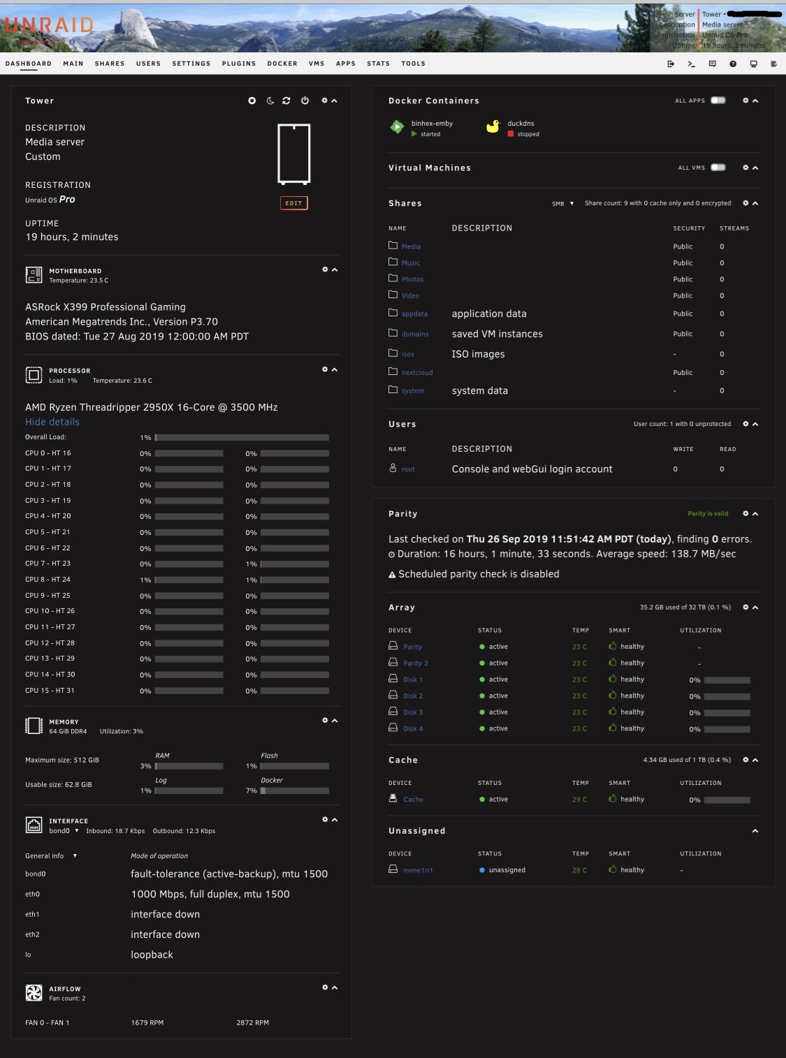

Hi everyone,
I've been using Unraid 6.7.2 for about a week now and I've noticed that the web GUI takes a substantially long time to load when I select the Apps or Plugins main menu headers. Another thing that I have noticed is that I cannot get "Fix Common Problems" to successfully complete a scan, as it never stops scanning (even after 30+ minutes).
  • Plugins: 2-3 min load time
  • Apps: ~30 sec load time
These times are consistent whether I am on the local network or accessing the GUI through my network VPN. Everything else on the web GUI loads instantly.
I'm connected to a gibabit ubituiti network via Cat 7 (USG->8 Port Switch-> Server), and my ISP subscription 1Gps up/down.
I'm not quite sure what to do to improve the load times. I haven't moved any files over to the server yet, as I want to get all dockers, VMs, etc installed and running smoothly before I do so (currently only have a few dockers and no VMs installed). I could do a full wipe and reinstall, but that seems like it would be like killing a fly with a sledgehammer.
Does anyone have any ideas as far as where to look for a guide on this issue or how to potentially solve the issue?
I've attached diagnostics reports for reference.
tower-diagnostics-20190926-1648.zip

Here is my hardware info and add ons/plug ins loaded:
Hardware
  • Motherboard:  ASRock - X399 Professional Gaming
    • BIOS Information
          Vendor: American Megatrends Inc.
          Version: P3.70
          Release Date: 08/27/2019
          Address: 0xF0000
          Runtime Size: 64 kB
          ROM Size: 16 MB
          Characteristics:
              PCI is supported
              BIOS is upgradeable
              BIOS shadowing is allowed
              Boot from CD is supported
              Selectable boot is supported
              BIOS ROM is socketed
              EDD is supported
              5.25"/1.2 MB floppy services are supported (int 13h)
              3.5"/720 kB floppy services are supported (int 13h)
              3.5"/2.88 MB floppy services are supported (int 13h)
              Print screen service is supported (int 5h)
              8042 keyboard services are supported (int 9h)
              Serial services are supported (int 14h)
              Printer services are supported (int 17h)
              ACPI is supported
              USB legacy is supported
              BIOS boot specification is supported
              Targeted content distribution is supported
              UEFI is supported
          BIOS Revision: 5.14
  • CPU: AMD RYZEN THREADRIPPER 2950X
  • GPU: MSI GT710 2GB D3 PCIE LP
  • PSU: CORSAIR 850W HXI 80+P FM ATX PSU
  • Memory: 4 x G.SKILL Ripjaws V Series 16GB 288-Pin DDR4 SDRAM DDR4 3200 (PC4 25600) Desktop Memory Model F4-3200C16D-32GVK
  • NVMe: 2 x INLAND 1TB I PREMIUM NVME SSD
  • HDDs: 8 x WD Red (Shucked from WD EasyStore: WD80EMAZ)
  • CPU Cooler: ENERMAX TR4 II 360 AIO CPU COOLER
Plugins
  • ca.backup2.plg - 2019.03.23
  • ca.cleanup.appdata.plg - 2019.09.15
  • ca.update.applications.plg - 2019.09.09
  • community.applications.plg - 2019.09.22
  • dynamix.active.streams.plg - 2019.01.03
  • dynamix.day.night.plg - 2018.08.03i
  • dynamix.s3.sleep.plg - 2018.02.04
  • dynamix.ssd.trim.plg - 2017.04.23a
  • dynamix.system.autofan.plg - 2017.10.15
  • dynamix.system.info.plg - 2017.11.18b
  • dynamix.system.stats.plg - 2019.01.31c
  • dynamix.system.temp.plg - 2019.01.12a
  • fix.common.problems.plg - 2019.09.23
  • NerdPack.plg - 2019.01.25
  • unassigned.devices.plg - 2019.09.14
  • unbalance.plg - v2019.09.07
  • unRAIDServer.plg - 6.7.2
Docker Containers
  • duckdns
  • binhex-emby
I've also attached the .txt file of the syslog rather than a PDF.
syslog.txt

@trurl Based on the thread, I disabled Global C States in my BIOS settings. I didn't notice any immediate changes, but I wasn't able to edit the \\tower\flash\config\go script, as I do not have any windows devices currently and flash only has SMB/Linux share.
What did make a difference was turning off the automatic update notifications for plugins. Performing this step dropped the wait time only down to about 3 seconds.
I also noticed a major issue on my Unraid network settings. For some reason I had listed the server's own IP as the IPv4 #1 DNS server and had 8.8.8.8 as the #2 DNS Server. I changed these settings to list 8.8.8.8 as the only DNS server and increased my MTU to 9000 (to match jumbo frames setting that's enabled on my network).
After making those network changes, Apps load instantly and fix common problems scans successfully.
I'm still seeing the same number of error information log entries on the NVME cache drive, but I'm not too sure what to do about that, outside of buying an SSD and moving the cache over to it.
tower-diagnostics-20190927-2035.zip
