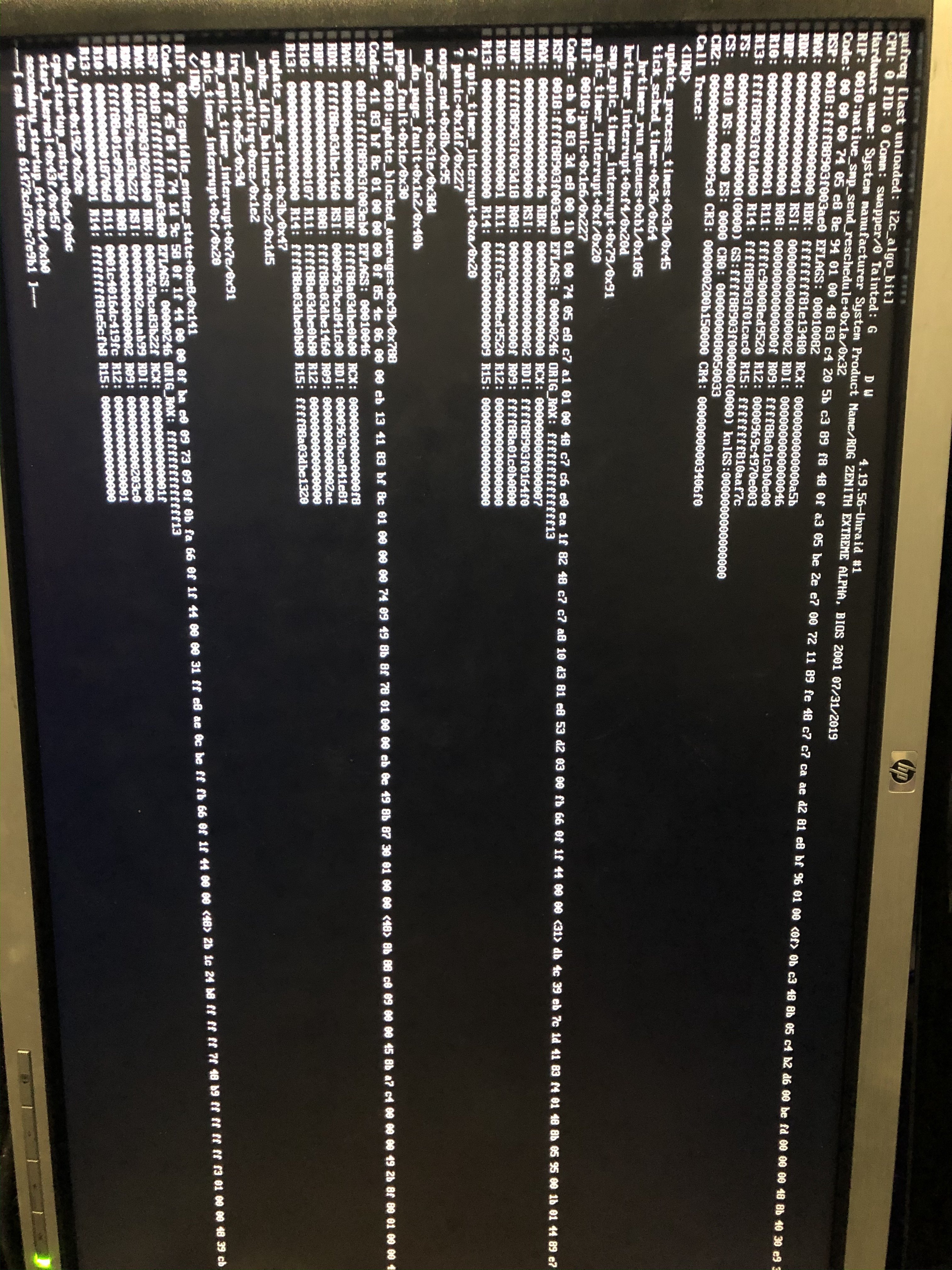

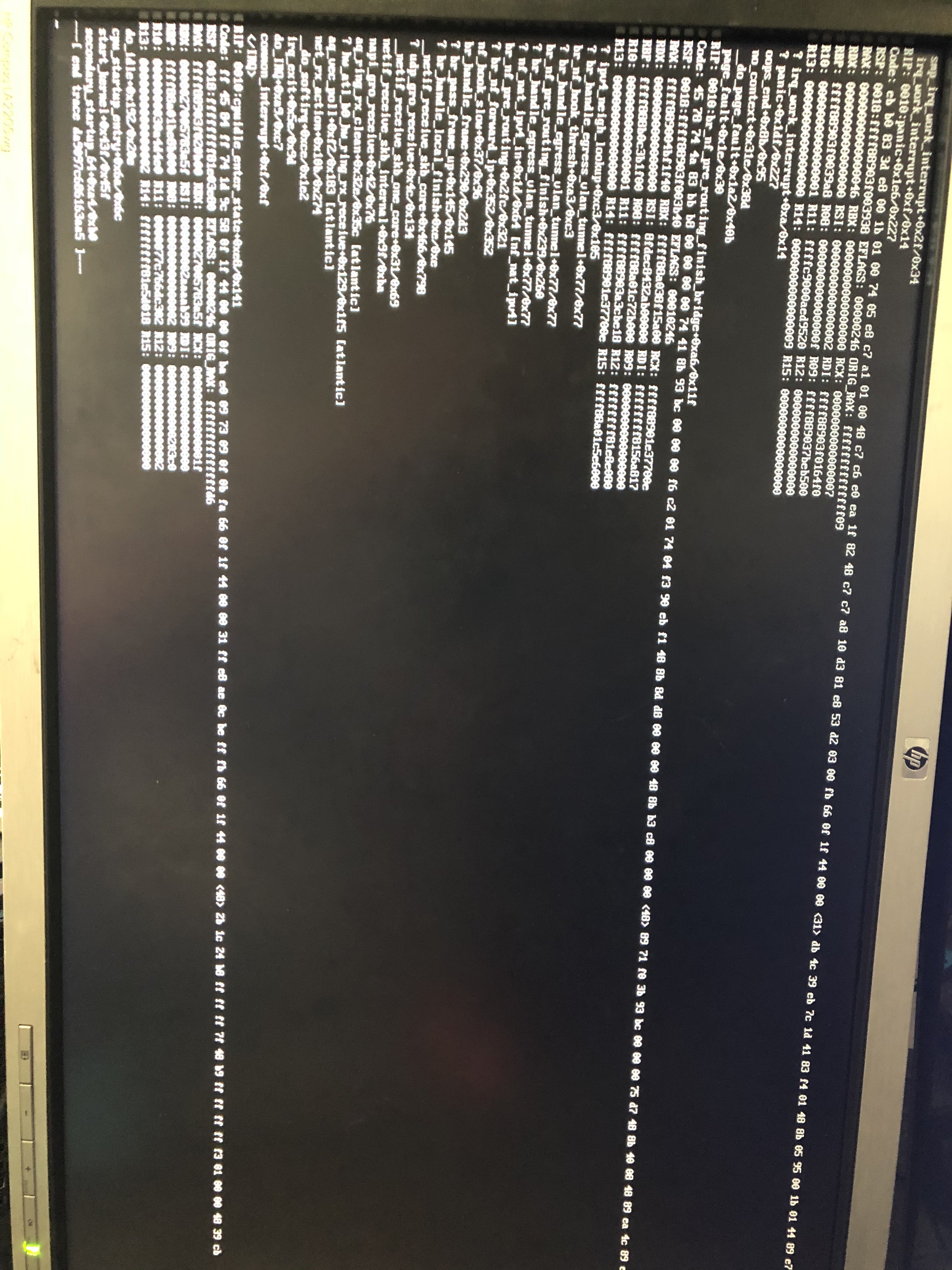

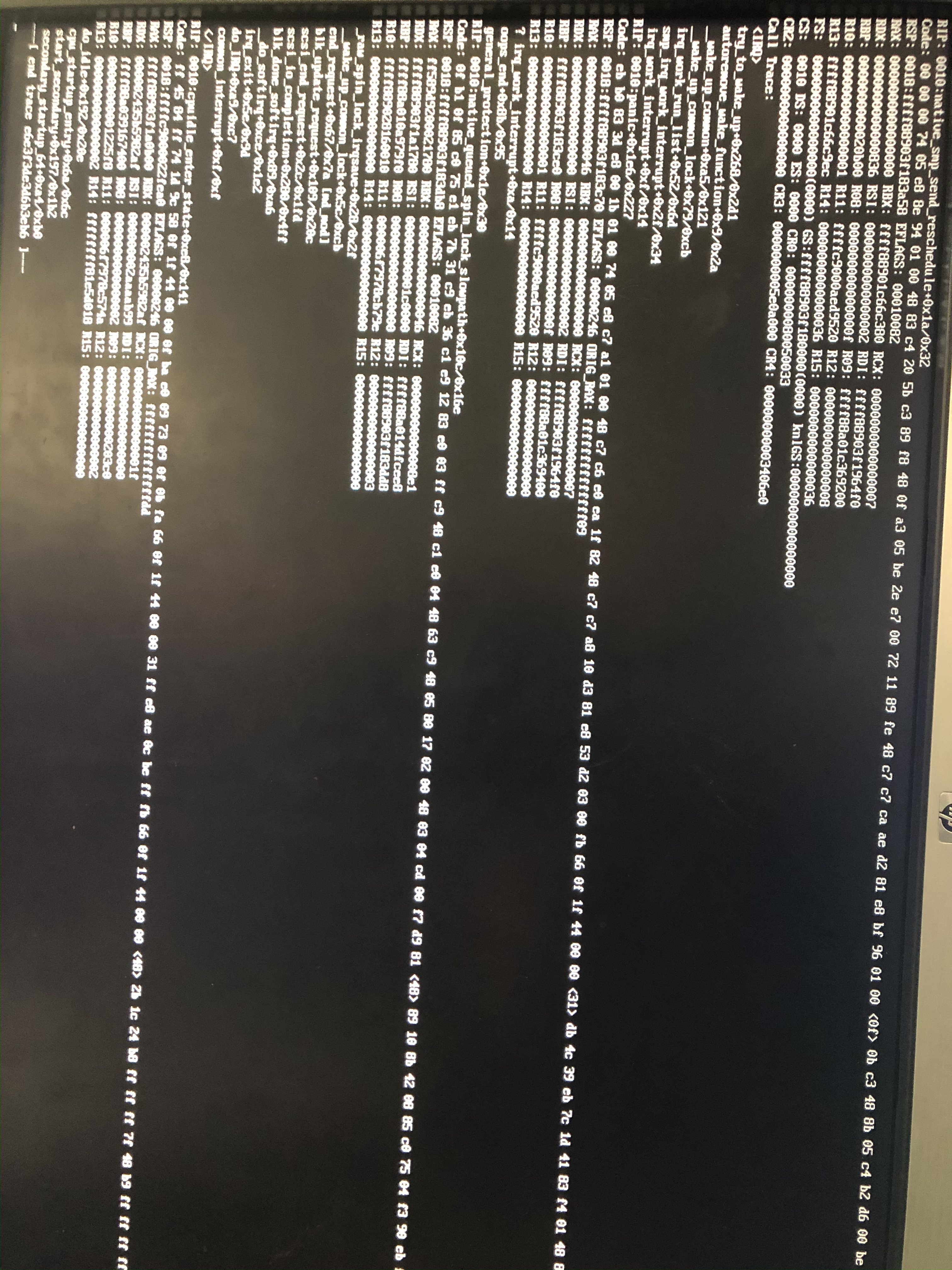

There are two syslogcopy files. The first (not '2') is the one that was running from the last reboot to this crash. The second file ('2') is from this recent reboot up until taking a copy to paste in here. I have 3 photos of my screen taken at unraid crash on 3 separate instances. I have also attached a diagnostic zip taken just after this most recent reboot. I am averaging a crash every two days now. I can barely complete one parity check before the next crash. I had one happen within a few hours of another. I cannot think of anything that would cause this. I have been stable for 2 months prior to this.

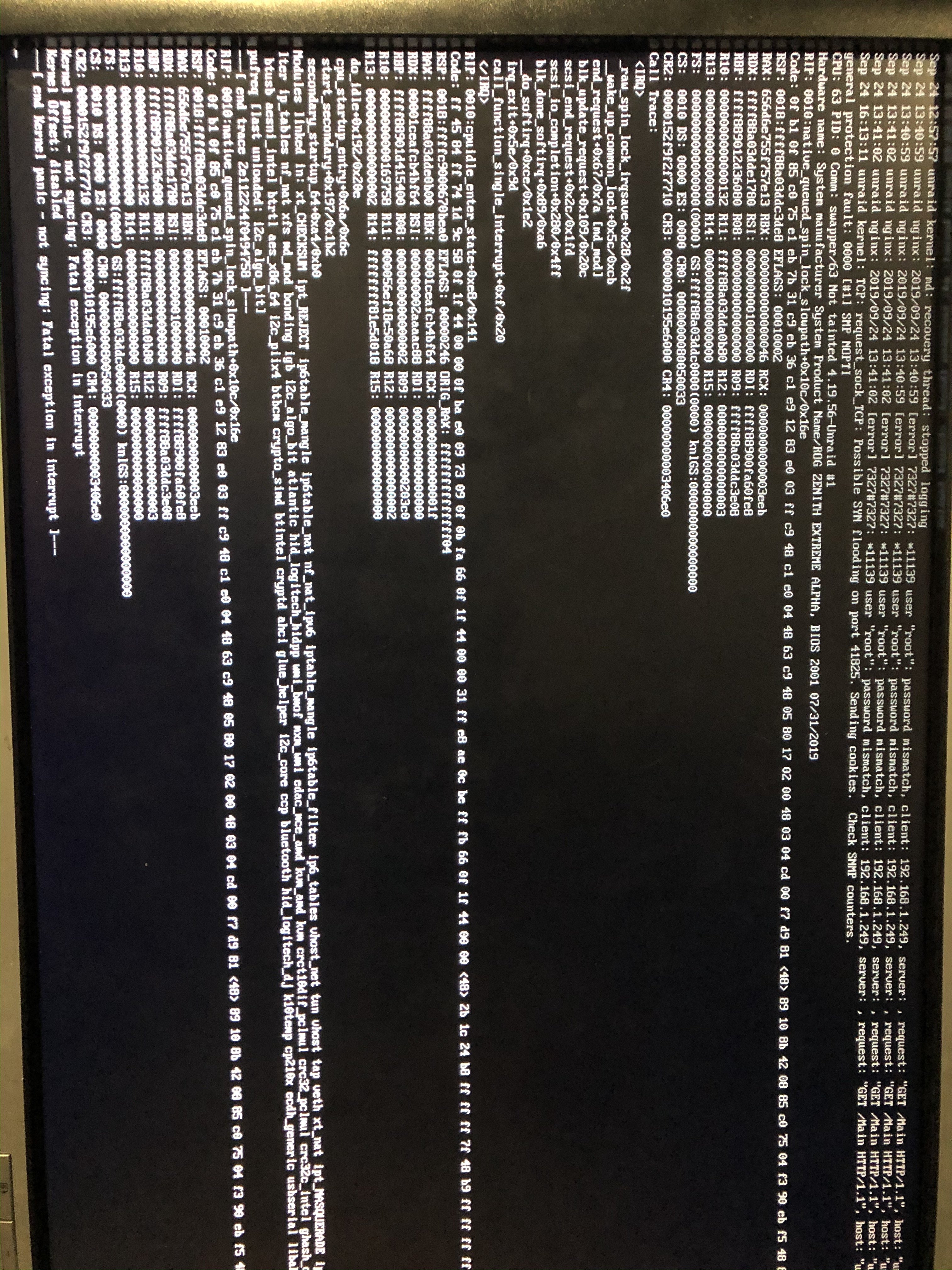

That was interesting. So I stopped my docker service and after shutting down my VMs that auto-boot, the VM service. I then went to network settings to check 2 and 3 above. It was already set to IPV4 only, so I tried to change the bonding to no. When I tried to hit save, my machine crashed again. I took a photo of my monitor and Ill attach it. I had to do a hard reset. After boot, I went back again to disable bonding. This time, when i tried to hit apply, I got an error stating that my flash drive was not mounted in R/W mode. This time I did a reboot from the Main page. Upon this boot I was able to apply the bonding setting. Then I rebooted and entered safe mode. I downloaded my diagnostics and I have attached the new file.

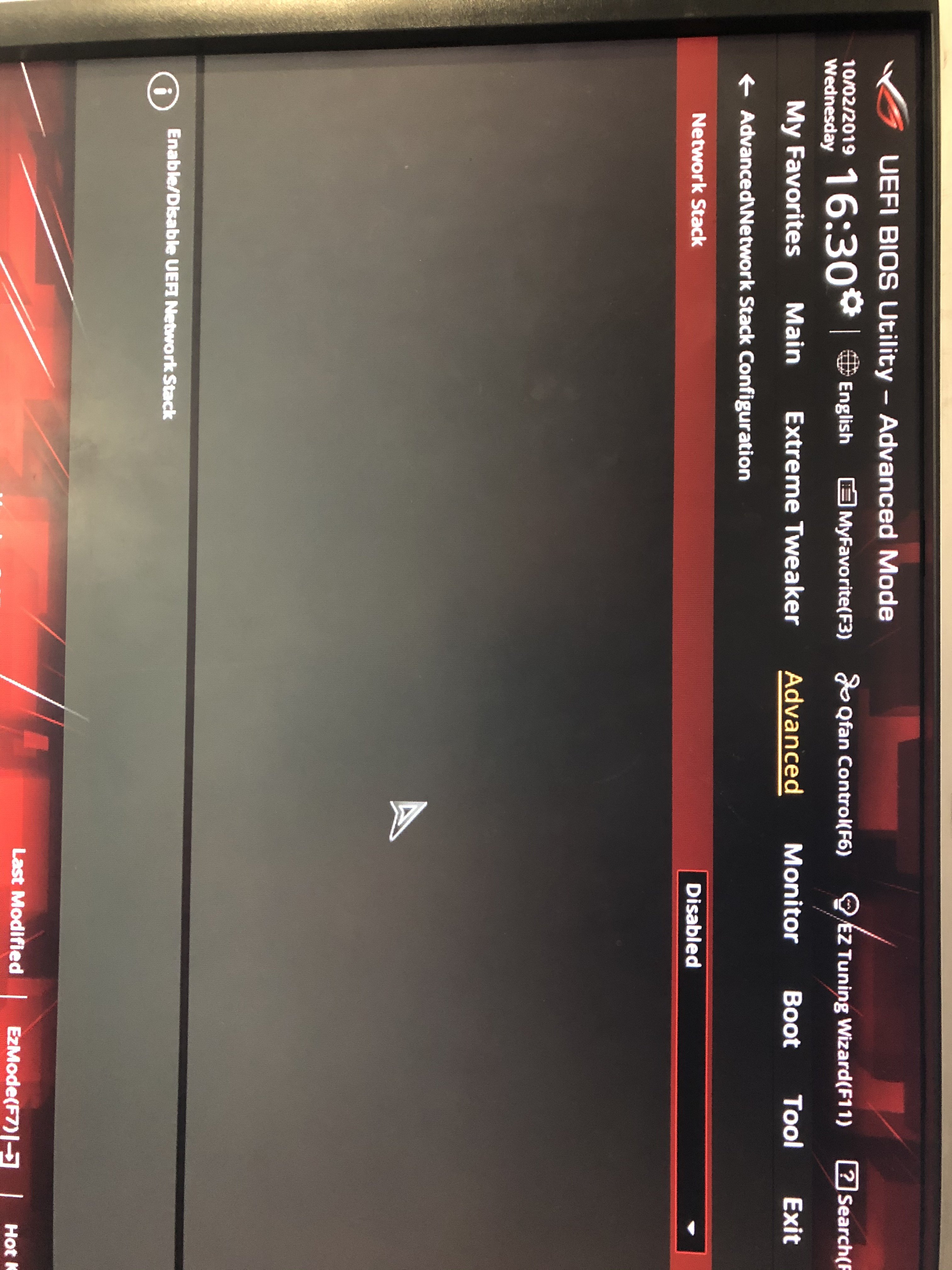

Check in your BIOS the setting for "Network Stack Configuration" and it is set to "disabled".
Although I was almost certain that I already had this set properly, I rebooted and went in to verify that the network stack was disabled in the BIOS. It is, and I attached a screenshot just to be thorough. I am now booted back into safe mode awaiting further instructions.

In several of your screenshots I see "page fault" errors, which may indicate something flaky with the memory.
Did you run memory tests?
