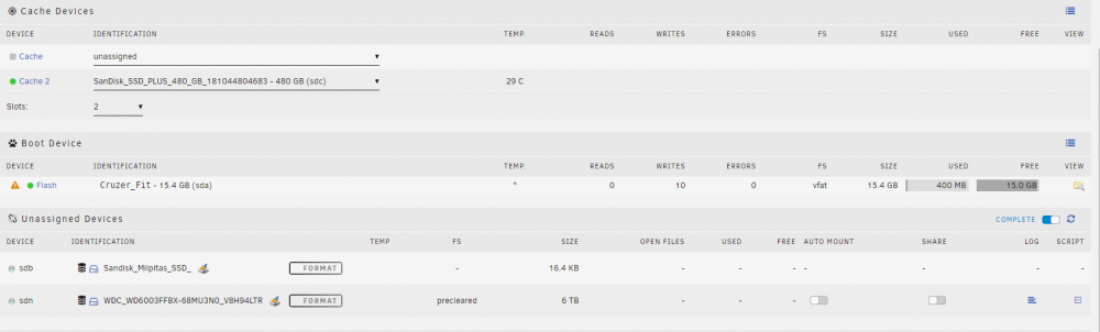

Ok that makes sense... but here is the problem now... after telling me yesterday that I need backup my cache pool and replace cables... I came home today and i wanted to check if the current cables are connected well and ok "just to make sure before I go ahead and replace them"
So I disconnected both SSD cache drive and connected them again... made sure that the other end of the cables are connected well to the motherboard... then started my unraid server to see if the problem went away or not... if not then the plan was to backup my cache pool and replace the cables...But, I came across this problem now which is... unraid took of one of the SSD cache drives and put it under unassigned devices and it says the size is 16 kb?!!
the other cache drive was still in its place and reflects the correct information in terms of size, temperature and even the name
Please have a look at the attached picture
That would suggest the SSD failed, try it on a different SATA port to confirm.

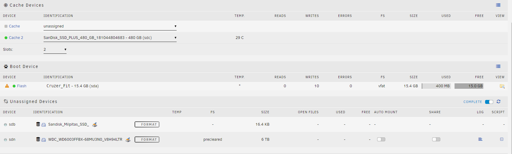

Yup... I just changed the SATA port is you suggested and it is still the same situation as shown in the picture above
What do I do now? I know that means the cache pool is no longer usable... but is there any way to get anything out of it!!
