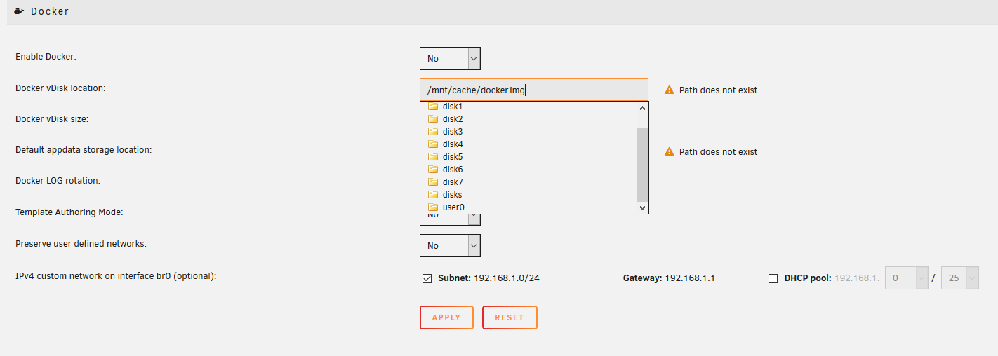

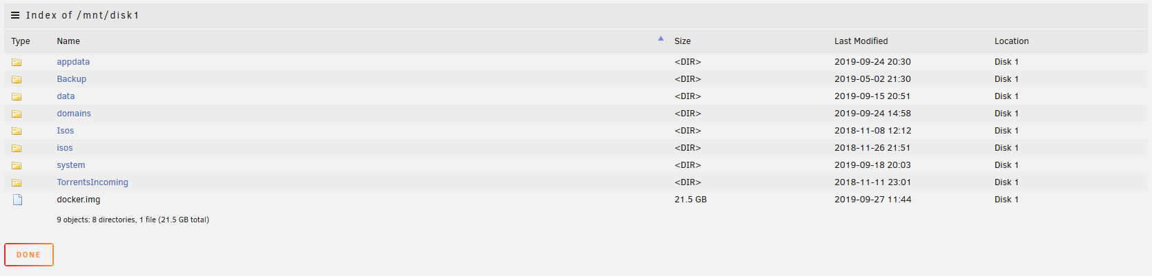

Side note, i found the system shares (pic attached) under /mnt/disk1/. Strange that they would be there now? Also, i now have a "/user0" dir for some reason (also pic attached)
What do you intend to do about those other disks I mentioned. Did you look at the Dashboard?
In order for Unraid to rebuild a failed or missing disk, it must be able to reliably read all bits of parity plus all bits of ALL remaining disks. You don't want to have untrustworthy disks in your server.
If you start docker or VM services without a cache drive, then those shares would wind up on the array, but you don't want them there.

How should I re-enable docker? And by that i mean remove any trace of it from the array, and have it re-enable with the proper paths available?
Settings - Docker, Disable then Delete. Enable will recreate, and since system share is cache-prefer, it will go on cache if cache is there.
Previous Apps on the Apps page will reinstall containers using their previous settings.
