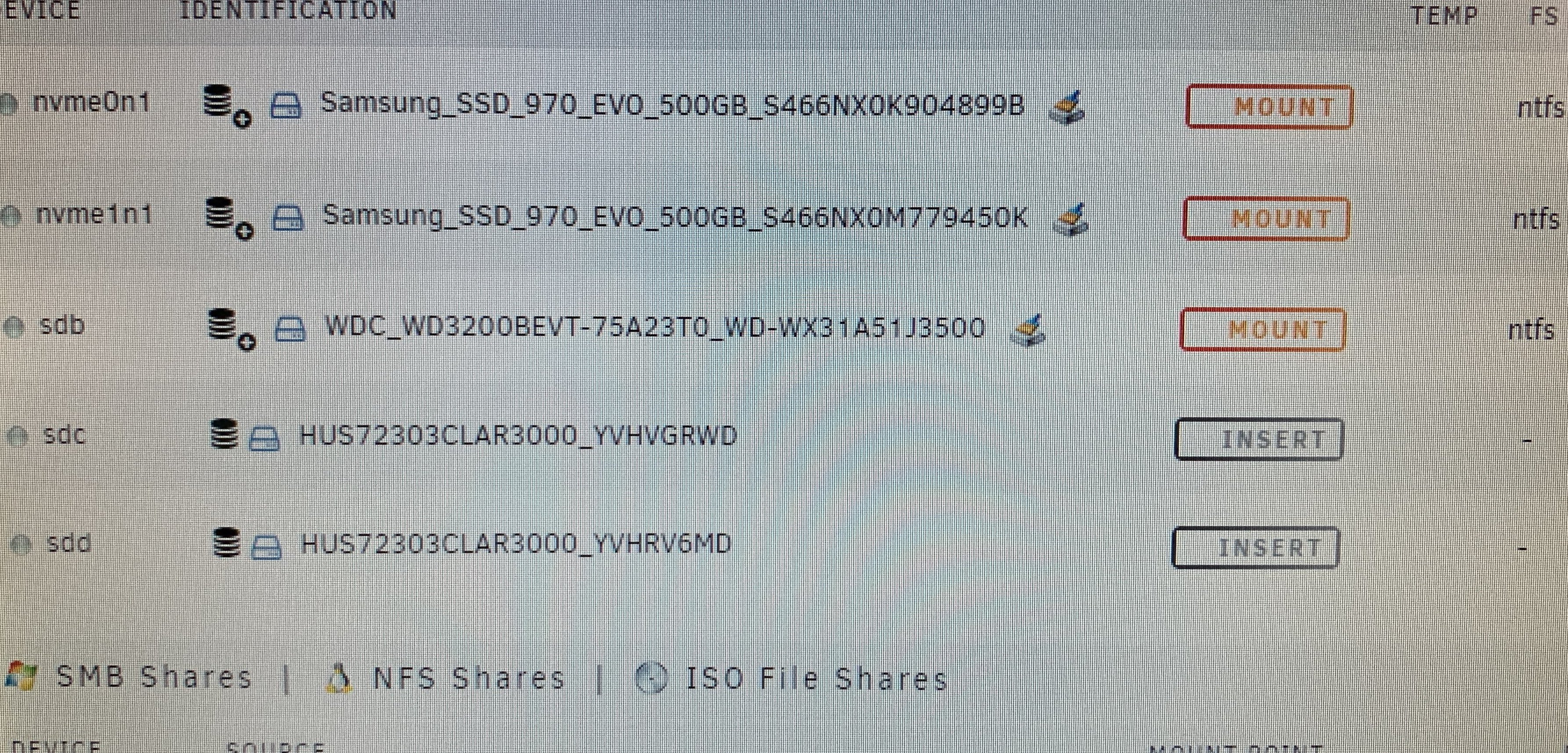

Got a new setup running with a Coraid case and Supermicro motherboard. Using 9201-16i HBA. It recognizes two cache drives and a random HDD I threw in but the HGST drives just show up with the option to Insert,  not mount. Any idea what could be going on?

Where is that settings menu? Also the drives will not show up in dropdown boxes so I can't do much with them right now.

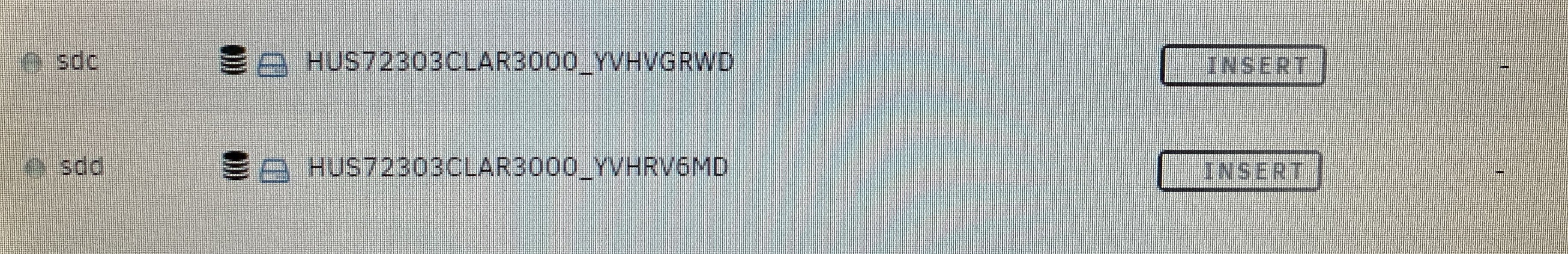

I'm an idiot. Found it and changed it, didn't help though, still un-mountable.
Please post the diagnostics: Tools -> Diagnostics trying to format one of them.
