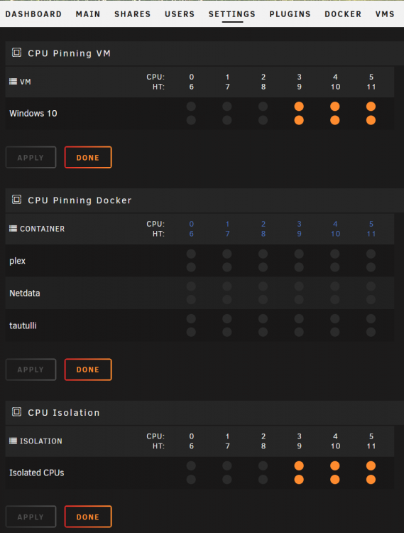

On 10/2/2019 at 8:59 AM, Taza said:
Might go 8gb for unraid, 8gb for plex and 16 for vm
My 2 cents on your build as I have almost exactly the same set up and have been running it for over a year.
You wont need to separate the ram between plex and unraid. If you have 32gb in your system and you assign 16gb to your windows VM, then unraid will just see the other 16gb as available and dynamically dish it out to the plex docker as it sees fit (assuming you will be running plex in a docker?).
I would advise cpu pinning, but again no need to pin plex as you may be opening yourself up to problems in the future. I have a 6 core i7 8700k and I pin 3 of the cores with their hyperthreading pairs to my windows vm, and just allow unraid to manage to the other 3 cores between itself and the other dockers including plex.
I went down the path of trying to pin plex to its own cpu cores with its own separated ram, however I found that sometimes the unraid os would need those resources more (for example in a parity rebuild) whereas other times plex would need the resources more (when transcoding/scanning/generating thumbnails etc). In the end it was easier to just let the os manage the docker resources and seperate off hardware for the VM only.
Transcoding plex through intel quicksync (onboard) whilst gaming on the separate gpu works really well, no problems there at all!

10 hours ago, Taza said:
So with pinning i have 8 cores and 16 threads (HT)
How do i set these. And if i get stuck can i msg you lol

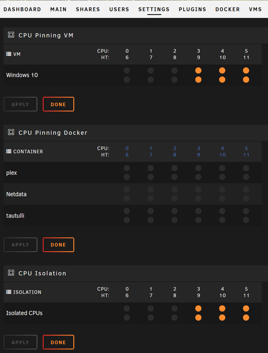

Unraid makes this easy. Just go into settings and there is an option for cpu pinning.
After you have created your vm you can choose which cores you want to pin it to, and then I would also recomend isolating the same cores. Isolating them alows only the pinned application to use the cores and stops unraid from using them at all. If you dont isolate them then unraid will use them for plex and other things slowing your windows vm down. Both options are on the cpu pinning settings page.
Leaving the dockers unpinned just leaves unraid to manage them as it normally would, using the unpinned cores and any available ram.
I have included a screenshot of my settings for clarity.
If you get stuck, check out the spaceinvader one videos. They are a great help for things like this and explain it better than I ever could:
