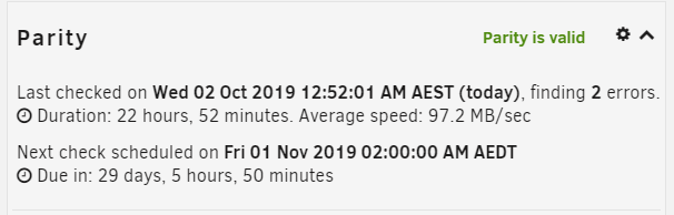

Hi there, as the title says, I have two separate consecutive parity checks that reported two errors each. I believe they may be the same errors.
1) Where do I find the errors and how do I correct this? I have appended the diagnostics.zip file for your analysis.

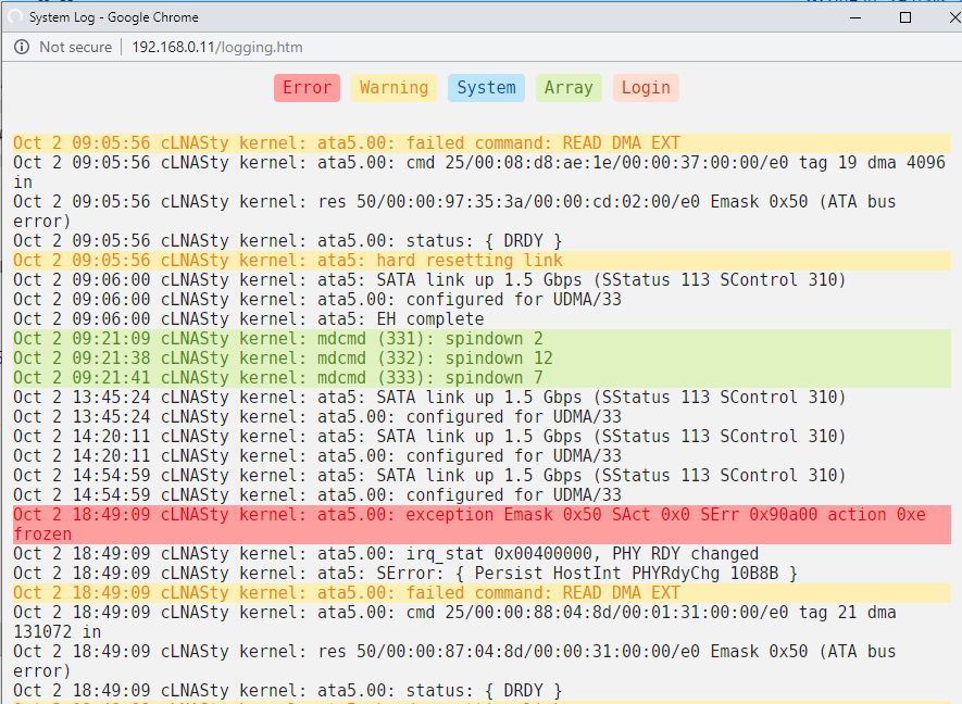

2) Separately, I get a log of errors relating to ata5: is this a SATA cable to Disk5?

I would replace the cable for Disk 5, Log shows it resetting many times.
Sep 28 13:32:27 cLNASty kernel: ata5.00: status: { DRDY }
Sep 28 13:32:27 cLNASty kernel: ata5: hard resetting link
Sep 28 13:32:31 cLNASty kernel: ata5: SATA link up 3.0 Gbps (SStatus 123 SControl 300)
Sep 28 13:32:31 cLNASty kernel: ata5.00: configured for UDMA/100
Sep 28 13:32:31 cLNASty kernel: ata5: EH complete
Sep 28 13:46:19 cLNASty kernel: ata5.00: exception Emask 0x50 SAct 0x0 SErr 0x90a02 action 0xe frozen
Sep 28 13:46:19 cLNASty kernel: ata5.00: irq_stat 0x00400000, PHY RDY changed
Sep 28 13:46:19 cLNASty kernel: ata5: SError: { RecovComm Persist HostInt PHYRdyChg 10B8B }
Sep 28 13:46:19 cLNASty kernel: ata5.00: failed command: READ DMA EXT
Sep 28 13:46:19 cLNASty kernel: ata5.00: cmd 25/00:00:80:9c:db/00:04:10:00:00/e0 tag 10 dma 524288 in
Sep 28 13:46:19 cLNASty kernel:         res 50/00:00:7f:9c:db/00:00:10:00:00/e0 Emask 0x50 (ATA bus error)
