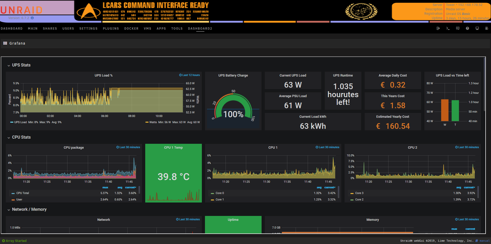

October 4, 20197 yr Author On 10/3/2019 at 2:08 AM, Squid said: Custom Tab plugin. I Had to change the "X-Frame-Options=sameorigin" option in grafana from false to true. And I had to activate the kiosk mode "google for grafana on tv" After that Custom Tab works fine. In "Management Access" you can choose that your own Dashboard is shown after Login. Perfect thanks I added a screenshot. Edited October 4, 20197 yr by TaiChar

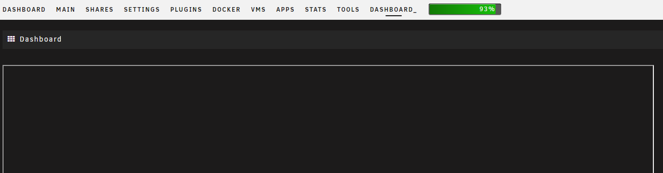

October 17, 20197 yr Author 35 minutes ago, MMW said: Thanks, I have made the changes for "allow_embedding = true" but this still does not allow me to put it in a custom tab. I can see in Grafana that the change is active, any other suggestions? Does the custom tab show nothing or the Grafana login?
October 17, 20197 yr 20 minutes ago, MMW said: A Lovely empty screen, totally blank. The default webUI for grafana is http. A browser enforced security provision is that if you access your server via https, then you cannot have an iframe of http. Whether or not you can access grafana via https is a different story. I don't know

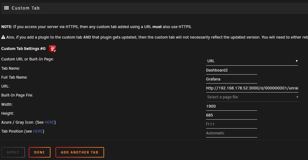

October 18, 20197 yr Author 12 hours ago, MMW said: Makes sense and leads to a wonderful headache @TaiCharhow did you manage to get past this? You mention X-Frame-Options=sameorigin in one of your post but I am unable to find this in the Grafana config file. yes, by setting "allow_embedding = true" this won't be send anymore. was the ";" deleted at the beginning of the line? Is the custom tab setting correct? see screenshot? I edited three lines in the grafana.ini the one mentioned for embedding and two for the kiosk mode of grafana. [auth.anonymous] enabled = true org_name = Main but this is only to see the dashboard without logging in. If not set you should see the login screen.
October 18, 20197 yr Hi, This is the relevant line from the Grafana.ini And my Custom tab matches yours apart from the Tab Name and Width and Height (which i tried copying just to be on the safe side). Just very odd. I take it that you are running via SSL for the UNRAID box itself?
