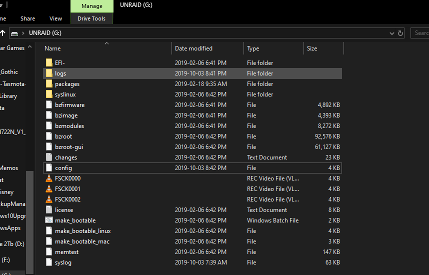

I couldn't find a folder on the usb drive with the name 'config'. There was a file with that name tho it looks corrupted.  Is there suposed to be a folder there with configuration files?

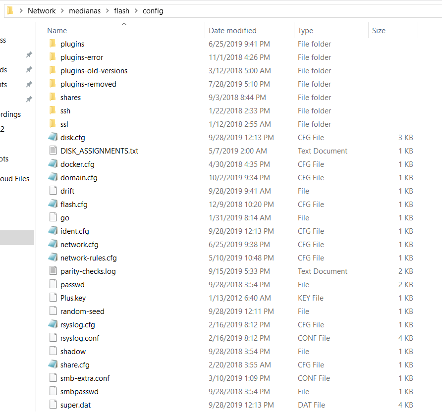

Yes, you should have a config folder on your flash drive that looks something like this (I have some stuff I need to cleanup):
