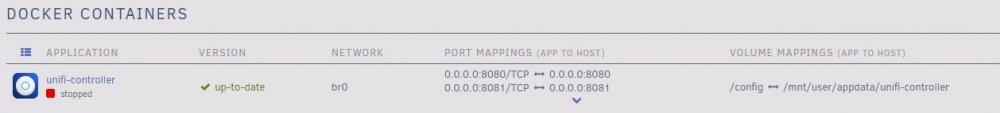

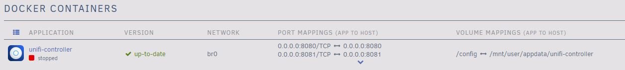

can s.o. gimme a hint...just installed my unraid setup freshly and i stuck with the basic installation of docker / network settings. under network settings i added vlan 20 and enabled briding, after i start docker environment i install a docker container, everything runs fine. after a reboot, the docker does not start, with the error "no such container", when i stop docker environment and start it again the container comes up...anyone have a clou?

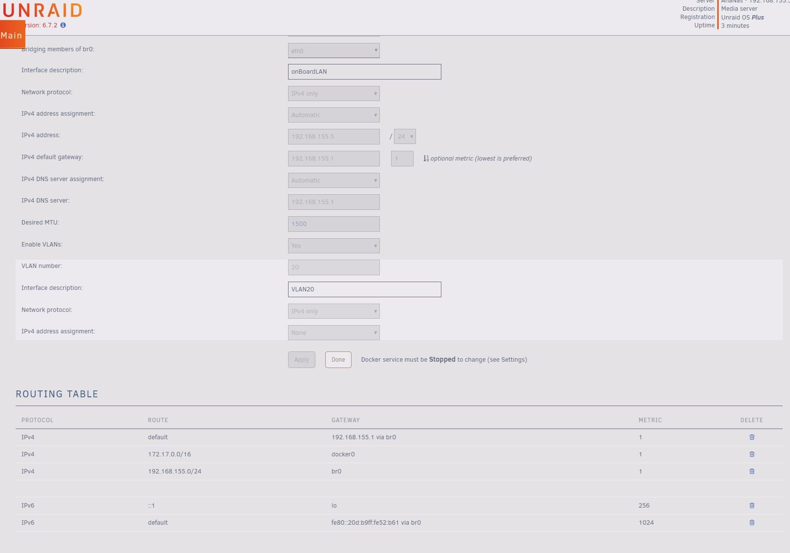

here are my network settings
before reboot i had route
192.168.150.0/24 br0.20 this is gone after reboot
and the docker0 is new...
this shows up after a reboot
when i now stop docker environment and start docker environment, everything works...till i reboot again???
You need to define the network settings for br0.20 under the Docker settings.
Stop the Docker service and choose advanced mode to make network assignments.
