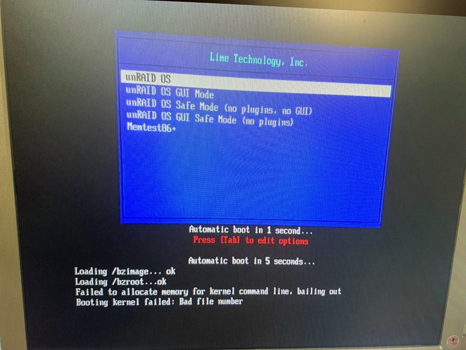

Howdy folks! Pleasure to be on the forum...Although, I'm in need of a little help. So, I tried for about 3 hours last night to install unraid on one of my servers and was unsuccessful. I did make a lot of drastic changes last night to my system so I'm curious if I potentially missed something. Little history...Machine is a Dell R720XD LFF with dual Xeon E5-2680 v2 processors 256GB memory 12 x 3.5" 3TB SAS and 2 2.5" SAS in the flex bay. Raid card WAS an H710 mini and I ordered and swapped it last night with the passthrough H310 mini. I went in the config and cleared the current raid config and switched ALL the drives to non-raid. Previous to the swap, I transferred all the data from the 12 front drives that were running in RAID 6 on the H710 to another network attached storage, but I left the two rear drives data intact but cleared the RAID 1 config they were in. I also went into the system config and made the internal USB the first and prioritized boot device in the UEFI boot manager. I ran the unraid USB creator tool, customized, correct network info, UEFI bootable, ran the make_bootable as administrator and I get nothing but an install that won't start or initialize. This machine will install and boot ESXi no problem on the internal USB port. I am getting the following attached error, see picture. I have tried 2 different thumb drives, both of them are identical in make and model 16GB imation nano. I will try a different brand but I'm just not sure what to order on Amazon. Any help would be greatly appreciated as I really want to see what this unraid is all about...TIA

Are you booting from a USB2 port?
I am booting from the same port on the board that I was able to successfully boot ESXi from. It's internal, right on the board in front of the flex bay backplane. I'm going to try a different brand USB drive tonight. The imation nano's I used were identical and they did have a unique serial number attached to them, which unraid says is a prerequisite.

The reason I asked is because many people have problems booting or maintaining a connection to the flash drive in a USB3 port. So what is the answer?
It's a 2.0 port
Which makes me think of another question...Once I get it up and running, assuming I figure this out, should I swap out the rear 147GB SAS drives for 480GB SSD's or would there be no performance benefits there? Also, my apologies @trurl, somehow my eyes glazed right over the "2" after you asked if it was a USB2 port.

Tried 3 different USB flash drives of multiple manufacturers and even different USB ports like the ones on the front and the back, not the problem. I'm thinking it has to have something to do with my servers config that I haven't figured out. I must have missed something in the settings. Hate to say it, but after 2 nights of this I'm about to throw in the towel...
Could it be because I have zero vitrual disks setup, only physical?

Negative, I am trying to run it on a machine that all the drive data has been wiped from. I just don't know anything about any of this so I'm just spitballing. I did just figure out a setting I missed so we are about to see if legacy mode was the answer this whole time...shortly
Edited by rocky_mtn
Holy effing holy! Boy, sure would be cool if this was in the documentation...legacy mode works, UEFI is NOT compatible with this particular Dell server...4 years old.
