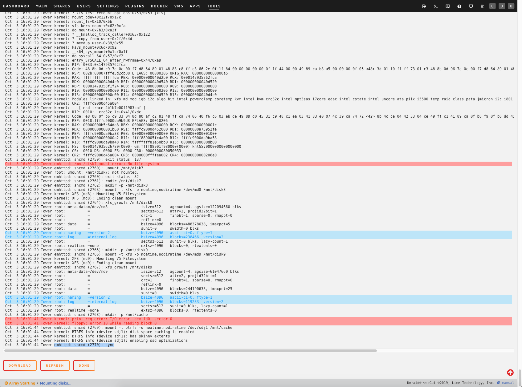

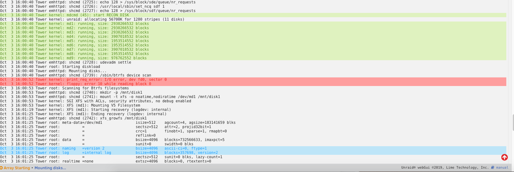

I had my Disk 7 fail I replaced it and upon attempting to bring the array back online it appears to freeze. It's been sitting for over an hour and the system log hasn't logged anything new in about the hour as well

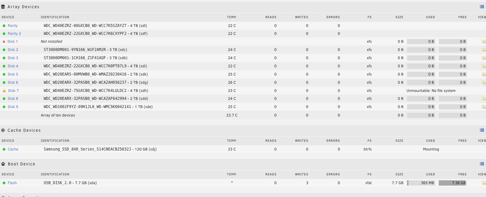

I'm still at the same placeimage.thumb.png.fdc7ef90e00d696a21f105cfef740450.png
Edited by flip
Where is disk 1?
I have no idea why it isn't there honestly there's a drive in there.
Would that be causing the problem?
With dual parity, you can have 2 disks down at the same time no problems.  However I suspect the issue is because disk 7 is unmountable.  You should post your diagnostics
Check filesystem on disk7, you need to remove or replace disk1 or will be unprotected if another disk fails.

I go to start the array it still claims disk 7 unmountable no file system and hangs on mounting cache drive
