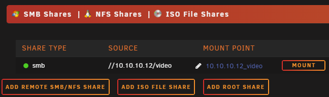

August 21, 20224 yr Hello, I have exactly the same problem as MacDingo had. My system: Unraid: 6.10.3 Synology NAS: DS215j When I add the share with SMB, then I can create it successfully. But when I click on Mount, the ICON rotates for a moment and nothing happens after that. I created an extra account on the NAS for this as MacDingo wrote. I have not shared a port -> Do I need to share a port? Does anyone have an idea?

August 21, 20224 yr When you tried to mount a share with SMB, there was a credentials issue: Aug 21 13:36:54 Alent unassigned.devices: Mounting Remote Share '//NAS/video'... Aug 21 13:36:54 Alent unassigned.devices: Mount SMB share '//NAS/video' using SMB default protocol. Aug 21 13:36:54 Alent unassigned.devices: Mount SMB command: /sbin/mount -t 'cifs' -o rw,noserverino,nounix,iocharset=utf8,file_mode=0777,dir_mode=0777,uid=99,gid=100,credentials='/tmp/unassigned.devices/credentials_video' '//NAS/video' '/mnt/remotes/NAS_video' Aug 21 13:36:54 Alent kernel: CIFS: Attempting to mount \\NAS\video Aug 21 13:36:54 Alent kernel: CIFS: Status code returned 0xc000006d STATUS_LOGON_FAILURE Aug 21 13:36:54 Alent kernel: CIFS: VFS: \\NAS Send error in SessSetup = -13 Aug 21 13:36:54 Alent kernel: CIFS: VFS: cifs_mount failed w/return code = -13 Avoid special characters in names and passwords. Letters and numbers only are the best. When you tried to mount a share with NFS, the remote server mount was denied: Aug 21 13:41:55 Alent unassigned.devices: Mounting Remote Share '10.10.10.10:/volume1/video'... Aug 21 13:41:55 Alent unassigned.devices: Mount NFS command: /sbin/mount -t 'nfs' -o rw,noacl '10.10.10.10:/volume1/video' '/mnt/remotes/10.10.10.10_video' Aug 21 13:41:55 Alent rpc.mountd[24794]: refused mount request from 10.10.10.10 for /volume1/video (/): not exported Aug 21 13:41:55 Alent unassigned.devices: NFS mount failed: 'mount.nfs: access denied by server while mounting 10.10.10.10:/volume1/video '. You need to look into the NFS requitements of the remote server. You were mounting it with NFSv3 on Unraid. The remote server may want NFSv4. You can set UD to mount NFSv4 in the UD Settings. Check that /volume1/video/ is a valid share folder. You also ran into an issue trying to rename a mount point to "NFS-Share": Aug 21 13:31:36 Alent unassigned.devices: Error: Device '10.10.10.10:/volume1/video' mount point 'NFS-Share' - name is reserved, used in the array or by an unassigned device. You can't have two share/mountpoint names the same.
August 21, 20224 yr 1 hour ago, dlandon said: Avoid special characters in names and passwords. Letters and numbers only are the best. I use a password manager that generated a 100 characters long PW with many special characters. I tried to change my password to a 40 characters long one with only small, capitalized and numbers and it still dosn't work. (Also tested it with a 20 characters PW) What are the restrictions from SMB protocol side (if any) to choose a password. The username for login in m a Synology NAS is capitalized. Does this affect the login in any way? Edited August 21, 20224 yr by AceBurn90
August 21, 20224 yr It's not a SMB issue with the characters it's the use of php by UD. php reserved characters cause a problem. How do you know it's a credentials problem? Did you see the same login failure in the syslog? Try setting the "Specify SMB Version when Mounting Remote Shares?" to "Yes" in the UD settings. UD defaults to not specifying the SMB version to let the server set the protocol it prefers. This doesn't always work, and the remote server may want the SMB version specified. On your next post, please attach the diagnostics file. Just telling me it "Doesn't work", is not very helpful unless I can see in the diagnostics why it "Doesn't work".
August 23, 20224 yr On 8/22/2022 at 12:15 AM, dlandon said: It's not a SMB issue with the characters it's the use of php by UD. php reserved characters cause a problem. How do you know it's a credentials problem? Did you see the same login failure in the syslog? Try setting the "Specify SMB Version when Mounting Remote Shares?" to "Yes" in the UD settings. UD defaults to not specifying the SMB version to let the server set the protocol it prefers. This doesn't always work, and the remote server may want the SMB version specified. On your next post, please attach the diagnostics file. Just telling me it "Doesn't work", is not very helpful unless I can see in the diagnostics why it "Doesn't work". Hey dlandon, thanks for your help. It was the authentication after all. I checked again in my Synology NAS and found that in the extended share, access rights must also be assigned for the folder. I thought that I had already done this. Possibly I have reset this in the past.... Sorry for this inconvenience and thanks again for your efforts. For all of you who also have this problem. 1. Check that you give the correct permissions to the user in "Users and Groups" -> "Users". 2. If you assign the permissions via groups, you should also check in the "Groups" tab, if the group has the necessary permissions. 3. Also check that under "Shared folders" -> "The folder you want to share" -> "Permissions", also has the appropriate permissions.
