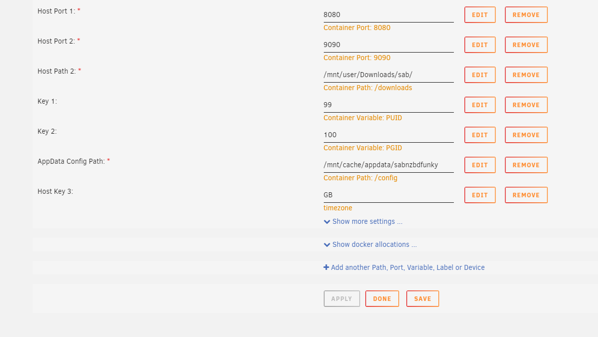

I am so sorry if this is something that has been asked before but I have spent about 5 hours on this now..

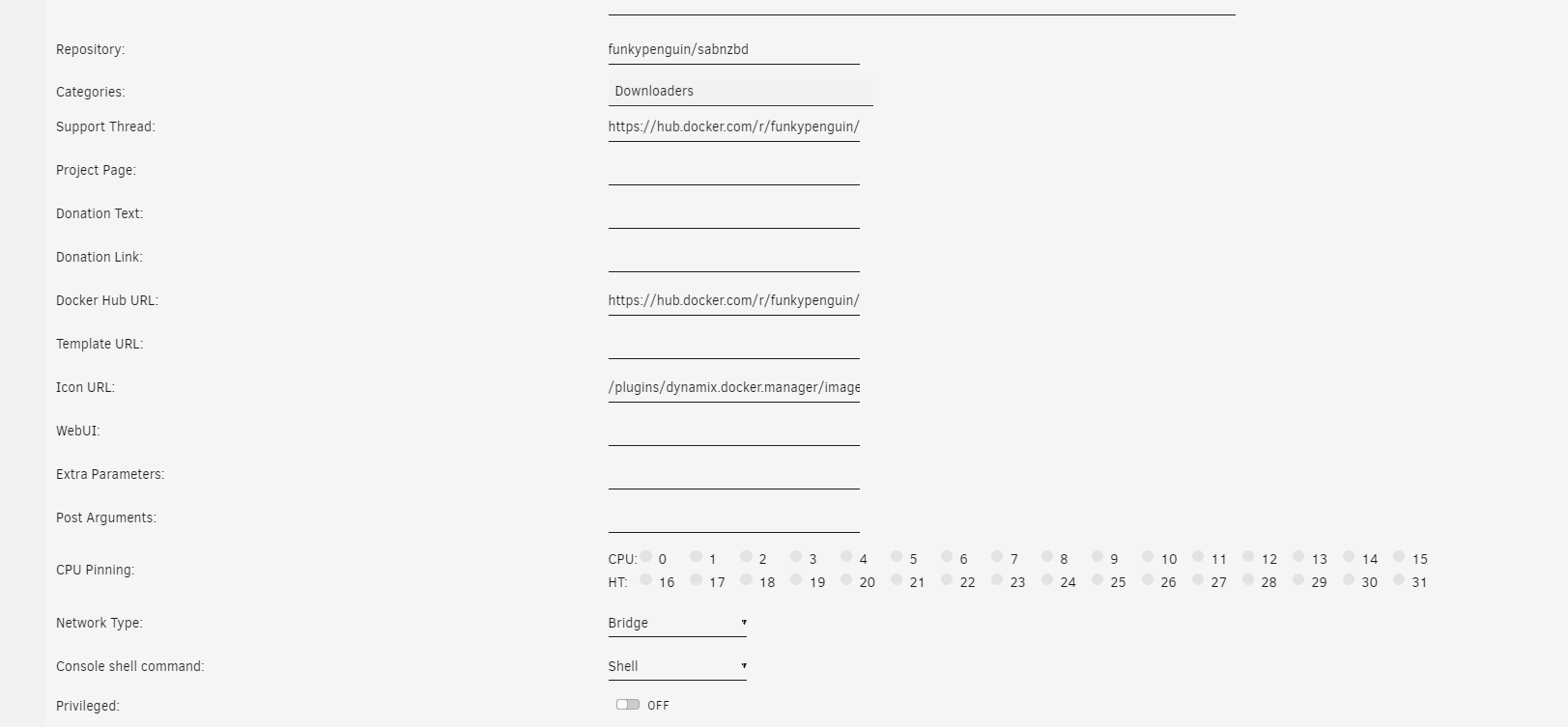

I am trying to install a docker hub docker https://hub.docker.com/r/funkypenguin/sabnzbd/

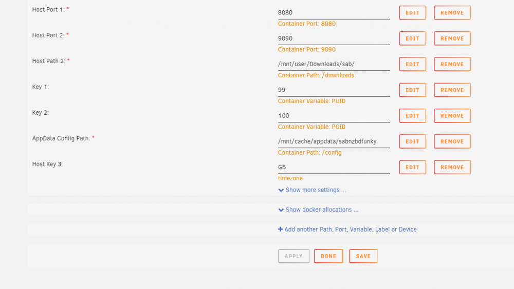

it has installed and runs (I can access the webui) but the sickbeard_mp4_automator is not there? it is just like my standard version of linuxio's sabnzbd
the appdata folder is only a few bytes but the image is reported to be over 300mb?
I know that @sparklyballs is a contributer to the funkypenguin sabnzbd docker so hoping for some help please 🙂

This container is quite old but if you don't mind that it should still work.
I see the container has installed "sickbeard_mp4_automator" to a root directory at /mp4_automator.  It was copied from github on the day the container was built.
