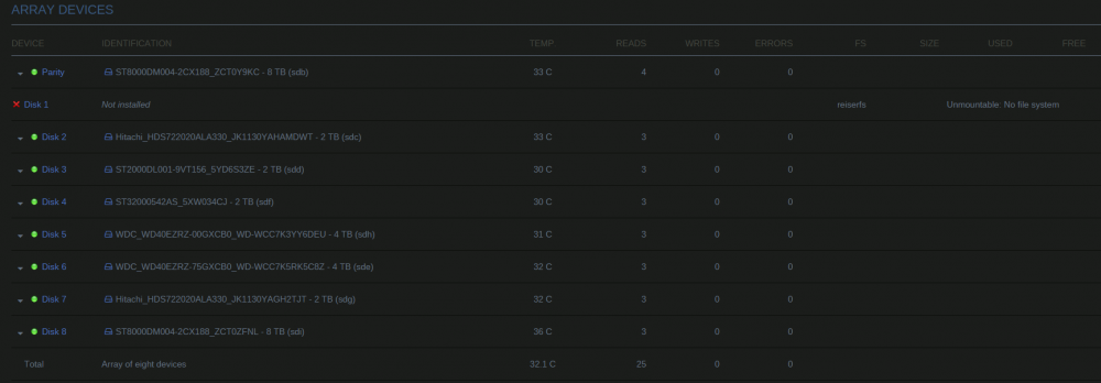

Unplugged physical drive, started normal mode, no emulation. Stopped and started maint. mode, still no emulation, same error on filesystem check from webUI.

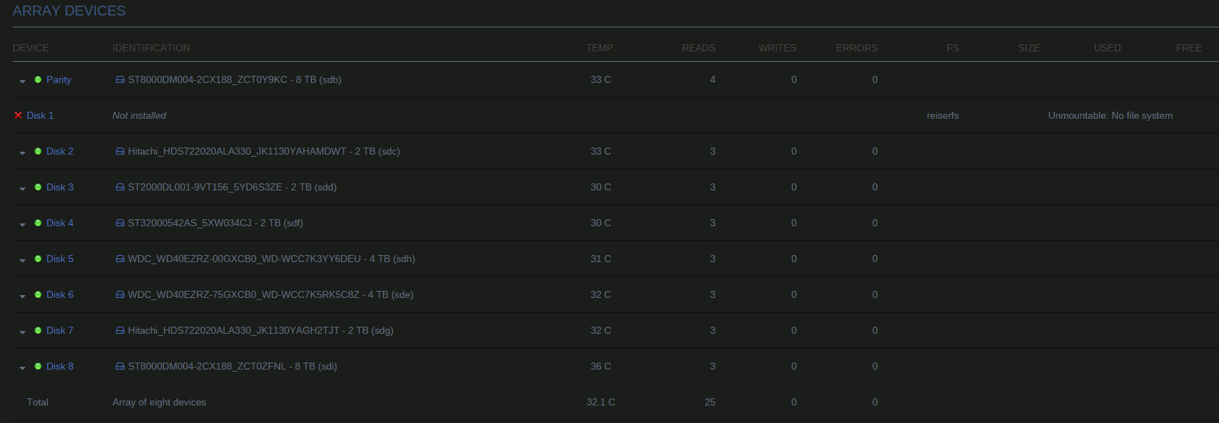

Checked bios, it's still configured properly. I'm glad because I know undoing that specific 'corruption' is a pain. One thing I'm noticing is that with the physical disk unplugged, the webUI still has 'Unmountable disk present: Disk 1 • ()' under array operation with the checkbox and option to format. Is that normal?
Do not format anything until one of the gurus says to do it!!!!
The fact the disk is still showing should mean it is being emulated.    Click on the disk and select the option to run a file system check.
41 minutes ago, crakhed said:
and if it's being emulated, it's still not appearing in explorer.
It is being emulated, but since it has corruption and is currently unmountable you won't see it's contents

Yes, I did it through the webUI from the disk1 settings page. Should I maybe do it manually with the terminal html window, or even PuTTY? It is currently running in maintenance mode as in the image. The rest of the array though, when mounted, IS accessible and all shares appear properly except for disk1 shares/disk share are absent. Doesn't it usually say "Emulated" next to the warning/disk on the main tab?
