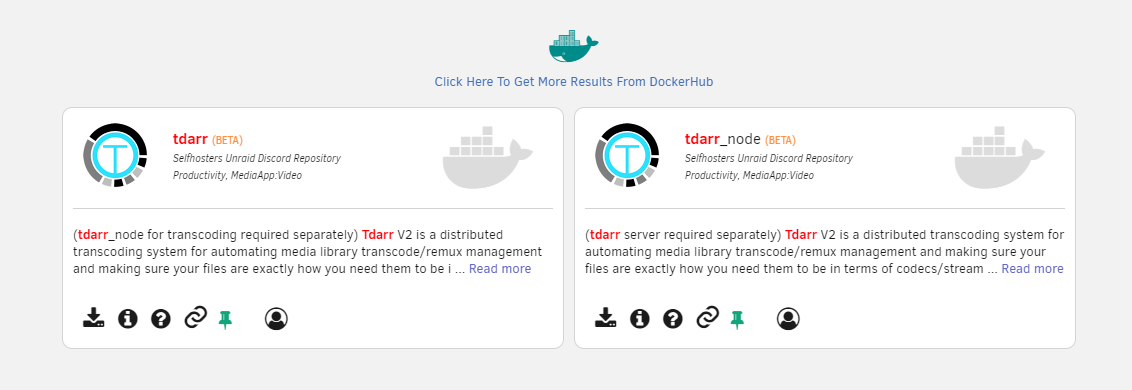

Has tdarr_aio been pulled from the app store ?
(see attached image)
Thanks
Terran
