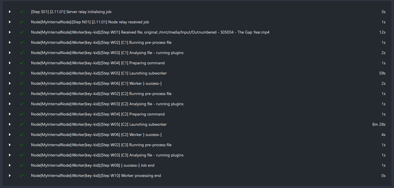

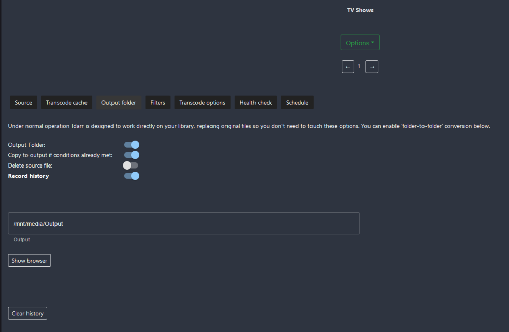

I have set tdarr up and it seems to be working, apart from renaming the files and moving them from cache.
Can anyone see what I have done wrong here please? Do I need to create a step to rename and move?
Successfull transcode (no mention of a move attempt):

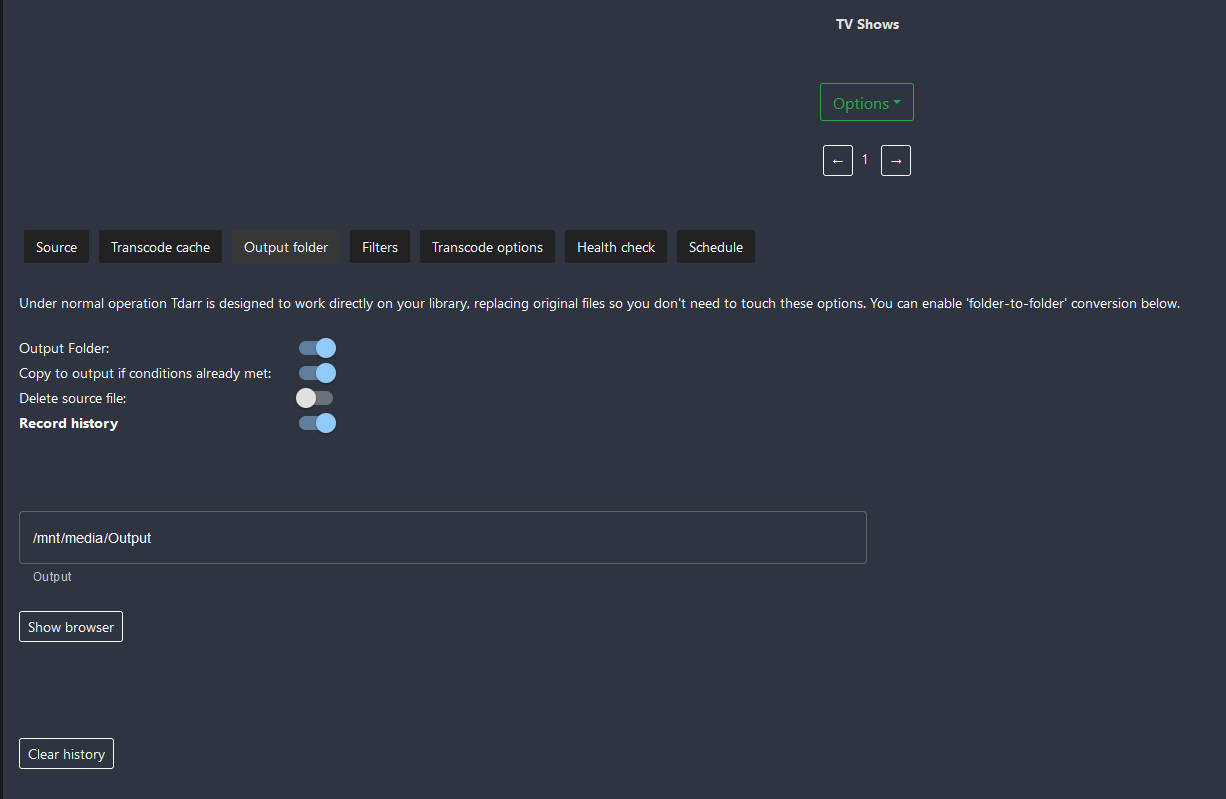

Library options:

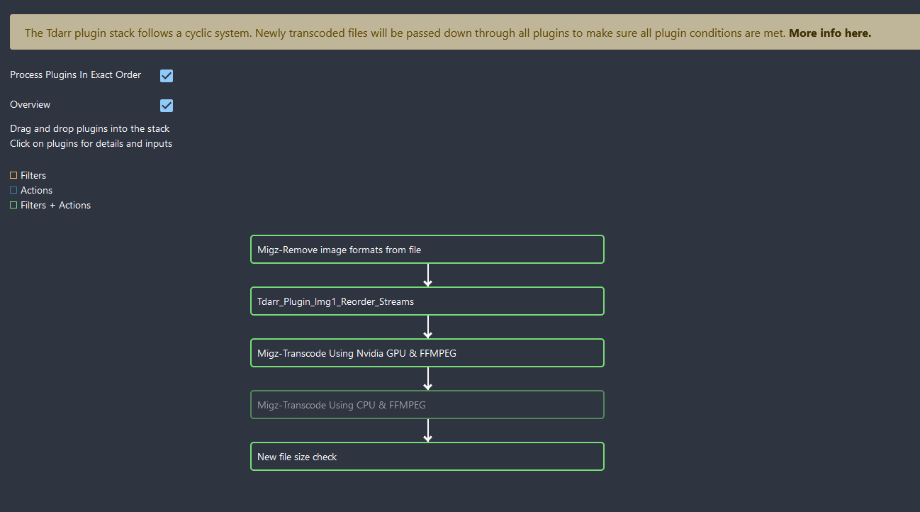

Transcode options:

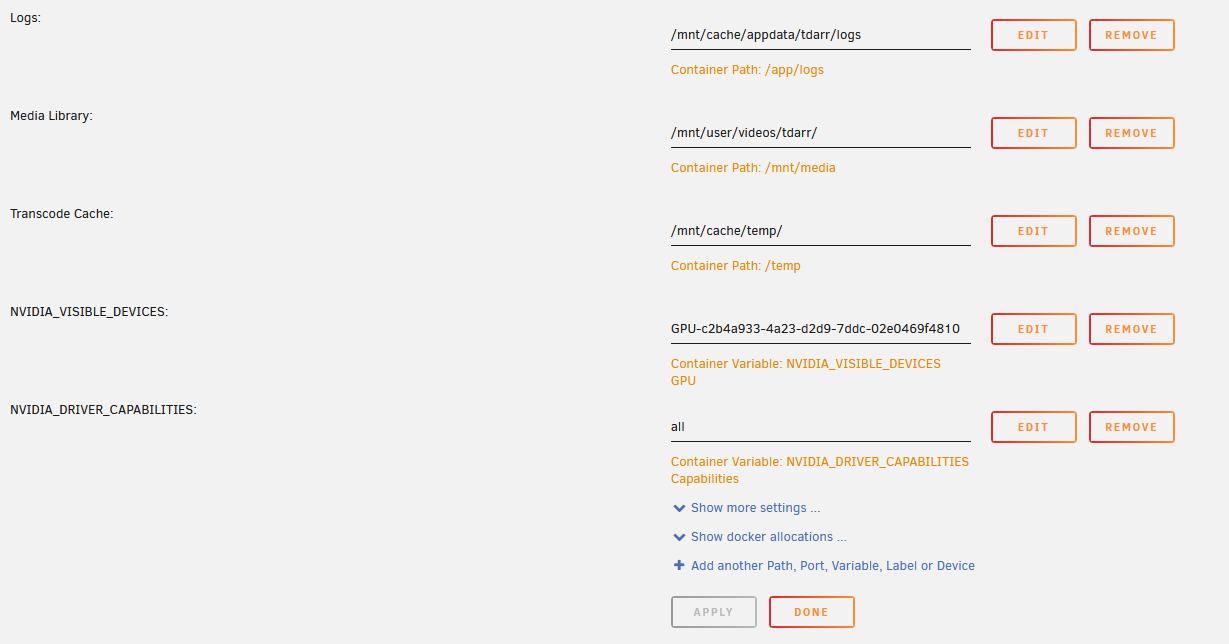

You don’t show your container mappings but I suspect that you don’t have the container path /mnt/media/OUTPUT mapped to a host path. You can post your docker run command for TDARR if you like.
Thanks for replying:
I haven't mapped an output, it is the same as the media library:

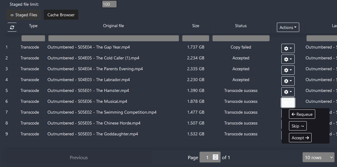

OK - I have just clicked on 'Actions' and 'Accept' and the files are being renamed and moved to the Output folder!
Is there a way to make tdarr automatically do this?
Edited by showstopper

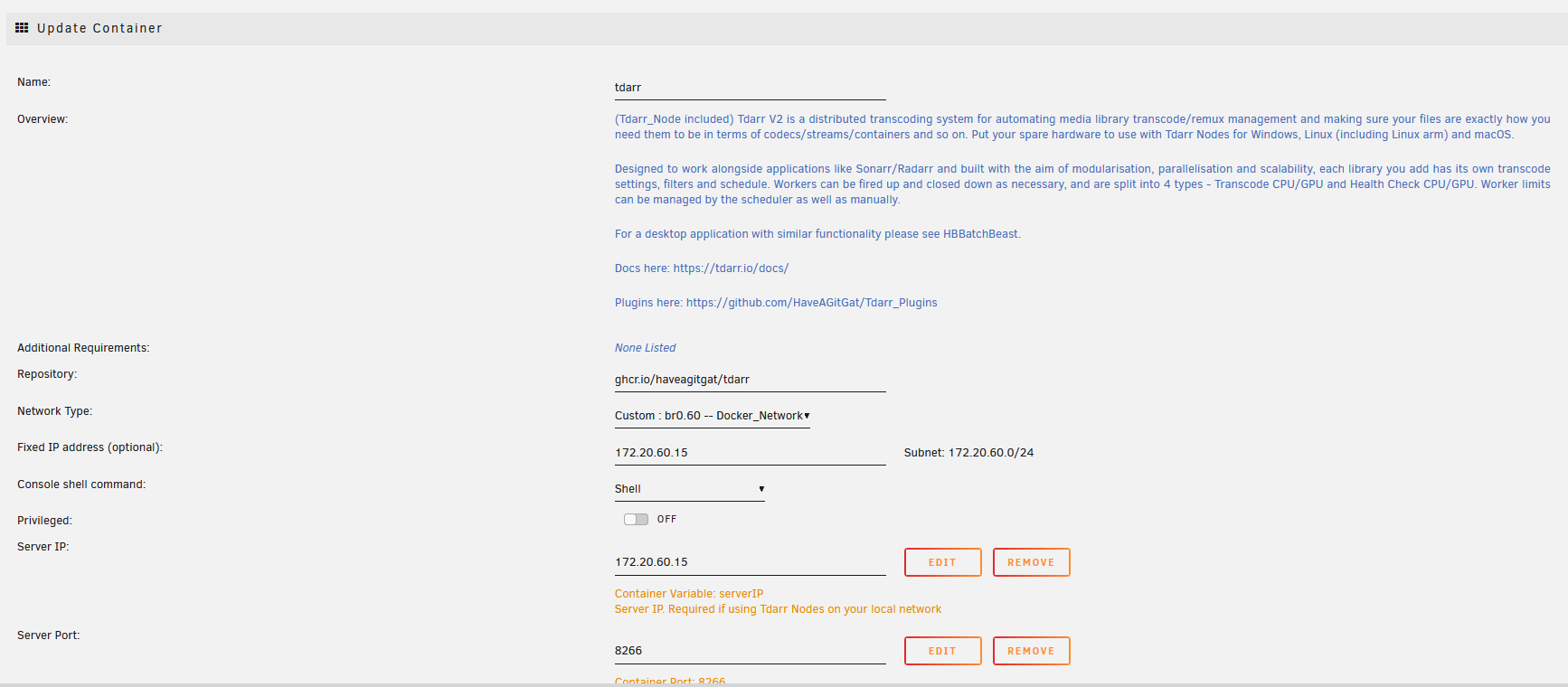

On 9/21/2023 at 7:04 PM, almulder said:
Note: Both Tdarr and Tadarr-Node have the same paths setup
Did you add the NVIDIA paths yourself ? Because I don' have these.
