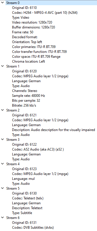

Enigma2 is basically the software foundation running on popular Linux receivers like the Dreambox or Vu. Put simply, it takes whatever comes down through DVB-C/S/T and stores it in a .ts container.
For my old recordings, this mostly looks like this:
Newer recordings benefit from the fact that TV stations (like ZDF) have adopted H.264 for the video stream, saving lots of bandwidth and in my case, storage on unRAID:
So in addition to converting from MPEG2 to H264, it might also be necessary to move the Teletext stream down a bit, since I understand that Tdarr needs the video stream to be the first in the file for proper codec recognition.
As for Enigma2 requirements, I don't think there really are that many other than the .ts conforming to the standard used by DVB. I can provide a sample file via Dropbox or something, if the description is not sufficient.
Thank you.
Can you provide a sample file? I will have to test the proper settings myself. I can provide a link for upload as well.
Regarding the video stream at pos1: there should already be a plugin active in your library which does that.
Do you want the recordings to be in h264 or h265?
Gesendet von meinem MI 8 mit Tapatalk
Yes, of course, just let me know where I can put the file.
Thank you.
As far as I know, H264 is the maximum supported by my boxes for .ts files. I can always transcode them to something more advanced later on.
