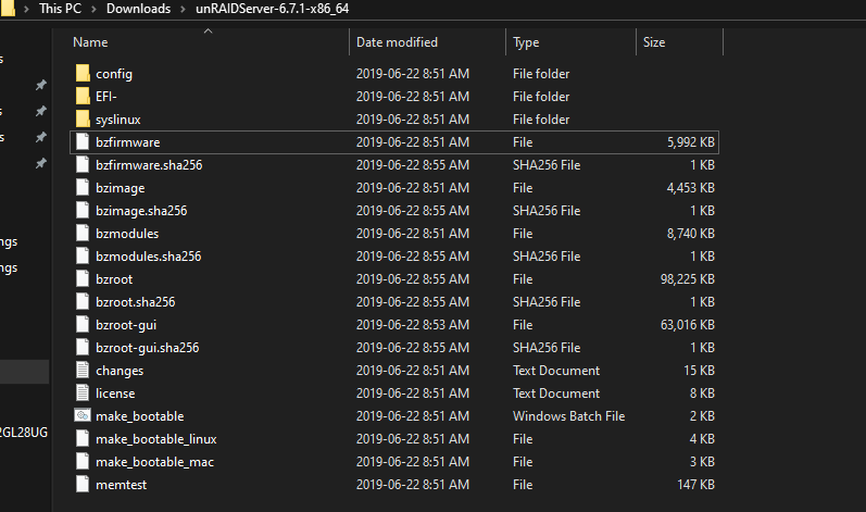

I took a look at your diagnostics from January. The ixgbe module is loading properly there - that was Unraid 6.6.6. Now (6.7.1) it isn't. Maybe something went wrong with the downgrade. Try copying the bz* files to your USB flash again. Can you manually load the module?
modprobe ixgbe
 So copy all the bz* files from here onto my flashdrive? Tried "modprobe ixgbe" but got could not insert error. I'm going to try and copy the bz files.
well replacing the bz files worked...
Good. One of them must have become corrupt when you originally copied it.
