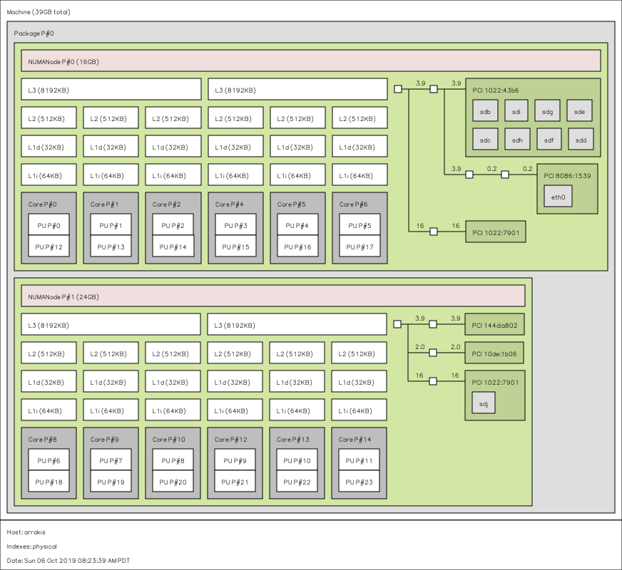

Using LSTOPO, I've verified that my GPU and NVME are both running in NUMA node 1. As such, I've pinned, isolated and assigned every cpu for node 1. I've also followed @Nephilgrim post here, and edited the xml for numatune to pin my vm's ram allocation to node 1. I've verified this with numastat, and it is working.
The only things not in node 1 as far as i can tell are my sata controller and my ethernet controller. I've disabled my second drive that is running over sata, but it didn't improve my performance.

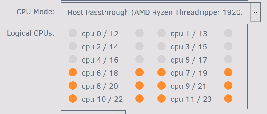

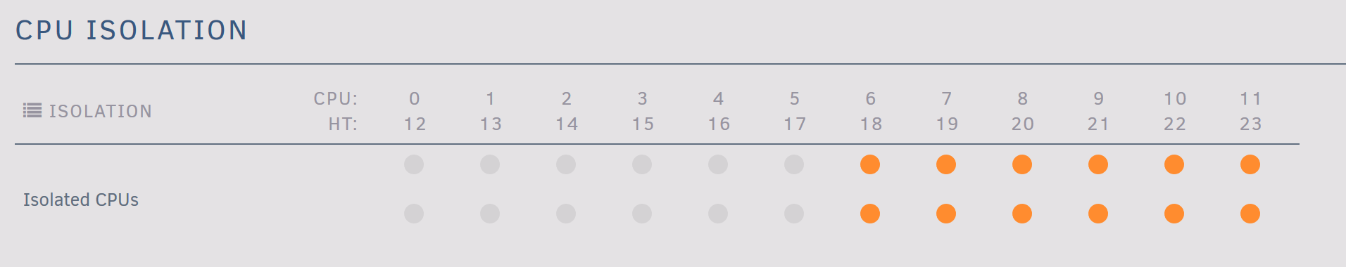

My pinned and isolated CPUs:
LSTOPO:

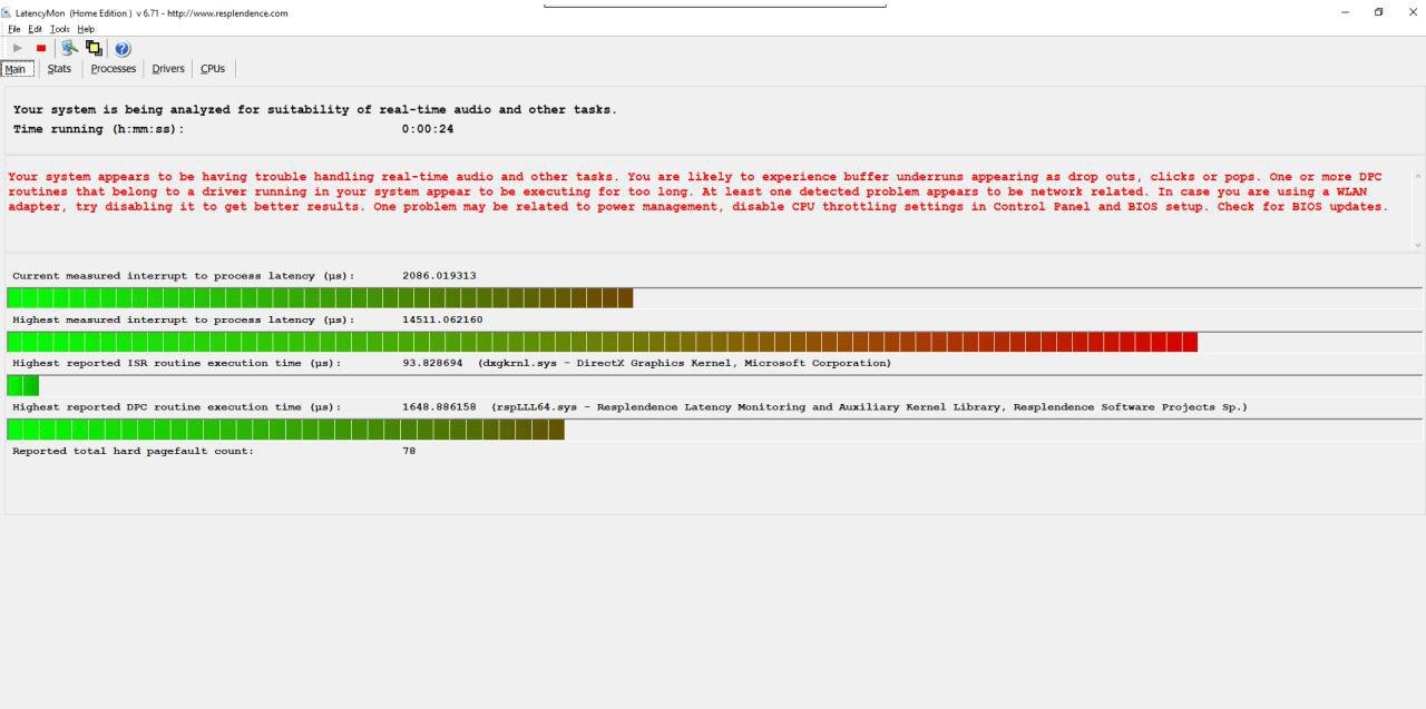

latencymon and gaming deliver terrible results. Ghost Recon Wildlands nets me about 14fps, unigine gave me a score of about 5000.
I'm really at a loss. From what i read, making sure ram, cpu and gpu were all in the same node seemed to fix the problem for most people. I have done all those things, but my performance is just hot garbage. Can someone offer me some suggestions? I'd really appreciate it

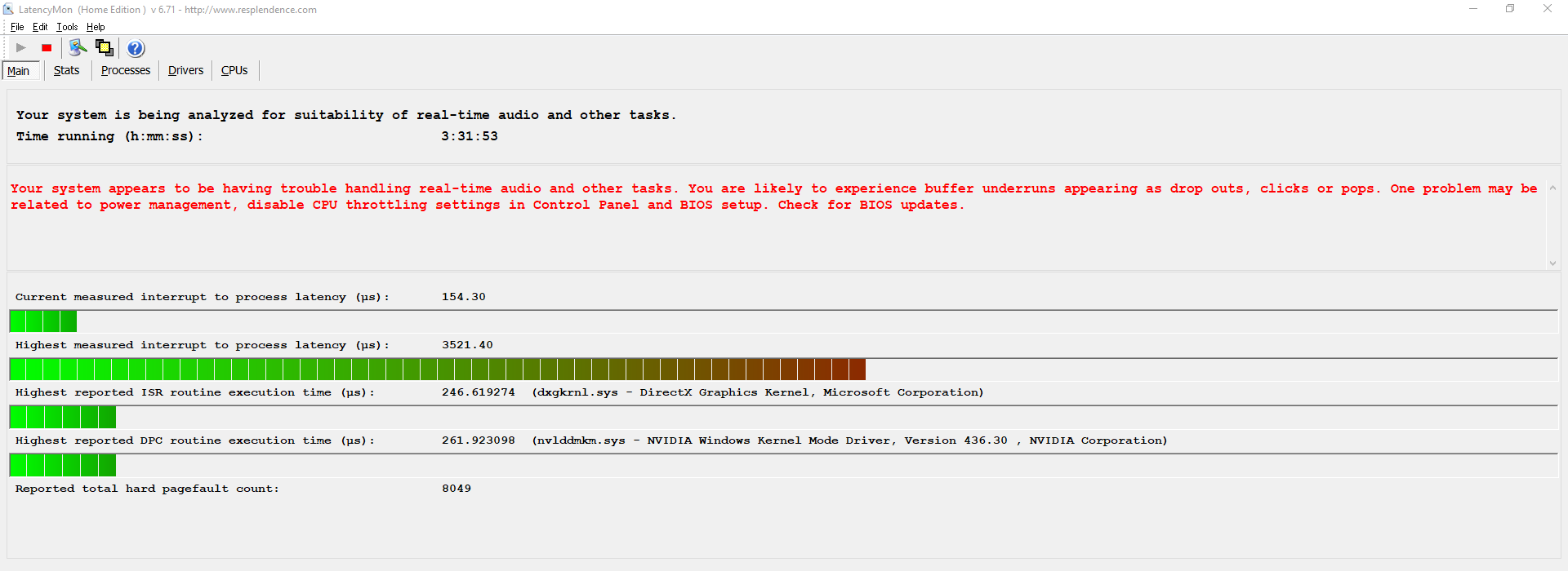

Thanks for your replies! I've still got some wild latency, but your recommendations were a huge step in the right direction. I'm down to about 3500 on latency mon after 3 hours vs 15000 after 24 seconds. GRW doubled in FPS to 30 at 1080p, but realistically with this rig I was able to do 4k at 45fps on bare metal.
I unpinned 2 threads in my vm and assigned that to my emulatorpin and iothread
I passed through the controller for my NVME and installed the Samsung driver for that
I added the Epyc info to my <cpu> tag.
I copied the <hyperv> section from the first reply
This is my pinned cpu's now:
My New XML

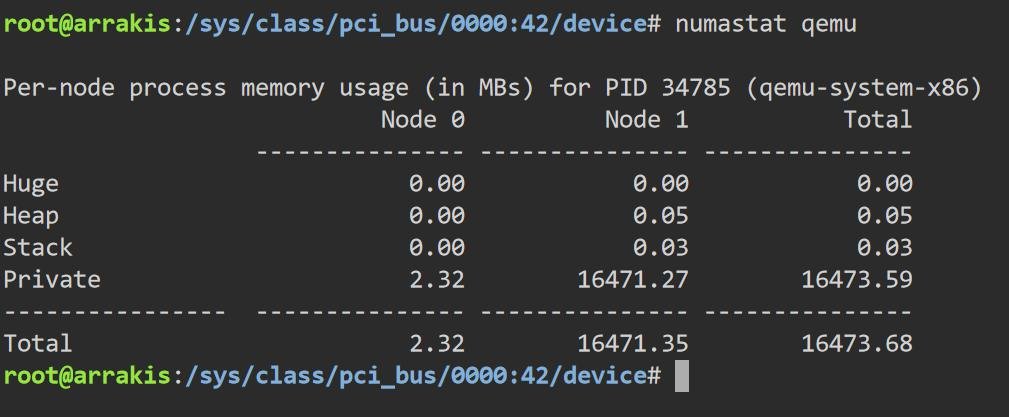

Current Numastat (no change)
anyone have any other ideas I could try to get my latency down?
I've checked my bios and that is up to date. Maybe I missed something there?
I'm glad the emulatorpin change make some difference, but you are right, there's still room to improve.

Thanks for that suggestion :) I haven't had as much time as I'd like to be able to play with it this week.
I cleaned out the all my pcie slots with rubbing alcohol and cleaned the contacts on the card itself. I did find something interesting in that I had my gpu in an 8x slot. I've moved it to an x16 slot on the same node, and the command you had me run confirmed that.
I tried your xml change too, and that didn't seem to make any difference. My latency is about the same at around 1500. It seems curious to me that the latency peaks with the nvidia driver. I tried an older driver, but that didn't help...

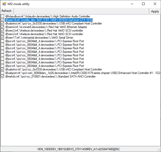

Are you sure that the MSI_util patch is applied to the audio and video drivers?
I have a latency of 148.
I somtimes still get stutters on CPU heavy games but it is mostly okay and the benefits of unraid make up for it 🙂

I just noticed this part. Did you tried to use msi_util?
https://www.dropbox.com/s/gymaipg6vprd508/MSI_util.zip?dl=0
apply to your nvidia sound output like this and reboot
Edited by Nephilgrim
Thanks everyone for your suggestions. I did try the msifix a while ago and that did make a difference too. I’m still getting latency quite a bit higher than I’d like (averages between 6-900), and between that and poor benchmark performance I didn’t do any further testing in most games.

On 10/23/2019 at 8:45 PM, chromedome said:
Don't worry use your desktop experience as your benchmark, if your mouse is smooth w/o any jitter while background apps are loading and your sound is fine - your system is responsive enough.   Play games for a few hours.  My Latency Mon numbers would say otherwise, but  I can play many games w/o any stutter, I haven't played one that did.  What I learned a few months late is that you don't need a lot of extra stuff with libvirtd for a smooth overall desktop experience.
So start simple with your configuration.
The more I played around with the CPU configuration, the more degraded my performance became.  I learned that by just installing win10 using a basic native qemu setup and using a simple XML and adding what I see from forums, but one line at a time - to troubleshoot.
So here I am sharing mine.   I borrowed some CPU config lines from Symon's  XML.  Not all of them worked for me because as I'm using qemu 4.0.0
<snipped/>
Thanks for that :)
The last big issue i had that was noticeable was that my sata and usb controller were on a different numa node, so i'm ordered a combo sata/usb3 controller card. I'm thinking that will improve things a lot. I'm going to pass that through when it gets here, and then leave things as is until 6.8 comes out and i can see if there are any improvements from qemu 4.1...
I've been really pleased so far tho, and this is the most helpful community i've been a part of. Thanks everyone!
Edited by darthcircuit
