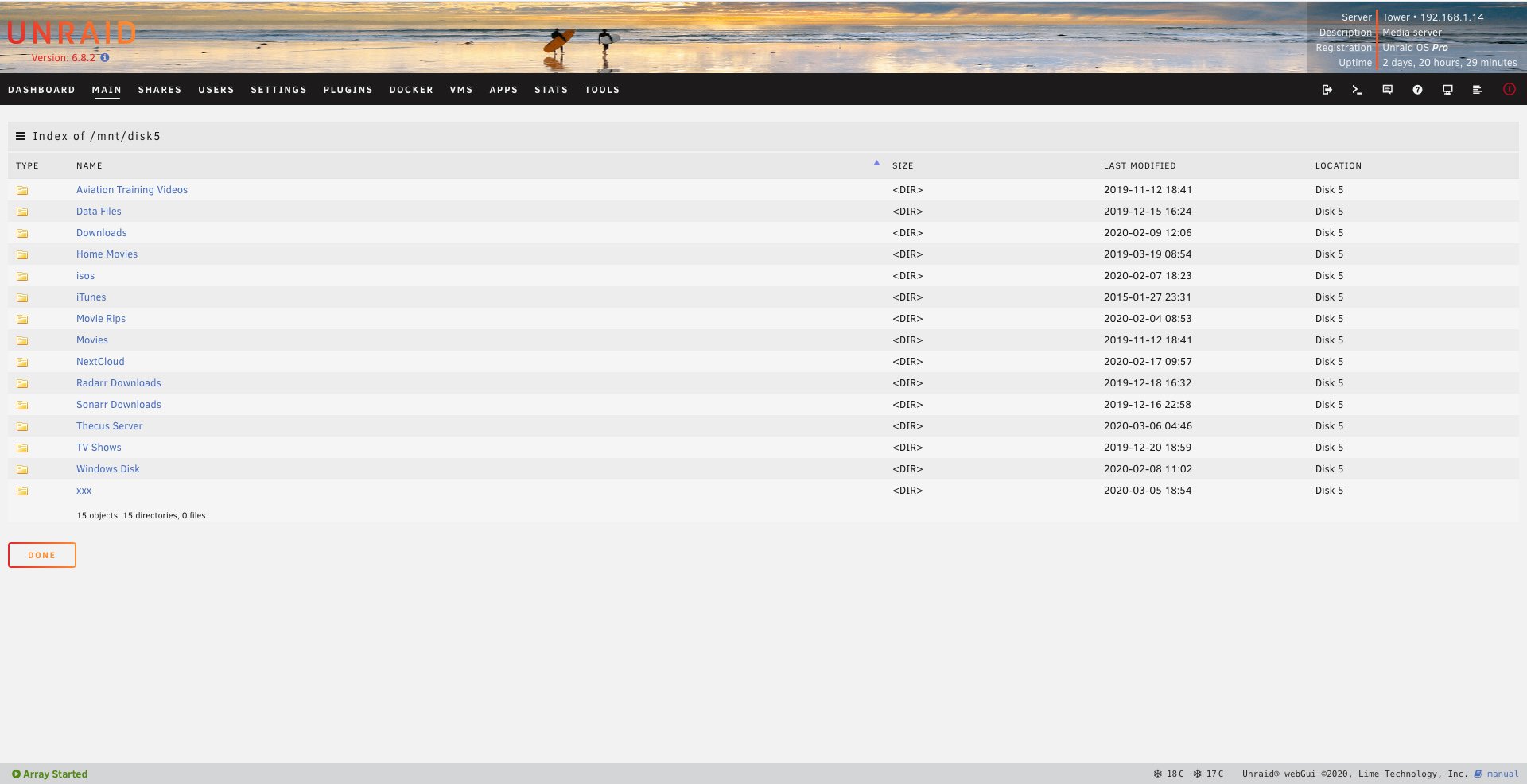

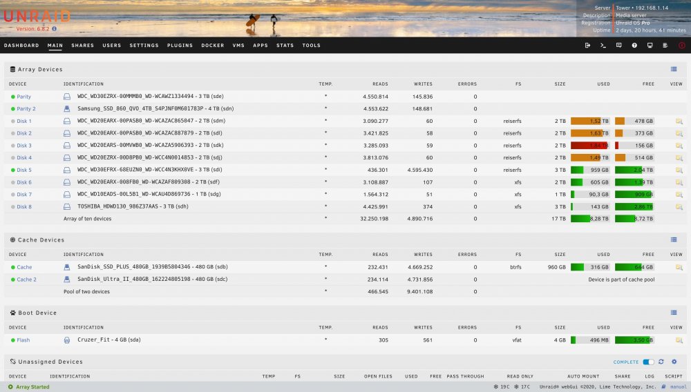

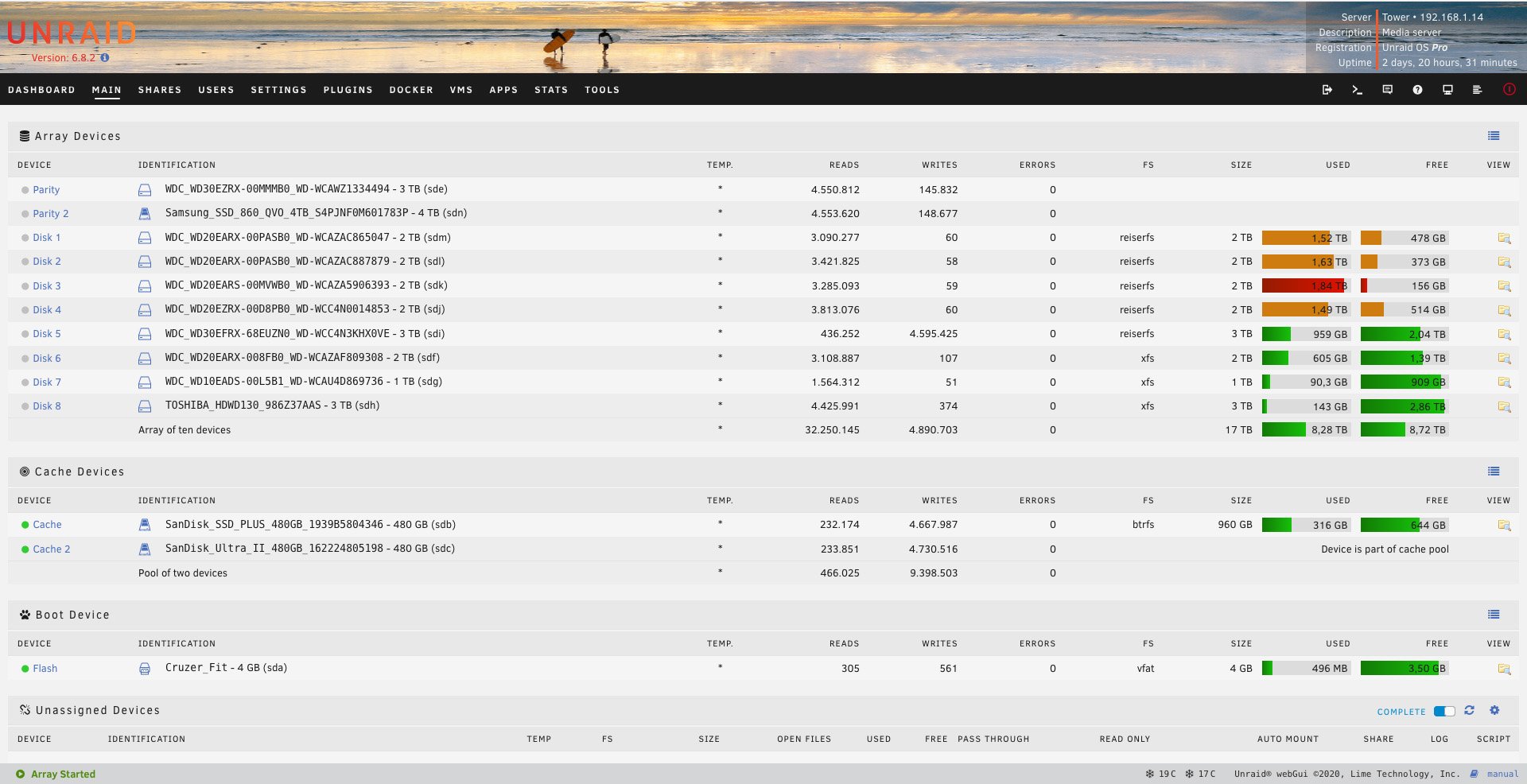

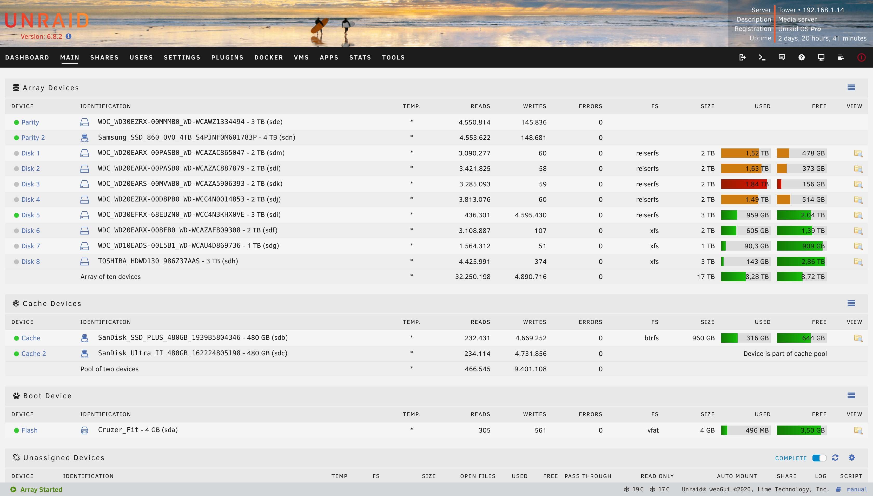

Thanks so much for helping the OP in this.  I have a similar problem in that one of my disks will not stay spun down.  I recently replaced the drive as it was beginning to fail (possibly because of being in a permanently energised state?).  I have checked the files on the drive and stopped the Nextcloud docker in case that was the cause.  There are no shares that should be on the cache drive, to my knowledge, and only download data from dockers such as Radarr, Sonarr and NZBGet amongst other private data shares.  Something is causing the disk to spin up.  If I manually spin all disks down and leave the server completely alone, disk 5 and the two parity disks will automatically spin up again within 10 minutes.  I am not an expert in this by any means but I have tried to keep all appdata, domains and system files on the cache pool drives only, so I am at a bit of a loss.  I attach the system diagnostics log.
Hoping for an expert eye to pick up the problem :)
Many thanks
D
