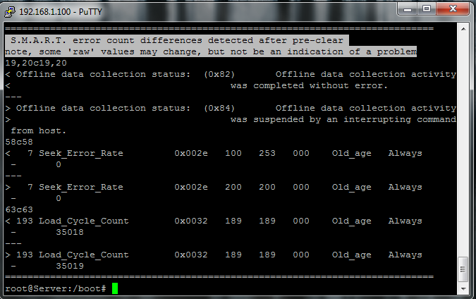

Pre-clear finished.    Some seek error anomalies but aside from that looks ok.
Kryspy
Kryspy
No abnormalities at all.  Just the factory value of 253 being changed to an initial value of 200 as you start to use the drive.
I really gotta learn the craft of what all this stuff means or I am going to worry myself to death :)
