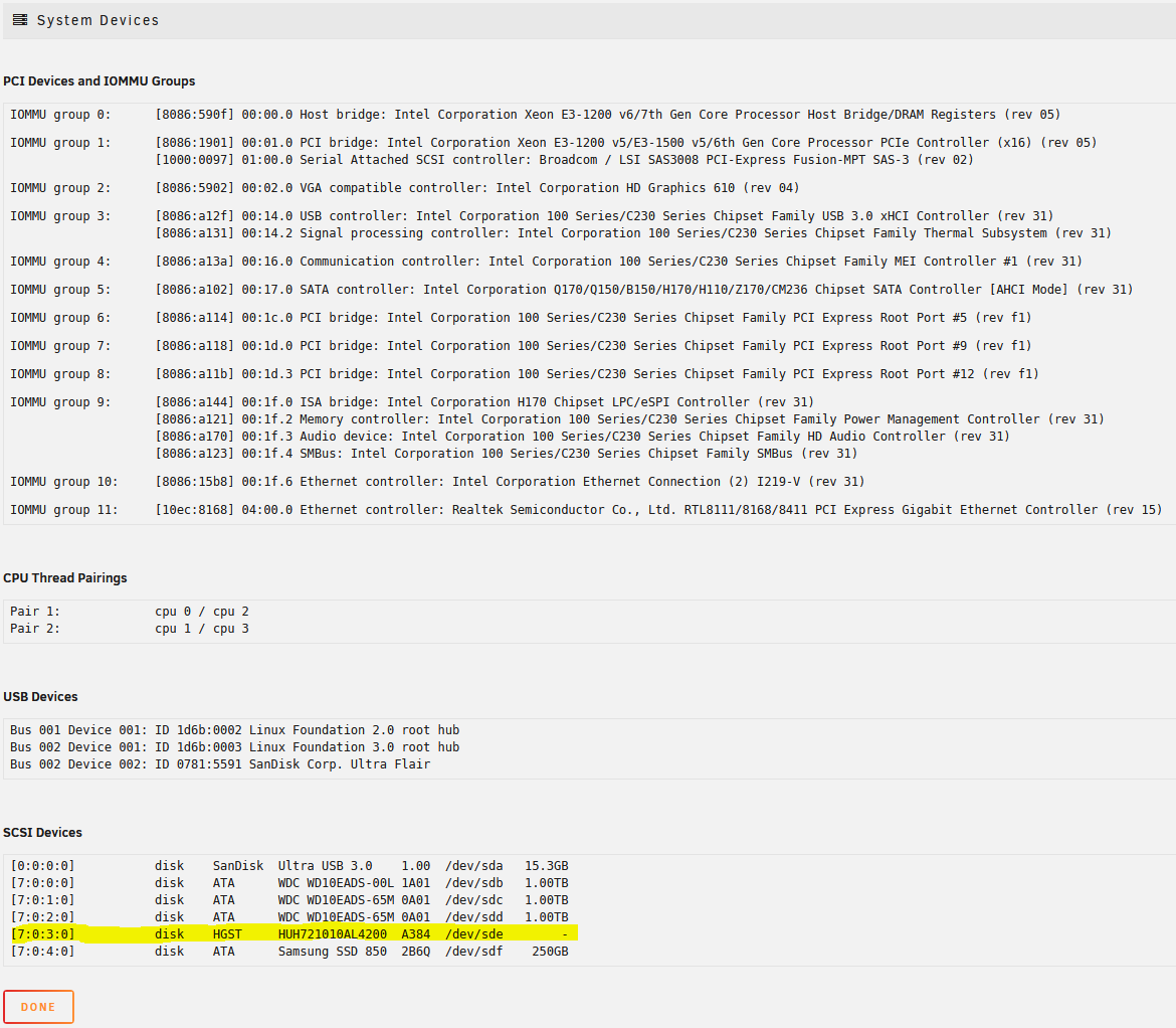

In the device information in the Unraid, the disk is displayed as follows:
The hard disk is unformatted and unpartitioned. I have already tried to run the disk on a different channel and completely alone on the controller. Unfortunately both without success.
