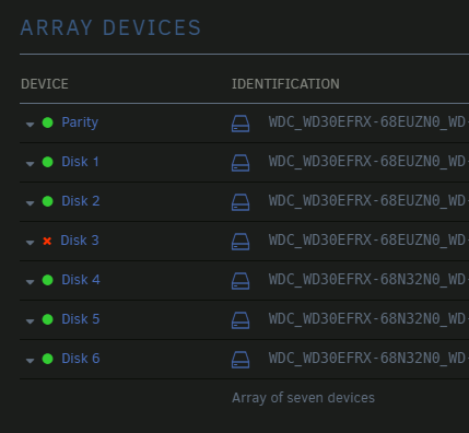

- Went to move some recent files which would've been moved from Cache to the Array within the last few days 😃
- I got a couple of emails from my NAS warning me that /dev/sdg had gone bad 😬
- I headed to the main page & saw the lovely
- Checked the SMART data on the disk, seemed fine
- Rebooted...
I got another email to say "Subject: Notice [RAPTOR] - array turned good"
- Still got a lovely emulated disk

Trouble with that procedure is that technically parity isn't actually valid in your case.  This is because a write to the drive actually failed which means that the contents of parity was updated and the contents of the drive wasn't.    (Not to mention any other writes that happened to the emulated drive before you noticed that it was disabled)
IE: Parity is valid, but the contents of the drive are incorrect.
A correcting parity check would update parity to reflect the drive's content (which is wrong)
Ideally this situation calls for:
  1. Stop Array
  2. Unassign the disabled drive
  3. Start Array
  4. Stop Array
  5. Reassign the disabled drive
  6. Start Array and let unRaid rebuild the contents of it onto itself.

Thank you so much Squid!! Doing that now 🙏🙏🙏
All sorted @Squid 😌
Rebuild just finished and all is good in the world 🙌
