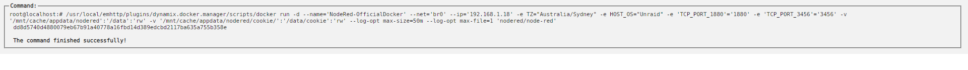

Here is my docker run command
run -d --name='nodered' --net='br0' --ip='192.168.50.12' --log-opt max-size='50m' --log-opt max-file='1' --privileged=true -e TZ="America/Anchorage" -e HOST_OS="Unraid" -e 'TCP_PORT_1880'='1880' -v '/mnt/user/docker/appdata/nodered':'/data':'rw' --publish 80:1885 'nodered/node-red-docker:v8'
