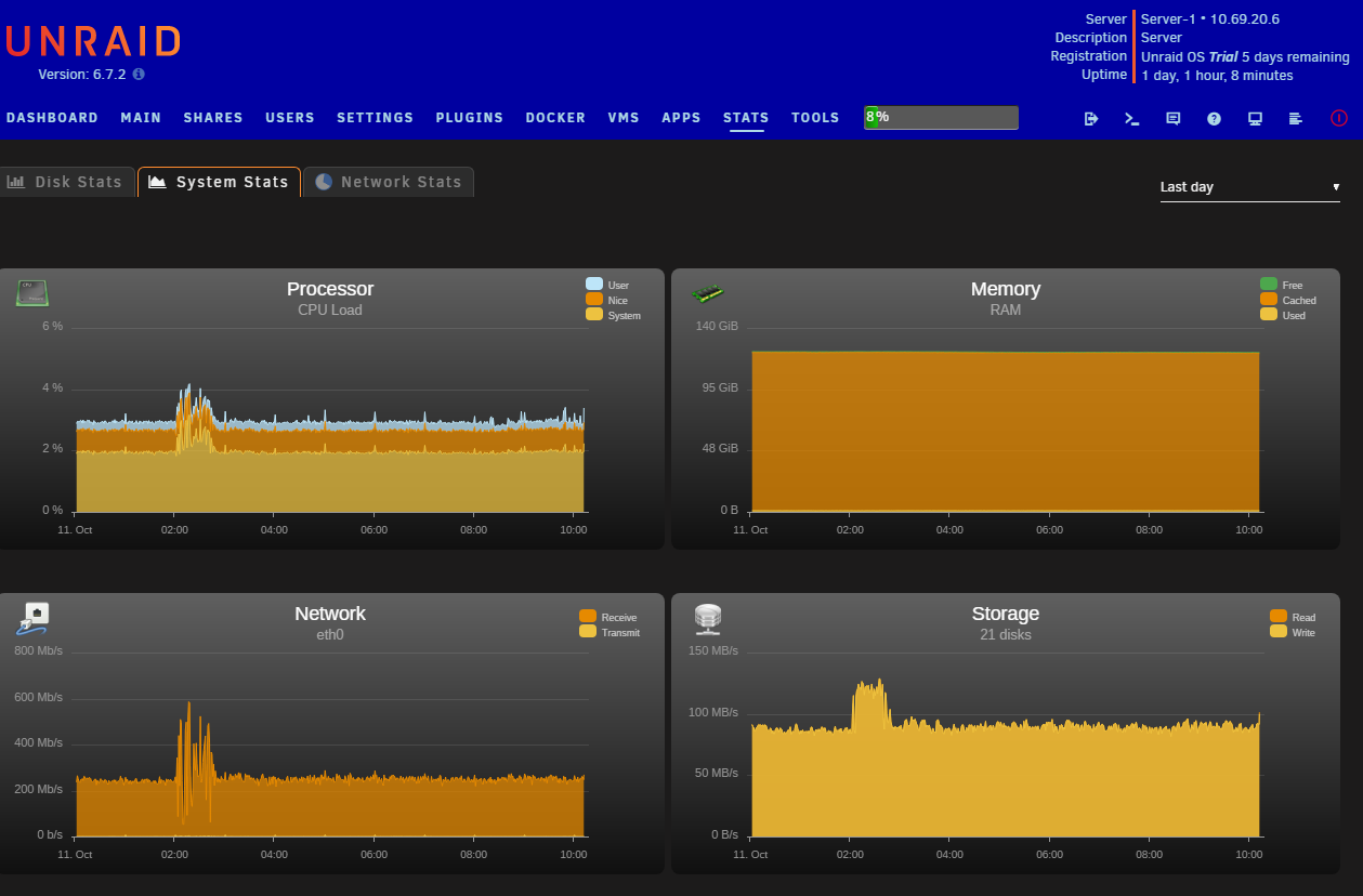

Not sure if this helps but about 20 hours ago I did setup my disks to spin down if inactive for 4 hours. Then I started a fairly large data dump from a different NAS, about 2.3TB, when the file transfer started it had ETA of 8.5 hours or so.  The file transfer is still going on now, been over 20 hours.
Here's a ss of system stats for last day.
