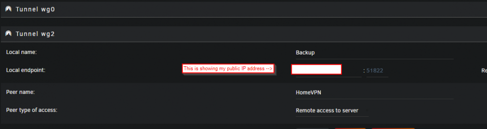

Thanks. Been a bit hectic lately so I'm just now getting back to this. After looking at my main server and thinking about it for a minute, I realize it says "Tunnel wg0" and that all my connections are listed there, so I do get it now. In my head, each device gets its own privately encrypted connection and I thought that was the "tunnel" - I guess I applied the wrong term. It doesn't really matter if everything's working, so I'll live with my current level of knowledge. It's not important enough to me today to get any deeper.
I think I may have it working correctly now! This is what's showing on my main server:
1834071793_2019-12-2017_58_17-NAS_Dashboard-Brave.png.f45ea78977a02f0be4812ac8b71b23ec.png
And this is what I have on Backup:
1140092190_2019-12-2017_59_03-Backup_VPNmanager-Brave.thumb.png.f8c10d6daeb261936092dcb782f39972.png
I added a second tunnel on the Backup server and imported the config file, enabled the tunnel and immediately had a connection on my main "HomeVPN" side. It does show my public IP address in the Local endpoint, not the DNS name - do I want to change that?
Also, I ended up adding the tunnel because when I first imported the config, it was "server to server" and that's not what I was after. I tried to delete the peer and import the new one, but it didn't seem to change the settings.
I added the new tunnel (actually, 2, obviously, though I'm not sure why), imported the config file and it seems to be working. I just took a look at the wg0 tunnel and it's got no settings in it at all. I may try deleting wg2 and importing the config file into wg0 to see if it'll work. It seems that it would be cleaner with just the one tunnel instead of one unused one and the 2nd functional one. Thoughts on that?

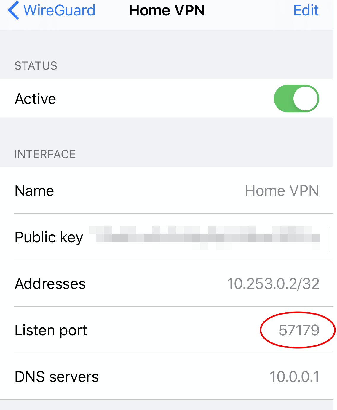

I've not been able to get Wireguard to work on my setup.  I've followed all the troubleshooting steps in this thread including port forwarding, making sure the tunnel is active in the UI etc.  I used the default port of 51820.  I've tried setting the local endpoint using my WAN IP or my DuckDNS URL. I've also tried manually entering in my router address as the peer DNS server.
Here's what I'm seeing :
- Wireguard app shows "connected"
- Wireguard app log shows handshake not completing in 5 seconds and keeps re-trying without success
- Wireguard web UI / Unraid dashboard shows that handshake was never received
- Tried to ping my peer tunnel address via web UI and it fails
Not sure if these are a factor :
- iOS 13.3.1
- T-Mobile 39.5.1
In the Wireguard app screenshot below, the listen port is not 51820 and this seems to change to a different number every time I start a new session.
Can anyone help ?
On your screenshot, its using a different port to the default 51820 ?
Did you do port forwarding on your router?
