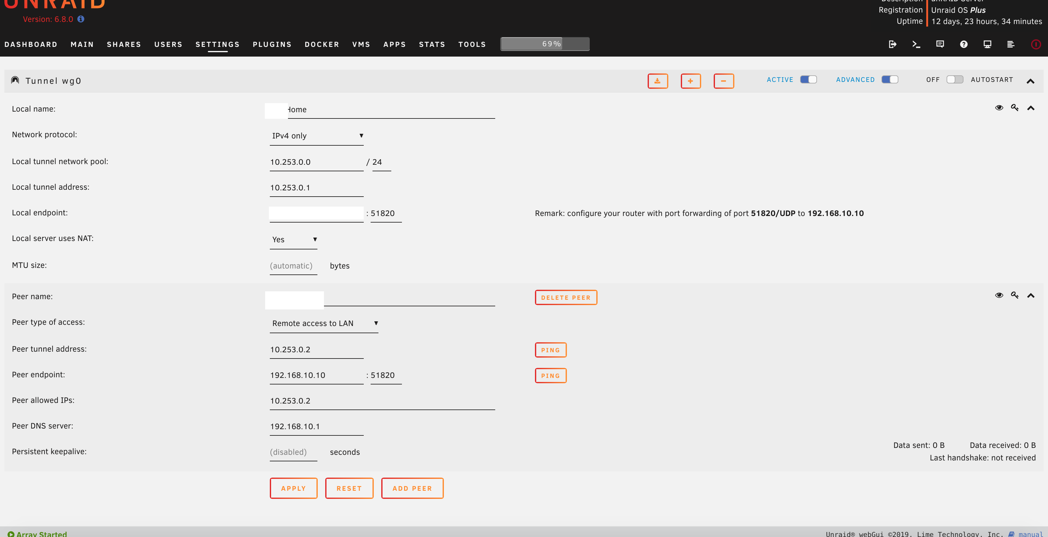

I'm having issues with getting the handshake to successfully occur.
I have WG setup on my Unraid server using the public IP. (I will use DDNS later, but I'm trying to reduce variables to solve this problem.)
I am running an EdgeRouter and setup a port forward to my unraid server.  I've ensured bridging is enabled on eth0.
I have configured a peer as "Remote Access to LAN" and tested this config using the QR code method on my iPhone.  I can't get my iPhone to handshake with Unraid.  I have Local server uses NAT set to Yes for now.  Will setup the static route later once I can get the basic stuff working.
Here is an screenshot of my configuration:
I read through this whole thread and saw some people had the same issue as me and tried the different solutions that worked for them, but none worked for me.  Any thoughts on what I can do to identify the issue? Thanks!
