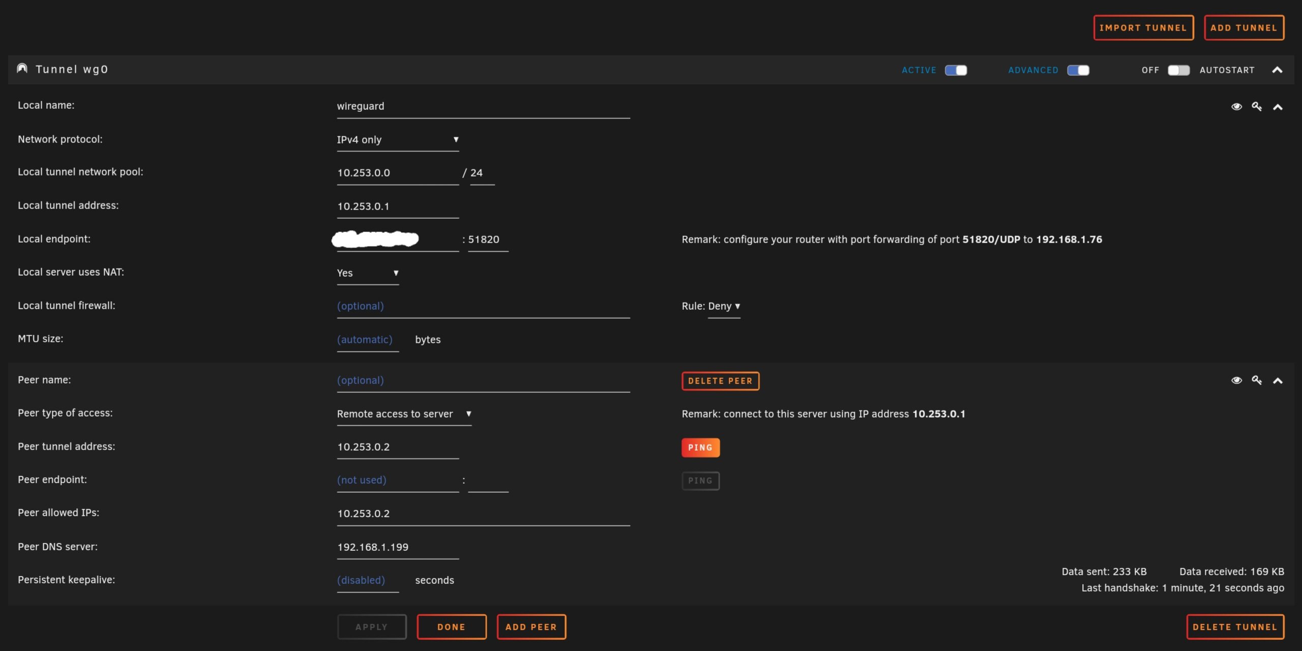

After a little playing around, WireGuard is now running great on my unRaid server and I can remotely connect.

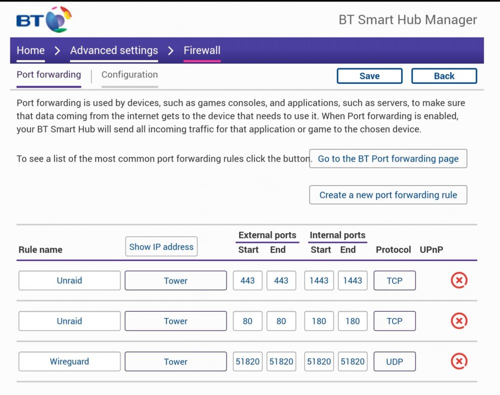

My one issue however is that in the WireGuard settings on unraid, I need to enter my home IP address in the "local endpoint" field. If I enter my custom domain name which is setup and running great with all my other dockers, it won't connect / initiate a handshake.
I have DDCLIENT running which updates my IP to Cloudflare but no joy unfortunately. My routers port is forwarded correctly and I've ensured that my PiHole Docker is entered into WireGuards "Peer DNS Server" field.
Any suggestions would be greatly appreciated.
***Edit***

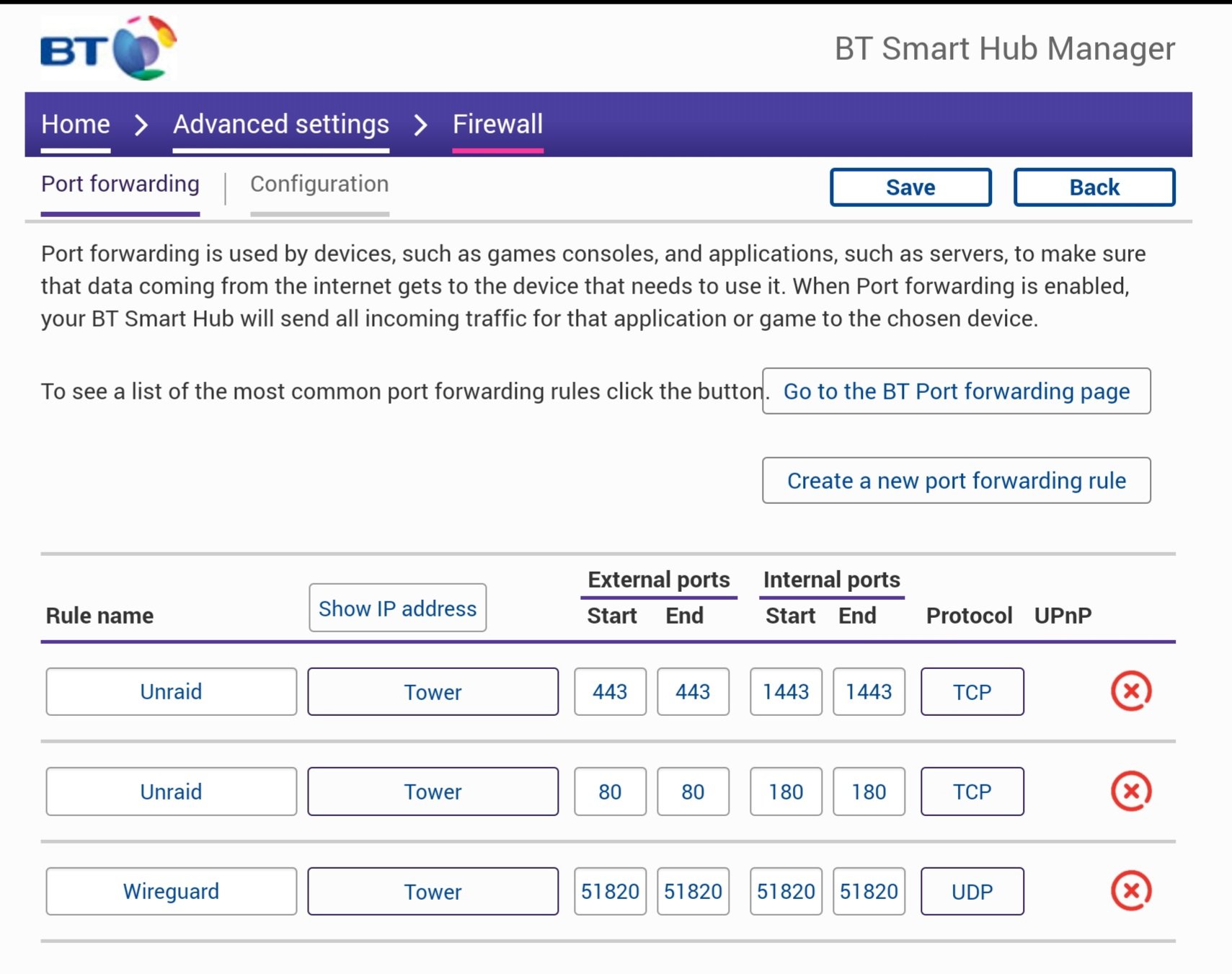

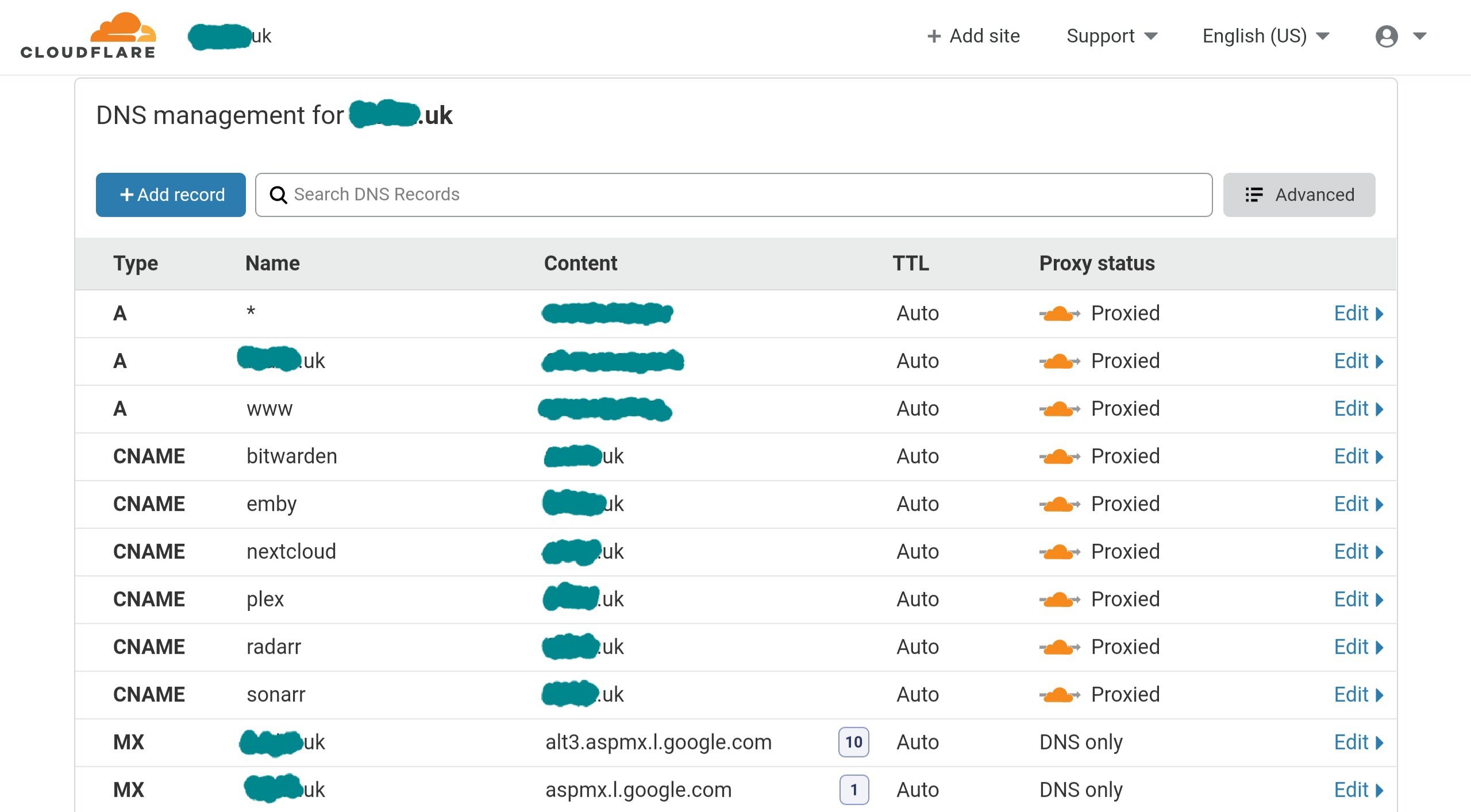

If it helps, here are two screenshots of my Cloudflare DNS record page along with my routers portforwarding page;

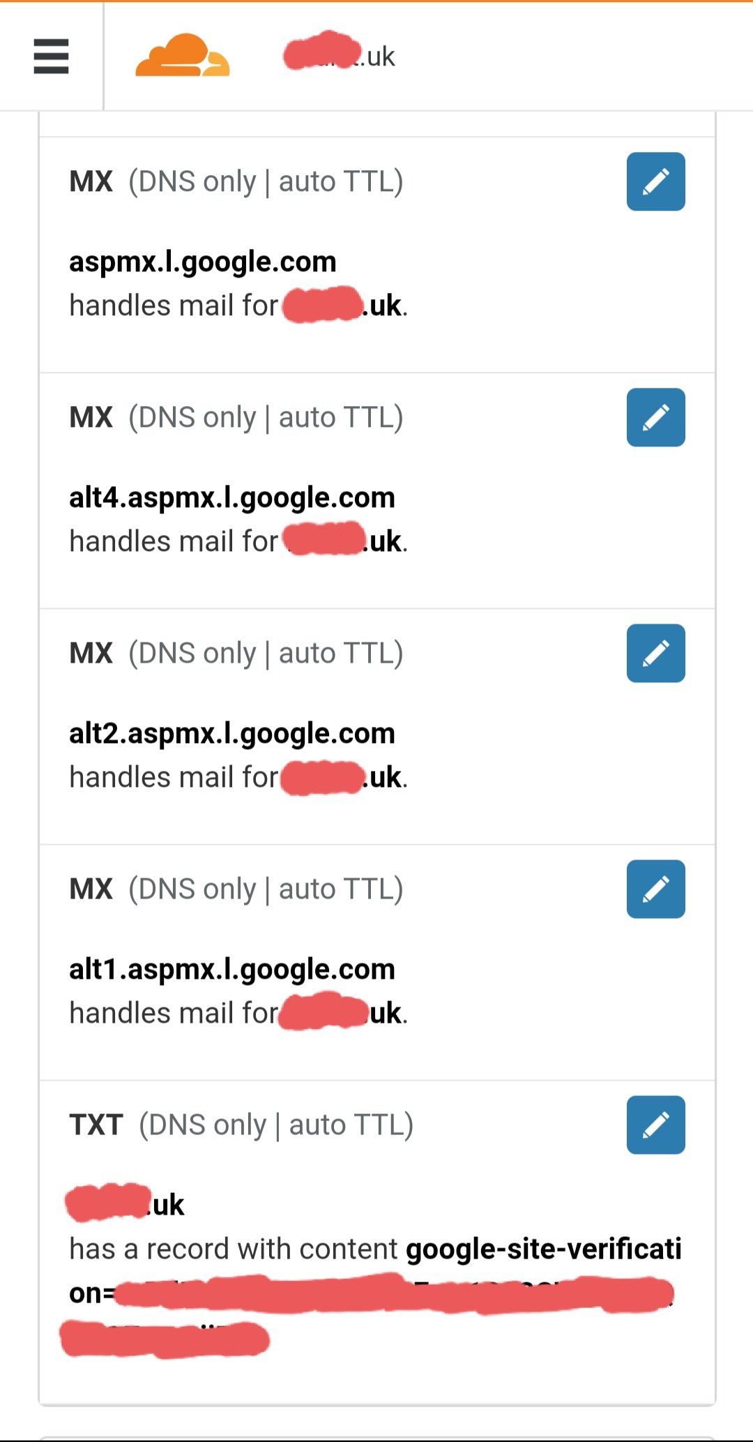

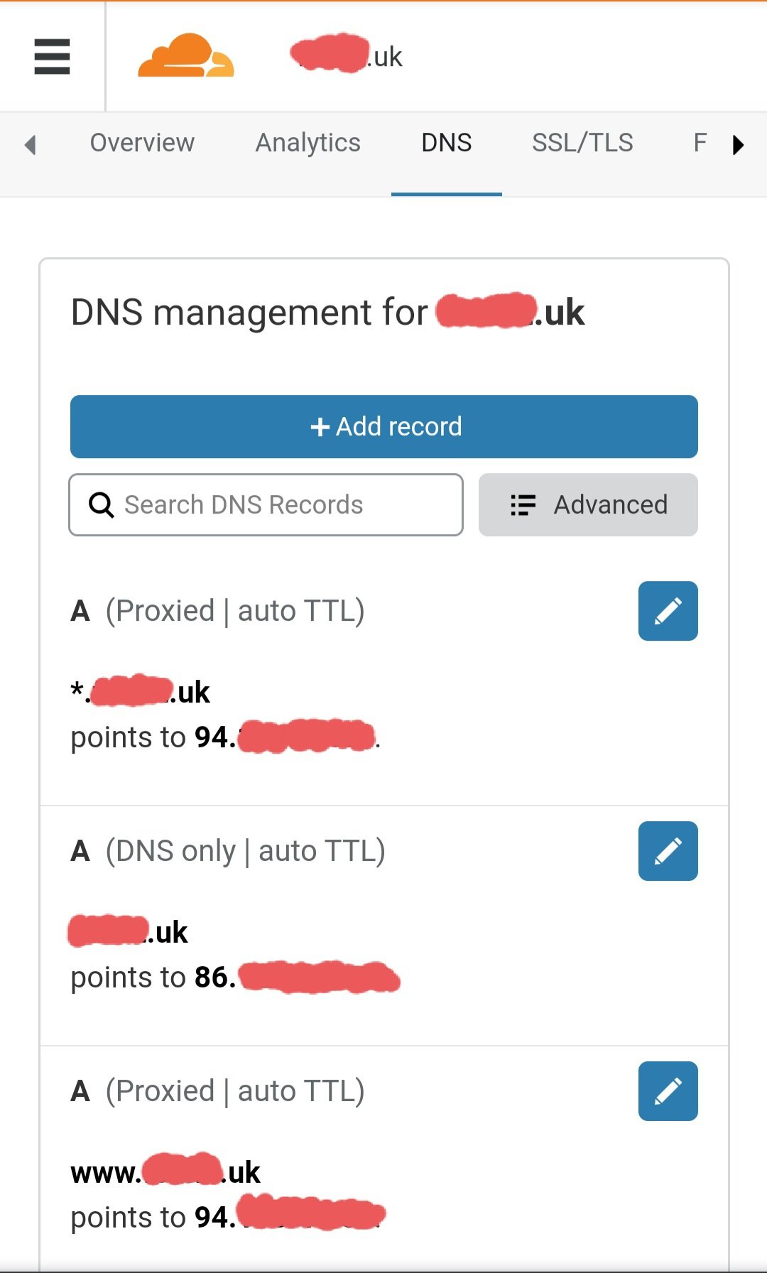

This is the issue. You need to change the Cloudfare Proxy status from "Proxied" to "DNS Only"
The WireGuard client can't connect through the Cloudfare Proxy, it needs to connect directly to your router's IP
Hello,
Many thanks for replying.

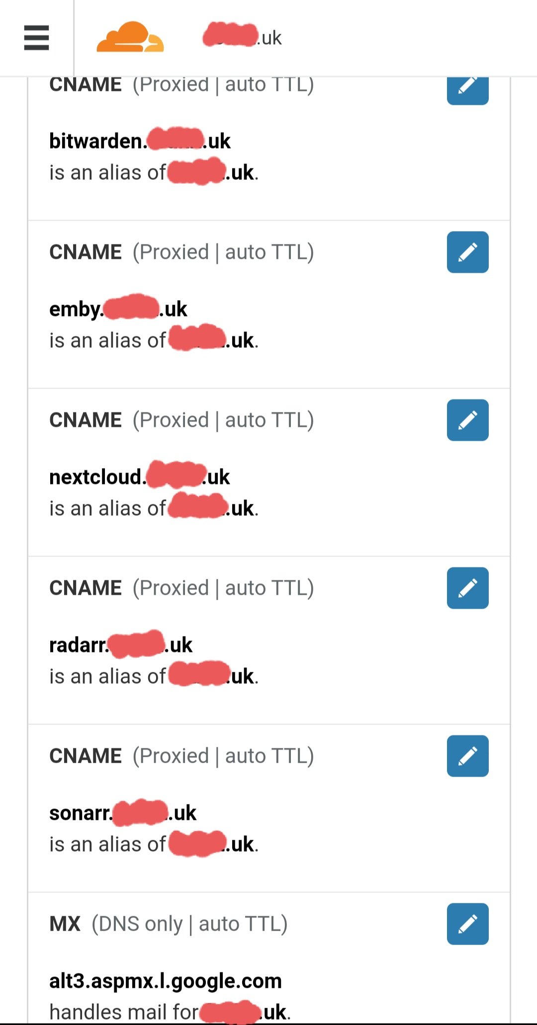

I have amended the proxy status to DNS Only as per your advice, for the A-record which points to my IP however it still does not connect. I feel as though I'm so close but it's just a simple entry amendment that's needed to get me over the line.
I've attached three screenshots below of all my Cloudflare entries. Any clarification would be greatly appreciated.
For reference, all of the CNAME entries point to apps via reverse proxy;
nextcloud.mydomain.uk
The A-record entry is formatted as;
mydomain.uk
Edited by LoneTraveler
Hello,
Further to my last, I have tried disabling proxy for all entries, however still no luck I'm afraid, when I enable Wireguard, no handshake takes places.
I think I must be missing another entry within Cloudflare.
***Edit***
I've managed to get it working. For anyone else having similar issues, it turns out I needed a dedicated subdomain, ie wireguard.mydomain.uk
As soon as I set that, and pointed the WireGuard configuration to wireguard.mydomain.uk:51820 everything clicked into place.
***2nd edit***
It looks like my impatience is the cause. @ljm42 was spot on, it was just the proxy that I needed to disable. I did this for just the A-record, however it turns out I wasn't giving it chance to take effect. Also, I can scrap the WireGuard subdomain.

Hi, i have a question regarding the remote access to server option.
On a windows client connected to my LAN i can see the files from the server under network in file explorer AND connect to the web GUI of the server using its local ip or name.
However, when connected via wireguard VPN with "remote access to server" I CANNOT find the files under network but i CAN connect to the web GUI by typing the IP provided by wireguard (10.253.0.1).
How do I access the files? I suspect it has to do with how the samba share is set up, but I dont know how it works.
I should mention that I can see the files from an Android phone using an app called network browser.
Any solution and maybe explanation of what is going on?

Is it normal, that (on the client) the public IP doesn't change, when connect to my home network? I have set the peer access mode to "Remote access to LAN".. From the client I can reach local services such as the Unraid Webinterface but if I check my internet IP it is still the one from my mobile network provider.. Confused..
And isn't it kind of dangerous putting a VPN Server on Unraid OS or is it encapsulated? At the moment I'm running a SoftEther VPN on Linux (Raspberry Pi) to which I connect via OpenVPN.
Edited by glockmane
"Remote access to LAN" uses split tunneling, so only the traffic destined for the LAN goes through the tunnel. If you want all traffic to go through the tunnel, use the "Remote tunneled access" option.
Anytime you open any port to any system there is some risk, but there isn't really any reason to think that WireGuard on Unraid is riskier than WireGuard on some other platform.  WireGuard itself compares quite favorably to other solutions, but that is probably something you would want to research yourself. Also, if you are happy with your current solution there is nothing that says you have to switch.
@ljm42
Interestingly it behaves the same with "Remote tunneled access", tried every option there, even rebooted server!
Regarding Security, what if there is a vulnerability in the wireguard server then in my understanding an attacker could get direct access to the unraid server while this could not happen, if wireguard runs on another machine.. Is this somewhat correct? I could use a TP-Link Router with OpenWRT for this, if this is considered the safer choice..
