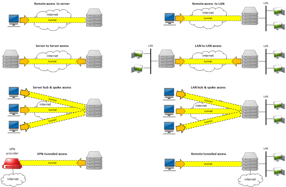

WireGuard is working on my server with all clients (phones and laptops) able to connect successfully, but I still see the port forwarding and peer networking LAN remarks on the WireGuard VPN settings page.
I'm super new to all of this so please excuse if I dont use proper terminology and my lack of understanding.
Currently I have Wireguard setup like the top left image in this picture, where I use the app to create a connection allowing me to remote in to my Unraid server. However, I would like to setup Wireguard in a different way, but have no idea how to go about it and am hoping you guys may can tell me what it will take.....
I want to have all of my internet traffic from all devices going through a VPN like the bottom left picture. I also want to be able to remote in but see ALL of my network instead of just the server....like the top right image.
My server motherboard (Asus x99 Deluxe II ) has two lan ports, so can I just change the cabling around to get my router behind the server? Currently it goes from cable modem to wifi router (which has lan ports) and the router feeds everything including wired to the server. Can I just go from cable modem to the server then out the other lan to the wifi router? That should effectly put everything  behind the server correct?  Would that be necessary? Really my server is the most important piece in the network and moving it in front of the router seems like it removes a layer of protection (but maybe not).  Also I'm not sure how it would work with issuing IP addresses and such since the router has been doing all that kind of work and the server would be in front of it.  Anyway, then I thought I would get a VPN that provides secure internet to ALL of the entire network, not just my server.
I just dont understand all this well enough to know if this would work, if its needed to change the cabling around, what kind of issues I may run into, how difficult it will be to setup and manage.....I cant have anything that is flakey and having issues because I go out of town a lot and no one else will understand any of it. Once setup it just needs to fade in the background and work.
Edited by SPOautos
If you want your entire network to route through a commercial VPN you should look at upgrading your router to support that.
If you would like to route your Unraid traffic through a VPN provider see this post:
If you would like to have remote access to your LAN while you are out of the house then follow the first few posts in this thread.
Note that some people are having difficulty getting access to their entire LAN, although it works for most. I'd recommend reading the last few pages of this thread.

I am just looking to be able to access the NAS when I am not home, but also dont want it to stop all my web browsing to have this benefit
I am not using and dont plan to use an extern VPN service. I just want a secure way for my unraid to be accessible remotely.
just seems odd that I can only do that if I sacrifice all other web related things
Keep working on it. There is no need for a VPN service. I can access my whole network with WireGuard through Unraid.
