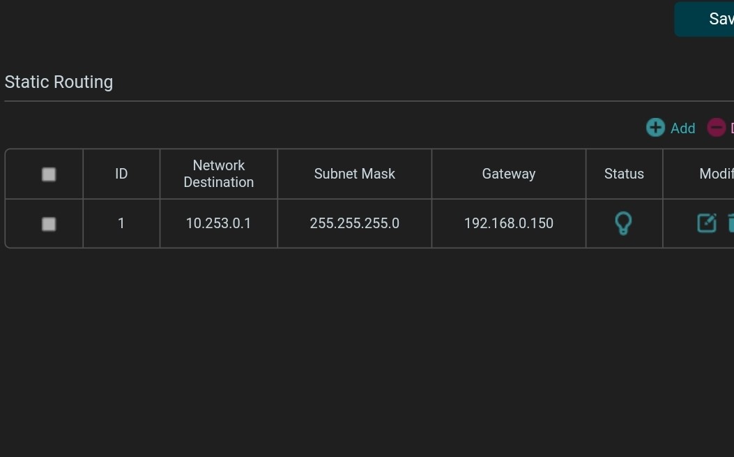

Can i have my settings checked please - Had to change router to setup static routing have been able to handshake and connect to unraid gui - but i am unable to access LAN

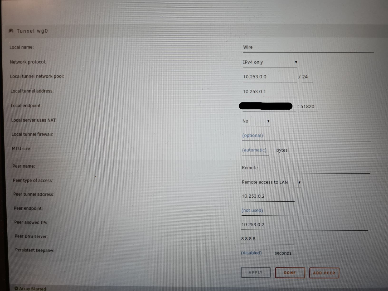

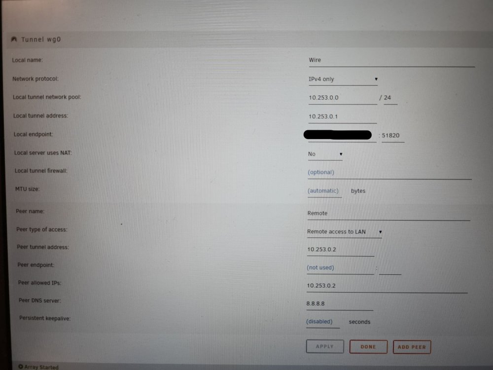

Hey! Thanks for the response.
Mine is set like this (I think it's default - not exactly sure I changed anything here)
I haven't updated to 6.9, should it work if I add the script in the /boot/config/go ?
Fingers crossed!

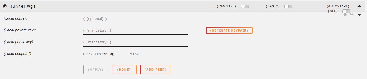

I think there is something wrong with my Wireguard plugin. Adding a 2nd Tunnel WG1 shows the fields all weird with underscores and any changes I make I cannot click the Apply button. Has anyone experienced this before?
What Unraid version?
It appears it is happening on both my unraid servers on Version: 6.8.3
Edited by remati
That’s why it’s happening.  (Not that it should though).   The problem should disappear if you upgrade to 6.9.2
