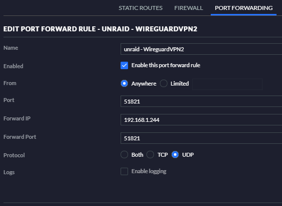

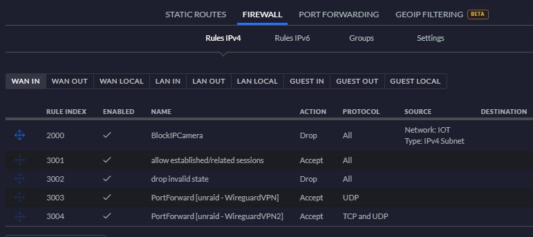

I have repeated all configuration changes for the new tunnel including adding static routes and port forwarding.
Static routes
Port forwarding overview
Detail of the new wg1 address, matches 51820
Resulting WAN in firewall
Any tips what I'm doing wrong?

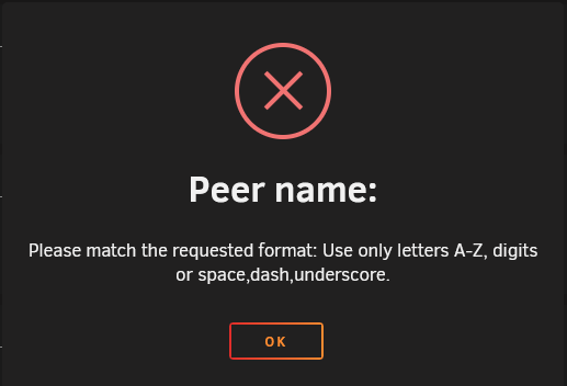

I cannot add a peer or modify an existing Wireguard peer.  Every time I try, the message below appears:
I wanted to change a particular peer from Access to Server to Access to LAN but it's a no go due to this message about the peer name.  I cannot make any changes to peers at all.
I am running 6.10 RC1 on this server.  Could it be related to that version in particular?
UPDATE:  It looks like I was able to change it on another computer (Chrome instead of Firefox).  I did not get this popup message and it let me make the change after correcting the error in another peer name.  Apparently, allowed characters in peer names have changed since I first set up the peers.  A peer I was not trying to change in any way contained an invalid character (an apostrophe) and was triggering the warning even though it had nothing to do with my attempt to add a new peer or change an existing peer.
Edited by Hoopster

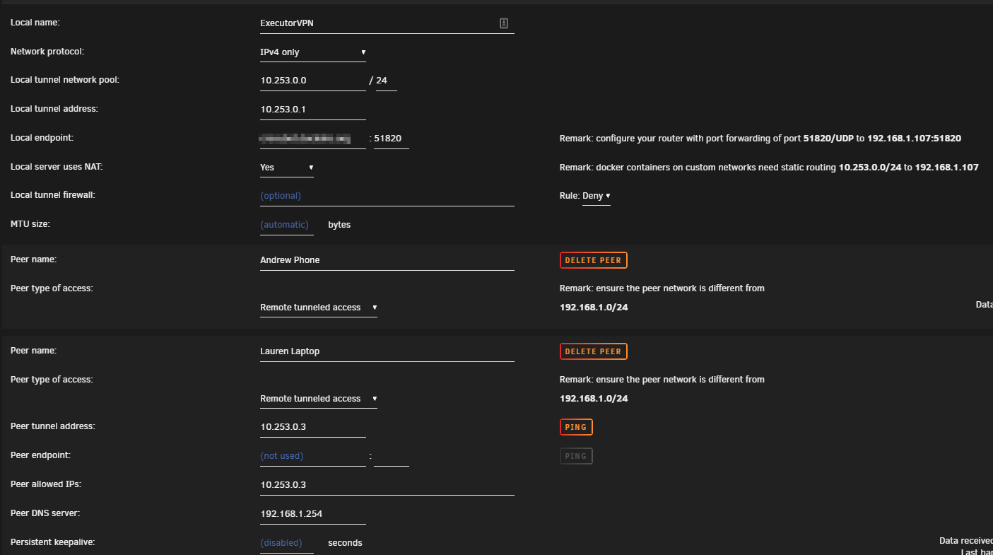

I’m having trouble successfully adding a second client.
I got everything functioning properly with a “remote tunnel access” setup for my phone following the directions for complex network setup. When I go to add an additional peer, the first peer no longer functions, even if they are not connected simultaneously.
I tried to work around this by setting up a second tunnel, each with one peer, but I seem to only be able to set one tunnel active at a time.
is there any way to successfully add the second peer?
Make sure that each peer has a unique peer tunnel address (this is normally all done automatically)

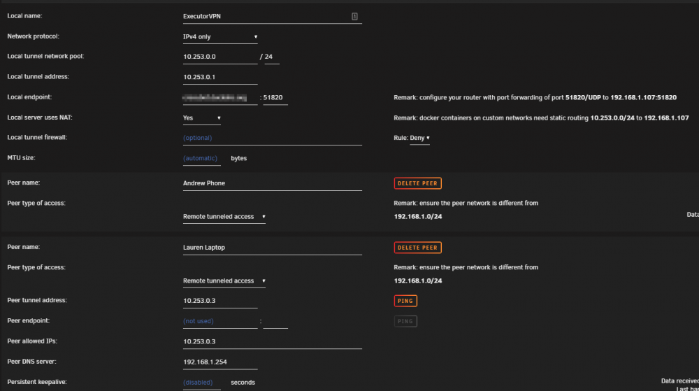

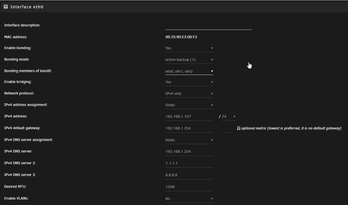

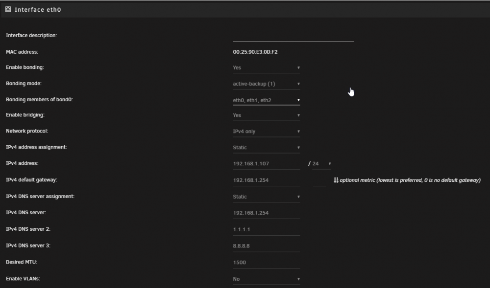

I've gone through the set-up and troubleshooting several times and still having issues with getting Remote Tunneled Access working correctly. Help, I'm stuck.
Symptoms:
  • Can connect to VPN but only able to access unraid (192.168.1.107)
  • No access to other LAN IPs. I know dockers with custom IPs wont work, but I can't even access IP cameras, other devices, router, etc.
  • No Access to Router (192.168.1.254).
  • No internet when using router ip as DNS. When adding a public dns like 1.1.1.1, I can access internet, but still no access to other LAN devices.
Troubleshooting
  • Tried connecting from different wifi network that is on different subnet (192.168.68.x)
  • Tried connecting from 5G cell network
  • Tried on both cell phone (wifi and 5g) and laptop (wifi)
  • Updated apps, updated vpn files/config
  • UDP port forwarded
  • Settings>Network Settings>Enable Bridging = Yes
  • Settings>Docker>Host Access to Custom Networks = Yes
I used to use OpenVPN and didnt have issues so I'm pretty sure my network setup isn't overly complicated. Attached images of VPN and Network settings for reference.
Symptoms:
Troubleshooting
