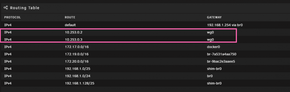

Not sure if this is normal or not, but when looking at the Unraid network settings Routing Table, the 2 VPN IPs (10.253.0.2 & 10.253.0.3) hace "wg0" as the gateway. Is that expected?

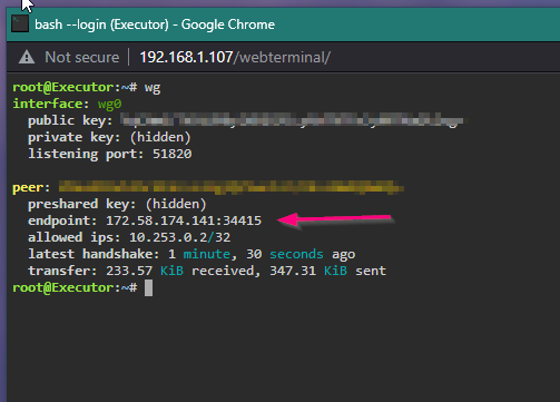

I ran the 'wg' command in unraid to ensure i was connected and I noticed that the peer endpoint (my phone connecting from 5G using duckdns) has a random port on the end of the ip. Is this expected? The server endpoint I set up is [mydomain].duckdns.org:51820.
These are both normal

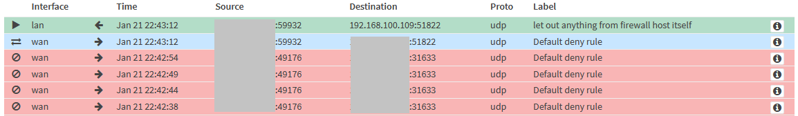

I have three servers in three different locations with each server talking to the other servers through Wireguard.  Everything works ok for a few days and then server2 and server3 no longer talk to each other.  In the screenshot below you can see that opnsense is denying the communication.  The red "deny" log entries are the failed attempts of server2 to talk to server3.  The thing is that Wireguard is configured to use port 51822 but it's using 31633.  If I disable the tunnel on server2, wait about 10 seconds, and then re-enable it the tunnel connects ok again using the proper port 51822 as you can see below with the blue and green log entries.
