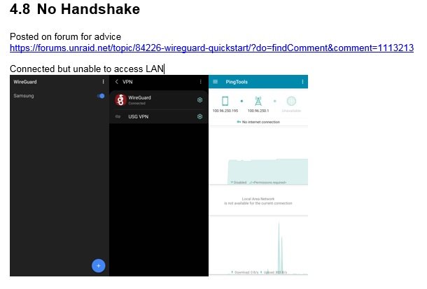

I can't remember what changes I made but it shows connected on android settings > VPN . Tried to ping the local IP but it's not connected. What am I doing wrongly?
For security, WireGuard fails silently, so there isn't much to go on if it doesn't work. All I can suggest is to go through the first two posts again. It really does work :)
Can you share to me the screenshot(s) when it it connected from Android? Do I need to use custom network (with NAT = off)?

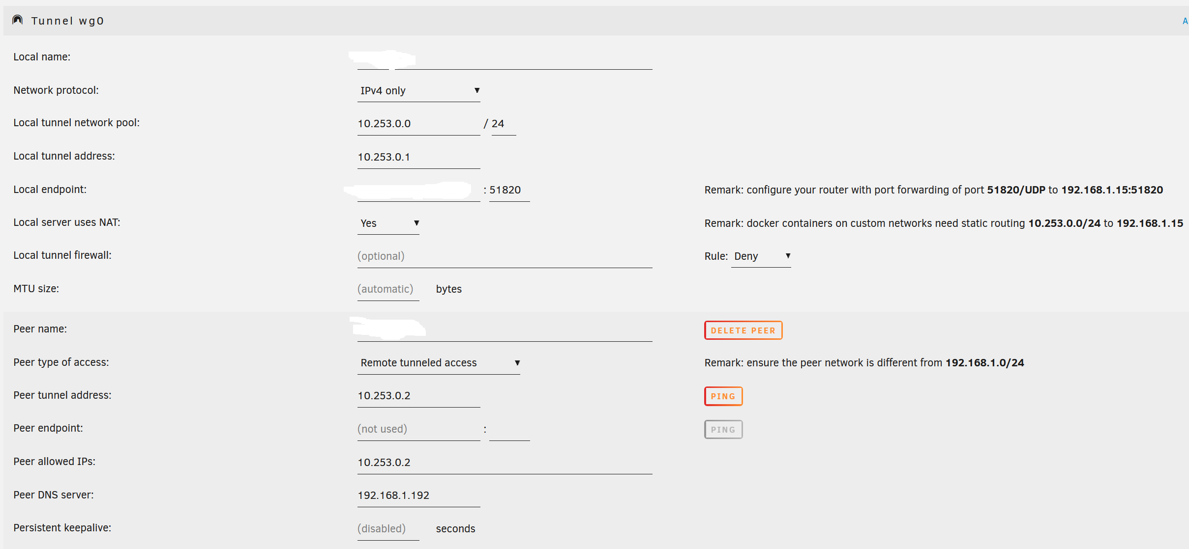

another one with no outside access.  I can ping the phone (android), i can access UNRAID, I can see netwprk drives using Samsung's files app.  But I cant get it to use the home internet connection despite having chosen "remote tunneled access".  On 6.9.2 if that matters.  I see lots of others recently with similar issues?
