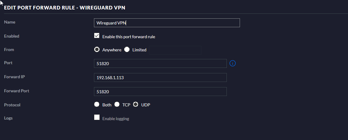

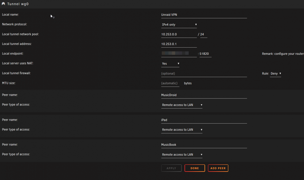

What port forwarding rule did you set on your router?
And what is your remote peer config look like?
Edited by bonienl
8 minutes ago, bonienl said:
WireGuard tunnel is up and running.
Above is the router config and as for the Remote Peer config I just scanned the QR code. It is no longer working on Windows, iPad and Google Pixel. I don't think it's the peer and I think it might have started acting up around the 6.8.2 update for Unraid.

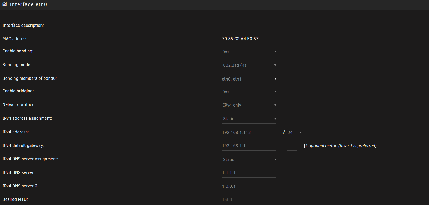

5 minutes ago, xorinzor said:
Do you have a static IP configured for your unraid server?
Are other ports on your unraid server reachable?
What if you enable the logging in your router for that port, does that give you any indications?
I use unraid 6.8.2 too, but it works fine for me.
Yes to Static IP in Unraid as per the pictures above.
Other ports (docker containers are reachable via letsencrypt docker/reverse proxy)
I am enabling logging on the router now, but other rules are working fine.

Honestly, I don't see this has been mentioned. But have you checked that the UDP port is opened?
