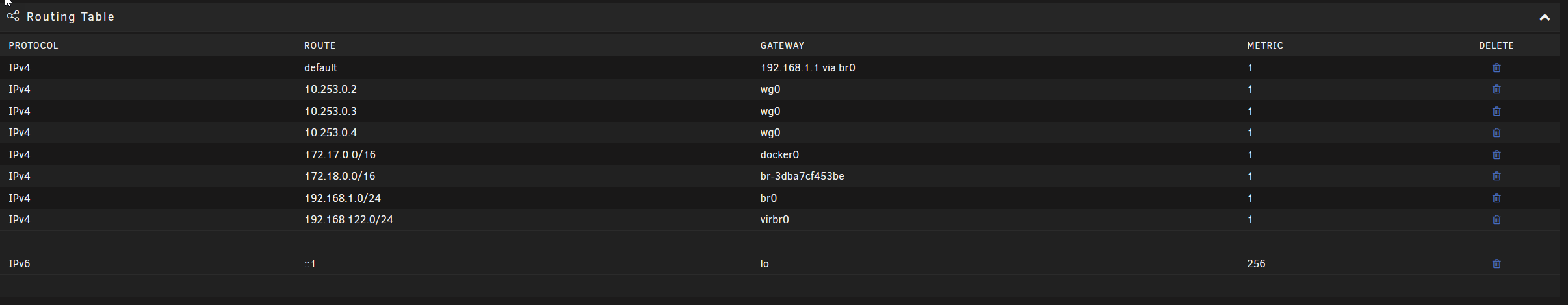

Router reboot did not solve the issue. I might just remove the Wireguard plugin completely and re-configure using the same keys.
Tried a different tunnel on a different port, removed the config and plugin completely and then reconfigured everything from scratch, still no go :(
can you connect from the local network to the server?
This would further narrow down if it's related to the port forwarding, or something else.
EDIT: Can you also put a screenshot of your routing table here? (viewable at /Settings/NetworkSettings)
