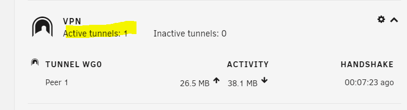

Any ideas why the dashboard widget is showing an active tunnel when I disconnect many minutes beforehand? Android client. I even dropped my device into airplane mode to be sure it wasn't still connected somehow. Is there a way to get it more accurate or poll connection status quicker?
Thanks in advance, everything else is working perfectly!
