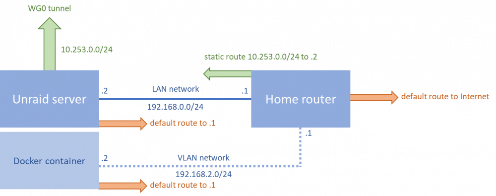

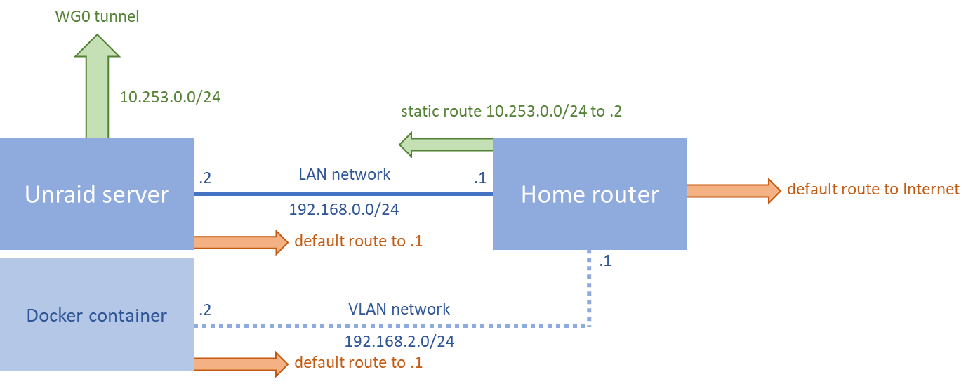

  • This is my scenario. @bonienl Please correct anything erroneous in this post.  I am not a networking expert and am explaining things according to my understanding with my functioning WireGuard, router
  • LAN hosts or docker containers/VMs with their own IP address, need a return path back to the WireGuard VPN tunnel which exists on the Unraid server to reach any remote destination.   This is

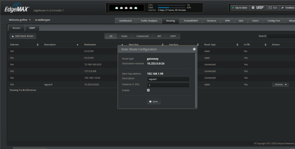

Could you elaborate on accessing VLANs?  I have everything setup for complex networks.  I can ping devices on different VLANs but I can't access their web gui's.  Not sure what other static route I can add.
The normal routing flow in the LAN network and the VLAN network is the default route towards the home router, which on its turn has a default route to go out on the Internet. This is a straightforward left-to-right path in the picture below and works for both the Unraid server and Docker container to go out on the Internet.
When a WireGuard tunnel is introduced, it resides on the Unraid server. The docker container in the VLAN network is unaware of this tunnel and don't know how to reach it, here the default route towards the home router is still followed.
The home router needs to know how to reach the WireGuard tunnel, by adding a static route of the tunnel network (10.253.0.0/24) and pointing to the Unraid server address (.2). With this static route in place the VLAN network has a route back to the WireGuard tunnel and this allows a remote device to access the container over the WireGuard tunnel.
There is one gotcha, both the WireGuard tunnel and Docker container reside on the same Unraid server, and docker by default does not allow a docker container in a custom network to talk to the host, hence it is required to enable the setting "Allow host access to custom network" to allow communication between container and tunnel.

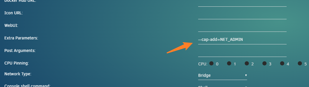

@JackieWu when I try and add the static route to my Shinobi container I get the following
ip: RTNETLINK answers: Operation not permitted
Ops, sorry, I forgot to say that before adding static route to container, you should add --cap-add=NET_ADMIN in Extra Parameters, because docker containers do not have full privileges by default.

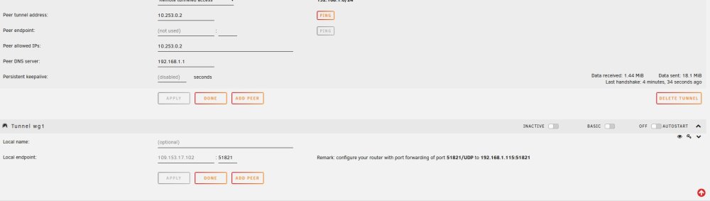

Hi guys,
I run 6.10 rc5. Is it possible to setup a wireguard server via webgui using a global /64 subnet instead of ULAs? My ISP assigns me a static /48 prefix so I see no reason to use ipv6 nat.
I am having a strange issue where i download the zip from the vpn interface in unraid, import that conf file into networkmanager on Arch Linux but the tunnel does not work. Anyone else have this? Yes i have wireguard-tools installed on Arch.

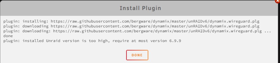

Hello,
Long story short - I had an error for my wireguard in the plugin error page and just a button to delete it .. which I did with the idea to re-install it again, but unfortunately now I have an error that my unraid version is too new (6.10.3) and I cannot find any other way to install it again. Any help will be highly appreciated. Thank you!
3 hours ago, GermanGramatikov said:
Hello,
WireGuard is fully built into the latest Unraid releases - no need any more to install a plugin.
Hello itimpi,
I know that people do not like to read long posts that is why I tried to write it as short as possible but let me try again:
  • My Wireguard stopped working
  • there was a new tab in plugins page called "Errors" (forgot to make screenshot it is already gone)
  • in it it said that wireguard has an issue and the only button available was "Delete" which I pressed
  • Now I don't have wiregurad and I cannot install it
  • Help please?
