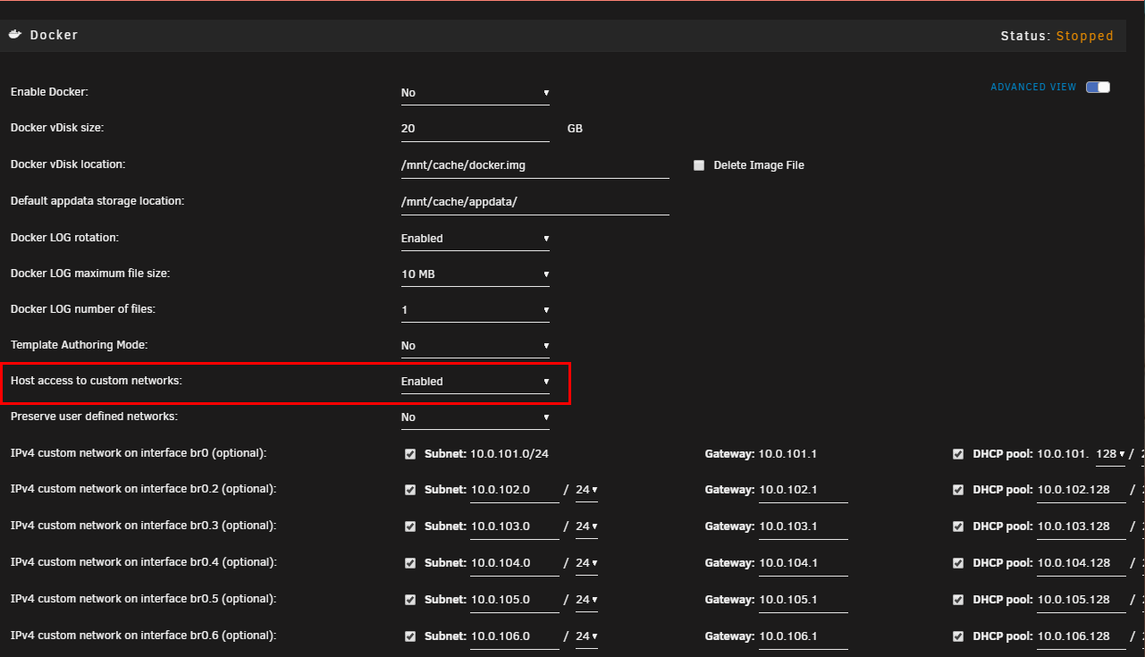

7 hours ago, bonienl said:
With Unraid containers may have either fixed addresses or dynamic addresses when used on a custom (macvlan) network.
To ensure that "any" container can be accessed by the host, I took the approach as described in the blog, and modified it to the needs for Unraid.
Instead of defining a subnet associated with the DHCP pool for containers, the complete macvlan subnet is split in two smaller subnets, e.g. a 1 x /24 becomes 2 x /25 and these subnets are used to set up a "shim" network which allows the host (Unraid) to access any container in the associated macvlan network.
To make use of this feature it is a simple matter of enabling it in the Docker settings page (new setting which defaults to "disabled").
Now I can ping the container "Pi-hole" with (fixed) address 10.0.101.100 on custom network br0
root@vesta:/# ping 10.0.101.100
PING 10.0.101.100 (10.0.101.100) 56(84) bytes of data.
64 bytes from 10.0.101.100: icmp_seq=1 ttl=64 time=0.096 ms
64 bytes from 10.0.101.100: icmp_seq=2 ttl=64 time=0.040 ms
64 bytes from 10.0.101.100: icmp_seq=3 ttl=64 time=0.032 ms
64 bytes from 10.0.101.100: icmp_seq=4 ttl=64 time=0.020 ms
And I can ping the container "Tautulli" with (dynamic) address 10.0.101.128 on custom network br0
root@vesta:/# ping 10.0.101.128
PING 10.0.101.128 (10.0.101.128) 56(84) bytes of data.
64 bytes from 10.0.101.128: icmp_seq=1 ttl=64 time=0.111 ms
64 bytes from 10.0.101.128: icmp_seq=2 ttl=64 time=0.032 ms
64 bytes from 10.0.101.128: icmp_seq=3 ttl=64 time=0.026 ms
64 bytes from 10.0.101.128: icmp_seq=4 ttl=64 time=0.024 ms
There is ONE CAVEAT ...
When remotely accessing a container on a custom network over a WireGuard tunnel, you MUST define a route on your router (gateway) which points back to the tunnel on the server. E.g. route 10.253.0.0/24 ==> 192.168.1.2 (Unraid server)
This is required because it is not possible to use NAT between a custom network and a WG tunnel, since everything is handled internally on the server and never leaves the physical interface, hence NAT is never in the picture here.

  • With Unraid containers may have either fixed addresses or dynamic addresses when used on a custom (macvlan) network. To ensure that "any" container can be accessed by the host, I took the approac
Is this only available in 6.8.1-rc1? Thanks

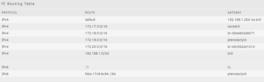

For the 3rd time now I can no longer start wireguard.
I deleted a peer. Hit apply, and now it will not start. There's no log output for wireguard anywhere, so it's impossible to troubleshoot. I know this is by design. The only thing in syslog is "Tunnel WireGuard-wg0 started" refreshing the page reveals that it is not running.
Before I delete ALL of my peers again and start over is there anyting I should be looking at?
I don't like having to resend a new config every time this happens. But that's usually what I end up having to do.
Edited by Xaero
Open a terminal window and type
wg-quick up wg0
This is assuming you want to start tunnel wg0. Check the output of the command above.

wg-quick up wg0
[#] ip link add wg0 type wireguard
[#] wg setconf wg0 /dev/fd/63
[#] ip -4 address add 10.253.0.1 dev wg0
[#] ip link set mtu 1420 up dev wg0
[#] ip -4 route add 10.253.0.6/32 dev wg0
[#] ip -4 route add 10.253.0.5/32 dev wg0
[#] ip -4 route add 10.253.0.4/32 dev wg0
[#] ip -4 route add 10.253.0.3/32 dev wg0
[#] ip -4 route add 10.253.0.2/32 dev wg0
[#] logger -t wireguard 'Tunnel WireGuard-wg0 started'
[#] iptables -t nat -A POSTROUTING -s 10.253.0.0/24 -o br0 -j MASQUERADE;iptables -N WIREGUARD_DROP_WG0;iptables -A WIREGUARD -o br0 -j WIREGUARD_DROP_WG0;iptables -A WIREGUARD_DROP_WG0 -s 10.253.0.0/24 -d 192.168.1.254 -j ACCEPT,iptables -A WIREGUARD_DROP_WG0 -s 10.253.0.0/24 -d 192.168.1.74 -j ACCEPT,iptables -A WIREGUARD_DROP_WG0 -s 10.253.0.0/24 -d 192.168.1.93 -j ACCEPT;iptables -A WIREGUARD_DROP_WG0 -s 10.253.0.0/24 -j DROP;iptables -A WIREGUARD_DROP_WG0 -j RETURN
iptables: Chain already exists.
[#] ip link delete dev wg0
It looks like the iptables chain is somehow already present?
Looking at network settings in the Routing Table I don't see it:image.thumb.png.ba5463822ea295498ba4c68f7ce54cd5.png
