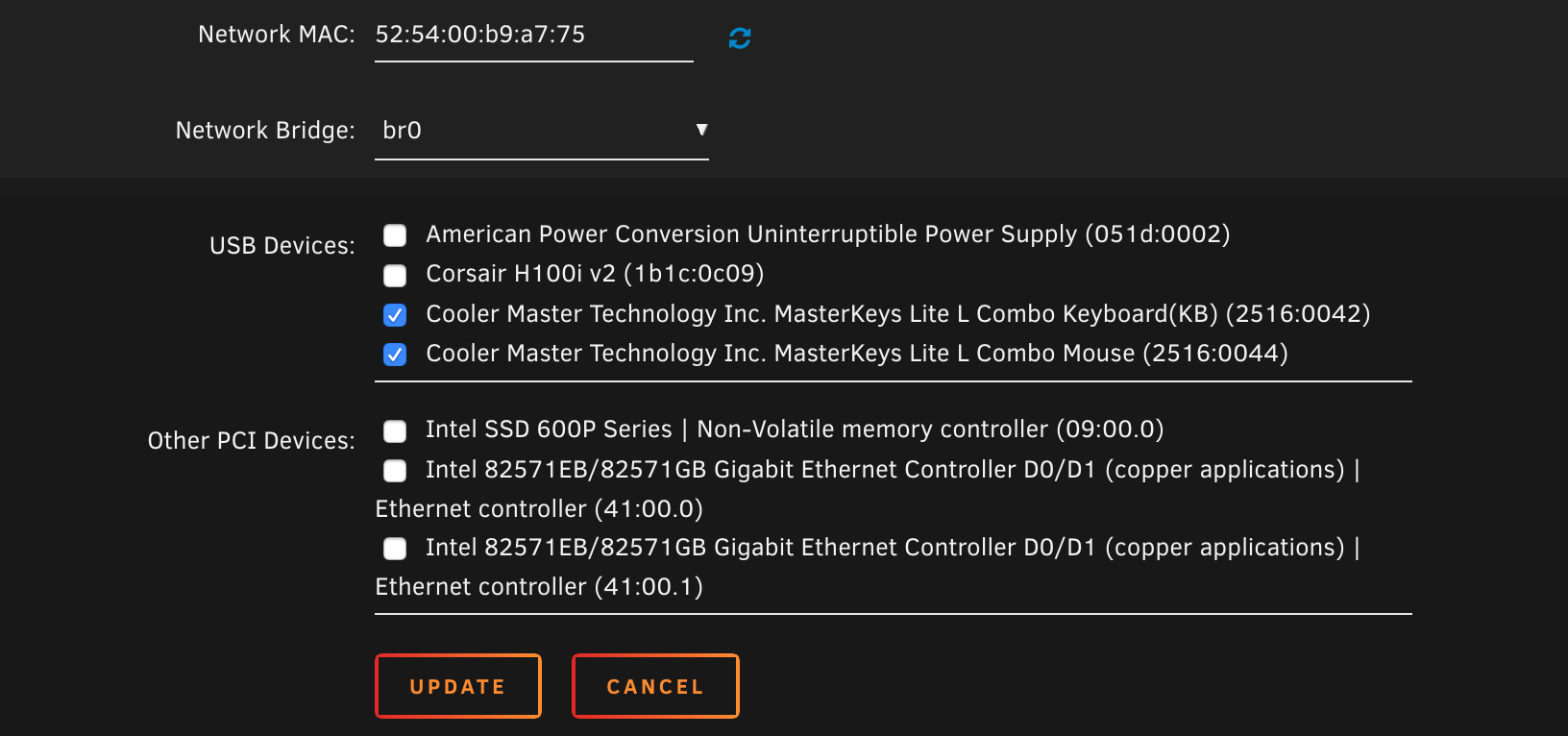

Regarding the keyboard - what should happen is it shows up like the attached and you can tick it on.  You can't tick it on though if another VM has it assigned AND it's running.  So check that.
If it doesn't show up, that's a concern.  If it does, you 'should' be able to tick it on.
Ignore the 'other PCI devices; section in this screenshot - that's what you can do when you stub a device to hide it from Unraid and show it to VM's.  You shouldn't have to ever do this for Network cards unless you're running a firewall or something (not recommended).  Or wanting to pass through a whole disk for a VM for speed - e.g. a gaming VM.

@Marshalleq once again thank you. The issue was simpler than expected. I just had to select USB controller 3.0 and it worked.
