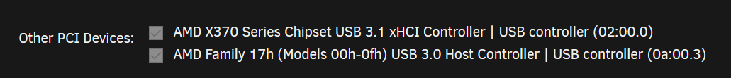

When I pass through the devices in the picture below I get the following messages in the logs. Everything still works with 6.7.2.
With the latest RC1 it doesn't work if the AMD X370 Series Chipset box is ticked but it does work with the other one ticked.
Any ideas how I might fix this?
2019-10-14T07:12:27.272542Z qemu-system-x86_64: vfio: Cannot reset device 0000:02:00.0, depends on group 16 which is not owned.
2019-10-14T07:12:27.280543Z qemu-system-x86_64: vfio: Cannot reset device 0000:08:00.1, depends on group 24 which is not owned.
2019-10-14T07:12:27.304594Z qemu-system-x86_64: vfio: Cannot reset device 0000:02:00.0, depends on group 16 which is not owned.
2019-10-14T07:13:04.437712Z qemu-system-x86_64: warning: guest updated active QH
