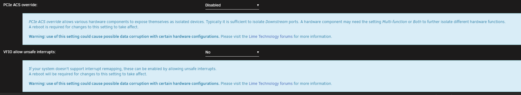

Not to minimize the effects here for you, but this is here on the VM Settings page (and presumably you did have to do one or both to passthru the iGPU).  YMMV

Switch to advanced view.  Are they currently disabled and set to No?

6 minutes ago, danull said:
Template
Settings - VM Manager
I'm just pointing out that unRaid does warn about the consequences of changing those settings under certain hardware combinations.  If yours are currently set to Disabled and No, then you've never changed them from the safe defaults.  Not trying to be argumentative or diminish the effects which you've noticed on your hardware.
Oh I see it is on the Settings->VM page not on the VMS page.
PCIE ACS override is disabled and VFIO allow unsafe interrupts is NO, which I imagine is the default.
PS - understand you're not being argumentative, just asking questions to narrow it down which I appreciate.   Just hoping this ends up helping somebody else in the future.   I'm fine with VNC, no chance of me ever trying GPU passthrough again after what I went through  ;-)
