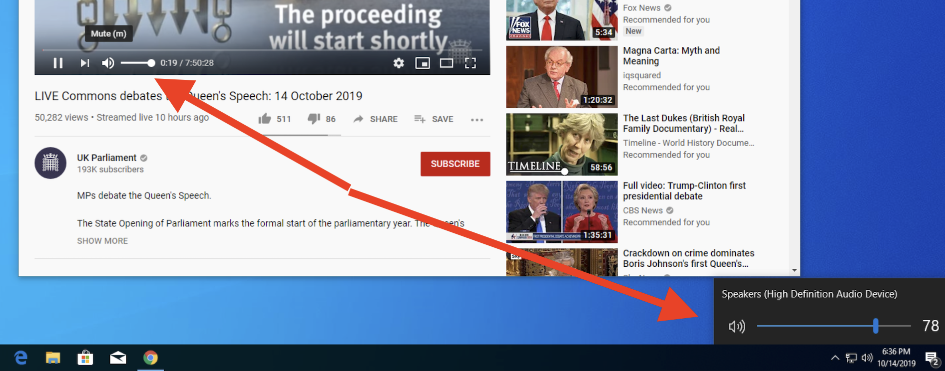

I installed my first WIN10 VM on unraid to day, it pretty much went as I would expect it to except the virtual sound.
I added the following to the xml of the VM
<sound model='ich9'>
</sound>
restarted win10, the red X on the audio went away, and the device manager shows no issues. but i have not sound.
Any Ideas on what I can check?
UPDATE (But not solved): If i use the Microsoft Remote Desktop app to connect to the VM, the sound works fine, just not when I use the built in VM VNC Viewer, is that normal? is there a setting I am missing?
