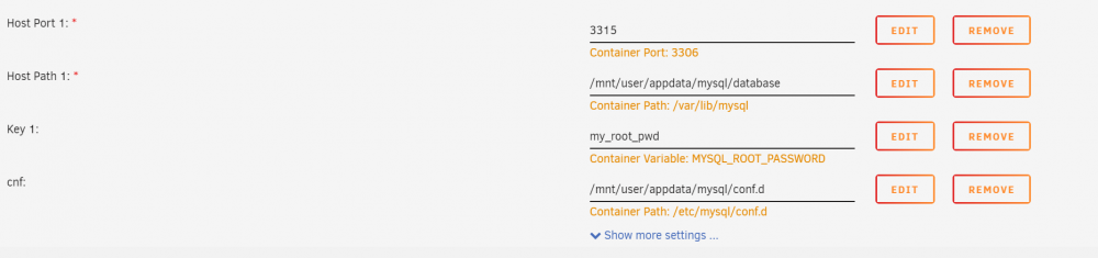

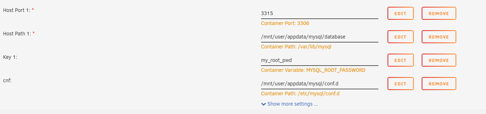

@Bigsease30, I got MediaWiki working with the official MySQL image, although I had to jump through some hoops to get there. It requires a modification to the default configuration for MySQL 8.0.4 and above. See MySQL 8.0.4 : New Default Authentication. I'll outline what I did.
  • Edit the MySQL template on UnRaid
  • Create a new text file in `/mnt/user/appdata/mysql/conf.d` and name it something.cnf
  • Edit the file and add the following:
    • [mysqld]
      default_authentication_plugin    = mysql_native_password
  • Change the file permissions, if global has write permission MySQL will ignore the file
    • Something like `chmod 644 something.cnf`
  • Start the container and wait for it to run through the Entrypoint.sh script (took a few minutes)
    • Check the container log and look for `[System] [MY-010931] [Server] /usr/sbin/mysqld: ready for connections. Version: '8.0.18' socket: '/var/run/mysqld/mysqld.sock' port: 3306 MySQL Community Server - GPL.`
    • Then it's ready
  • If you have already started the container before creating the configuration file
    • Stop the container
    • Remove all of the database files in `/mnt/user/appdata/mysql/database`
    • Restart the container
  • Then you can use the MediaWiki installer to connect and complete the installation

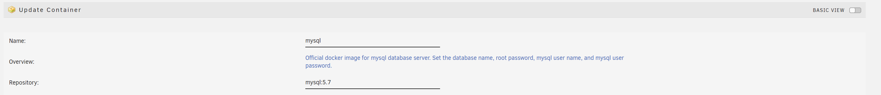

So, an alternative to all of that, use an older version of MySQL like 5.7 . MediaWiki currently supports MySQL 5.5.8+
Had no issues with MySQL 5.7
