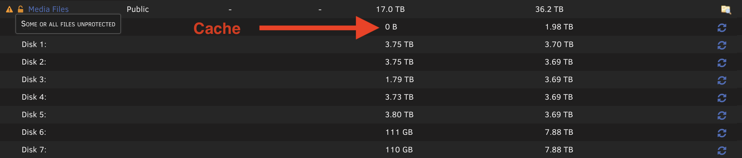

ORginally, I had this share's cache set to Yes, but quickly decided it was a bad idea as it used up all my cache during the transfer of all my data to the server.
I changed the setting to Cache->No. and it moved all my files to the Array, and stopped using it, BUT now I still show the share as "Unprotected and Unencrypted" I assume becasue a 0B Folder still exists on the cache.
Can I Delete it from the cache using "rm -rf /mnt/cache/Media\ Files/"   or is that a NO-NO
is there a better way to go about fixing this?

Theres still files for the share on the cache. Change it back to yes, run mover and after it's done then change it to no

Thank you, that worked perfectly!
