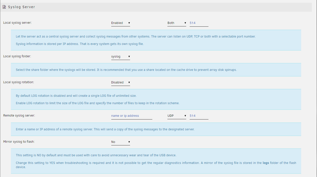

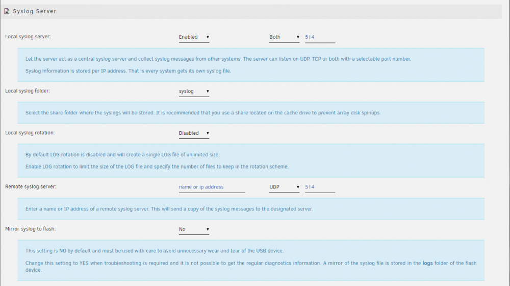

Look here (screen capture from Settings  >>  Syslog Server):
Set this to 'Yes' and it will write your syslog to the flash drive.  Turn on the 'Help' feature ( <<  ?   >> icon on the toolbar) for more information.  I would suggest that you pull the Flash Drive and get the file off before you reboot as I am not certain if this setting survives a reboot.

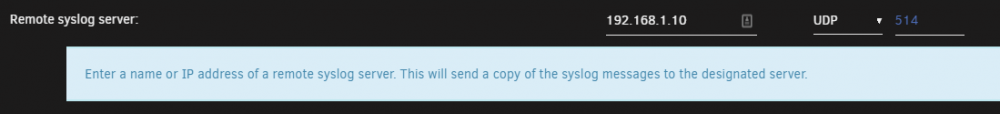

I've enabled a syslog server on my unraid box in appdata and set the "remote" syslog server to 127.0.0.1.  I'm hoping to store the syslog around reset issues I'm having which get lost from the ramdisk syslog.  I'm aware that any logging before the appdata share is active won't be in my syslog server but hoping it still should be in /var/logs (until it resets).
Goal is to use /var/log for boot problems and appdata logs for reset issues.  Does this make sense or have I missed something?  Thanks!
Remote should be the ip of your server.
