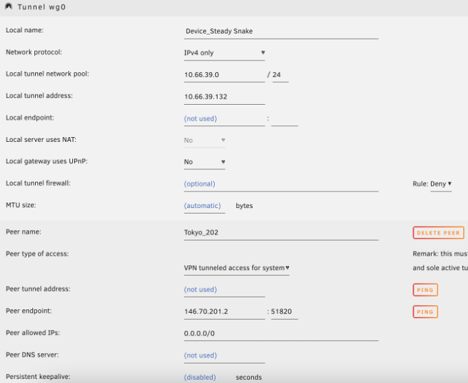

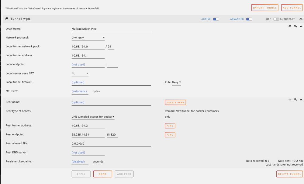

My VPN for tunneled access for dockers suddenly stopped working. I had shut down to add a new drive and decided to change up my VPN config to a new server, which I do occasionally just because. The new config loaded, I flipped the active switch, but I have no access on that network. It says Last Handshake: Not connected and it sends a few kb and nothing received. I tried testing with a Firefox container and nothing. Also tried pinging 8.8.8.8 in the console of the container and nothing. I can successfully ping the peer endpoint. Peer tunnel address fails.
Not sure if it matters, but I accidentally hit tunneled access for system when adding that new config. Could something there have made it go loopy?
I'm using IPv4 only. I tried creating new configs, different servers. I tried the config file for the server that was just working for me and nothing. I tried going into /host/config and deleting everything in wireguard. I tried adding a config for Proton VPN which also worked for me in the past and that doesn't work either. I tried flipping it on/off countless time. I tried rebooting a few times. The log seems to indicate the VPN starts with no other entries.
Nov 28 09:20:06 XXXXXX wireguard: Tunnel WireGuard-wg0 started
Nov 28 09:20:06 XXXXXX network: update services: 1s
Any suggestions or an approach to troubleshoot?

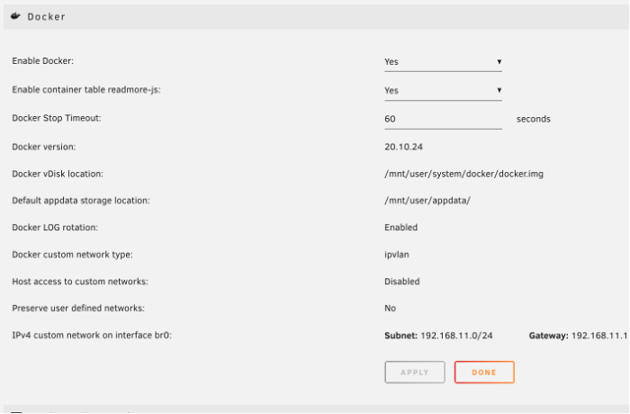

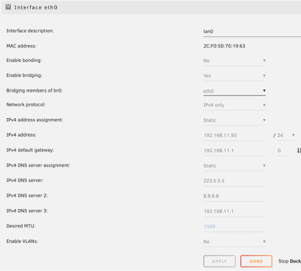

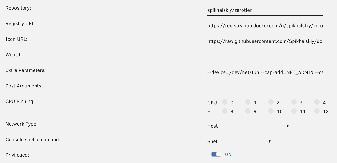

Hello Community
I have been unsuccessful in getting WireGuard to work since my upgrade from 6.11.3->6.12.6, and I am in need of guidance.
1.  I have been using ZeroTier for remote access into my server and docker UI and access to my network.  Don't really want to give that up.
2.  My goal is to have system VPN tunneling access for updates (I am behind the Chinese firewall and cannot get at Github for plugins w/o VPN.  Dockers updates are OK w/o VPN).
3.  I also want to have select docker containers (Sonar, etc) running over VPN (not Plex, as my experience is that the remote access for playback does not like a double NAT).
I have read through the guides, tried a number of different things, and the configuration below satisfies my goal of using ZeroTier (with complete access to server, dockers, file system) and Plex, but cannot get Wireguard working (No handshakes)

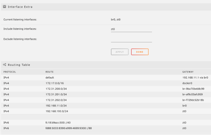

Note:  Need to reinstitute zt0 listening at any docker stop and start, even though is shows in “listening” in many cases.
("Host access to custom networks" breaks Zerotier,  as does using anything other than a HOST network setting in the Docker)

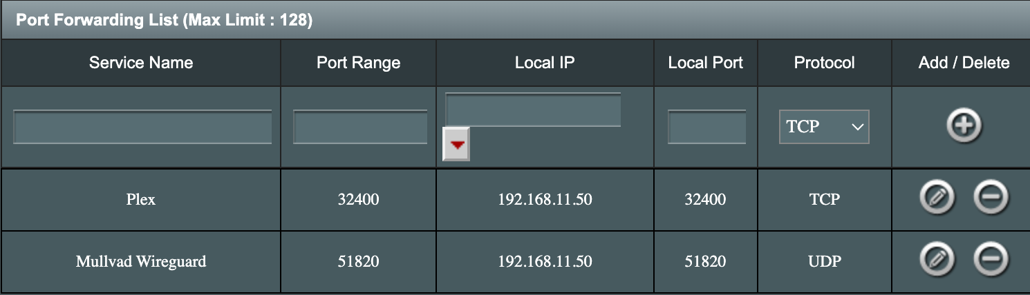

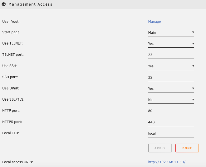

I have enabled UPnP both on the system and on my gateway router:

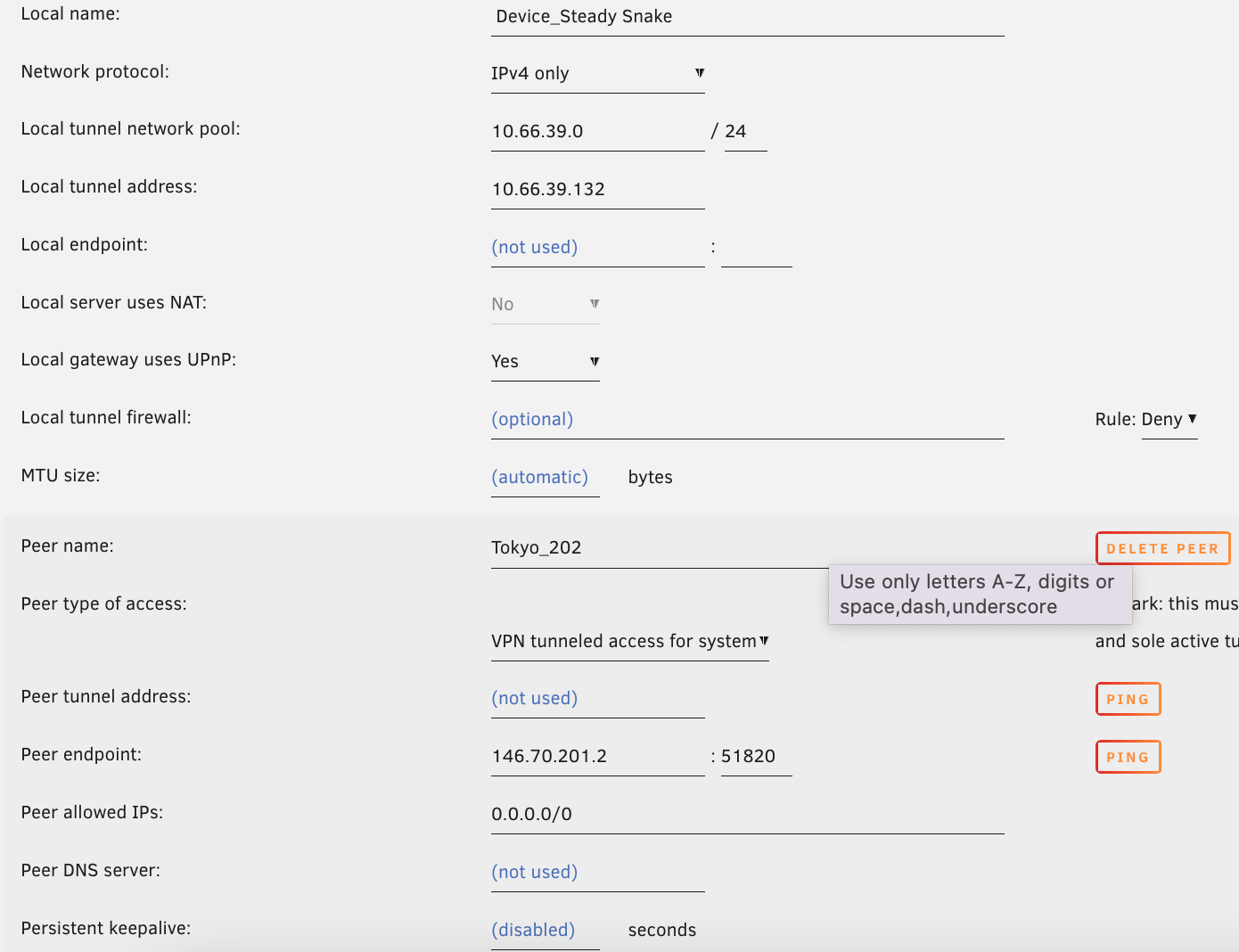

This is the VPN configuration:
Peer endpoint "ping" is working.
and clicking in the eyeball in with the "advanced" settings highlighted, I get this information:
WireGuard Configuration
Local server configuration
[Interface]
# Device_Steady Snake
PrivateKey=xxxx=
Address=10.66.39.132
PostUp=logger -t wireguard 'Tunnel WireGuard-wg3 started';/usr/local/emhttp/webGui/scripts/update_services
PostDown=logger -t wireguard 'Tunnel WireGuard-wg3 stopped';/usr/local/emhttp/webGui/scripts/update_services
PostUp=ip -4 route flush table 203
PostUp=ip -4 route add default via 10.66.39.132 dev wg3 table 203
PostUp=ip -4 route add 192.168.11.0/24 via 192.168.11.1 dev br0 table 203
PostDown=ip -4 route flush table 203
PostDown=ip -4 route add unreachable default table 203
PostDown=ip -4 route add 192.168.11.0/24 via 192.168.11.1 dev br0 table 203
[Peer]
#Tokyo 202_1
PublicKey=yyyy=
Endpoint=146.70.201.2:51820
AllowedIPs=0.0.0.0/0
Any guidance appreciated.
Thank you in advance.

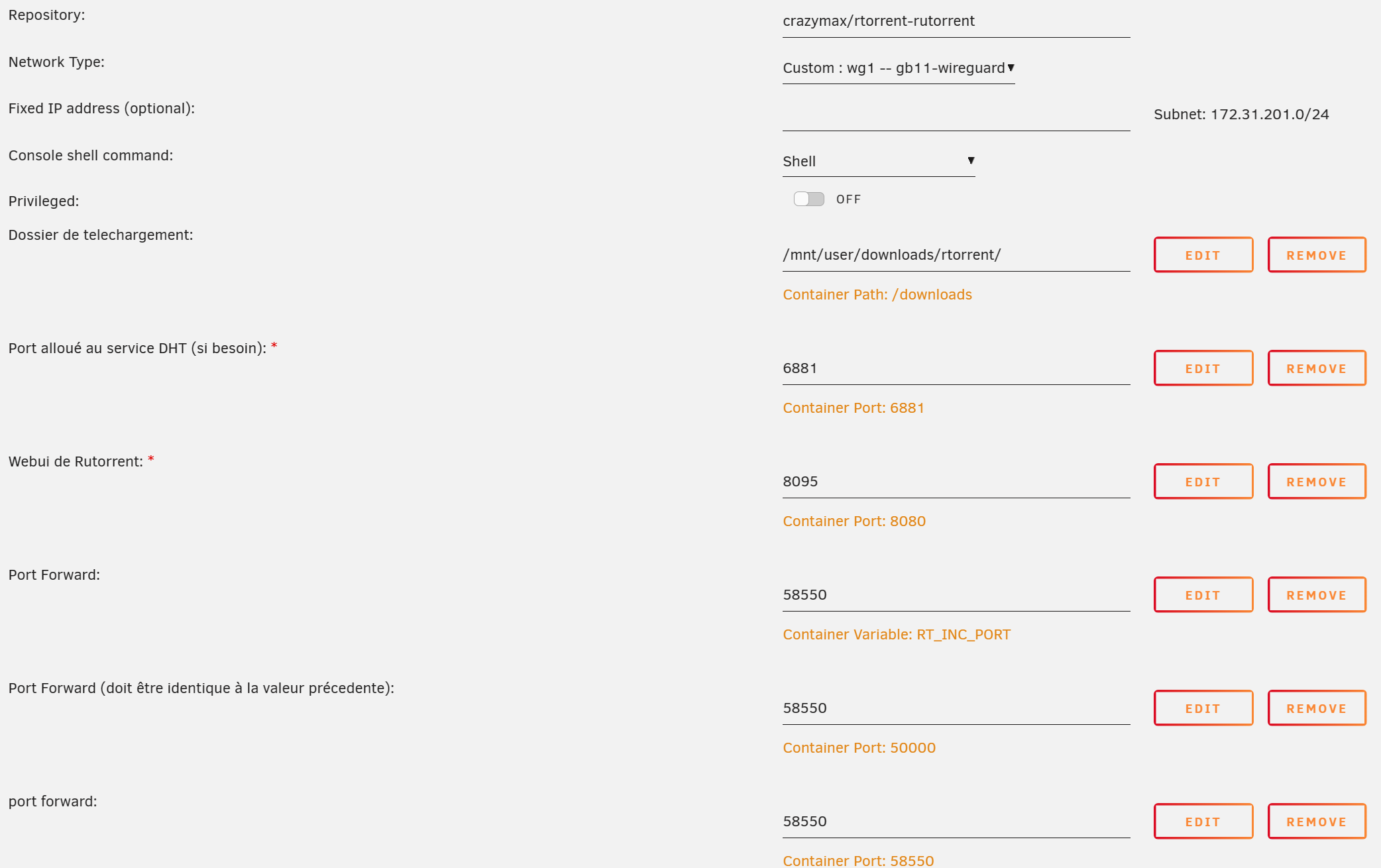

Does anyone know if port forwarding to rTorrent works when using VPN to Docker? Setup a WG connection to Mullvad with a port forward configured. However in ruTorrent the port is shown as closed. I have done a port mapping in the containers config but it seems unable to pass through the port.
Has anyone managed to successfully port forward using Unriads built in vpn manager?
Same question for me. Trying to get qBittorrent with OVPN and port forwarding to work, but the connection keeps beeing firewalled no matter what I do. Any input about this problem would be really nice :)
